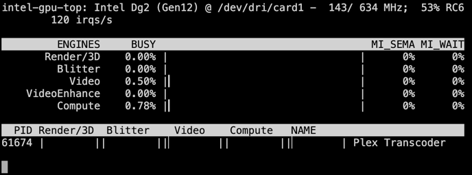

If you run intel_gpu_top it will show the pid.
Can you run php /usr/local/emhttp/plugins/gpustat/lib/Pidcheck 3459075 where the number is the PID and post the results.

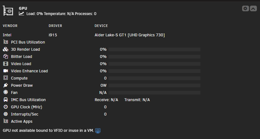

today i switched from an AMD Ryzen 5900X to an Intel i5-12400 with iGPU. I installed Intel GPU top and GPU statistics plugin. Unfortunately it doesn't show any GPU stats. Instead it says "GPU not available bound to VFIO or inuse in a VM."
This is strange because VMs are disabled and the GPU is NOT bound to VFIO
Any suggestions on how to further investigate this issue is greatly appreciated.
diagnostics-20250804-1009.zip
#EDIT
I ignored the message and used the iGPU in jellyfin. Seems to work. But I have to manually expand it on the Dashboard and after one second it automatically closes again. So for a brief second I see this:
... and one second later this:
So I guess it is just a displaying issue and nothing wrong with my unraid ;)
Try clearing cookies

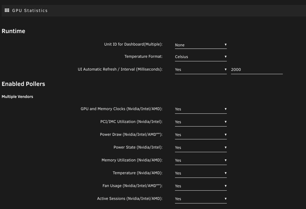

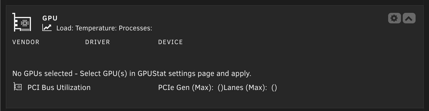

Is there anything special I need to do get my Intel Arc A310 to show up in gpu statistics? I was using a 2070 prior to this and the plugin worked fine. Intel-gpu-top shows my card correctly but gpu statistics doesn't list any cards at all in my system. The card also works fine in Jellyfin, Plex and tdarr. I've tried reinstalling Intel GPU Top and GPU Statistics but it still doesn't list any cards at all. I don't have anything being passed through to virtual machines on this server. Before I enabled rebar it could see the A310 but was unable to pull any stats from it "Vendor command returned unparseable data".

No cards listed under "Unit ID for Dashboard(Multiple):"? Need to select GPU there at least. I'm running an A310 myself with ReBar and things shows up in my dashboard.

Select your GPU in Unit ID, if on 6.12+ you can select multiple. + Apply

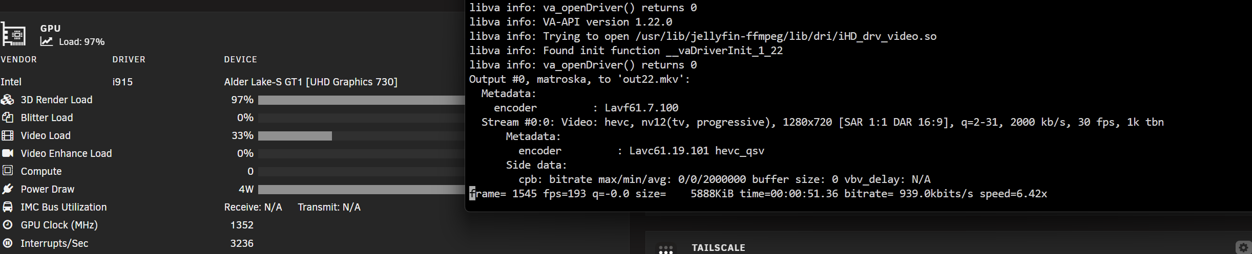

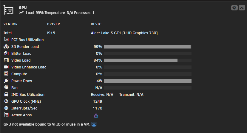

It still happens. No apparent reason. Using NVIDIA GTX 1660. It works fine for several days then it just stops out of the blue.
Vendor command returned unparseable data.
Strange but for me plugin never not worked .
For example if i run video in Immich it not show any data , also not in `intel-gpu-top` , only wattage is shown:

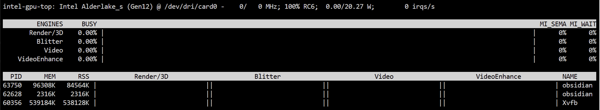

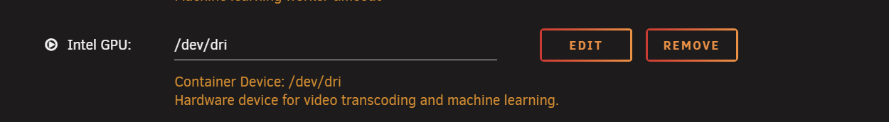

But still have nothing also in : intel-gpu-top
From Immich container :

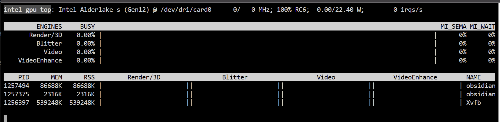

For each of the PIDs replacing pid with the number for top.
cat /proc/pid/cgroup and then inspect the docker based on the value returned.
I will try it. But seems immich only should show some load when transcoding...
All Fine, after made test load in Immich container :
