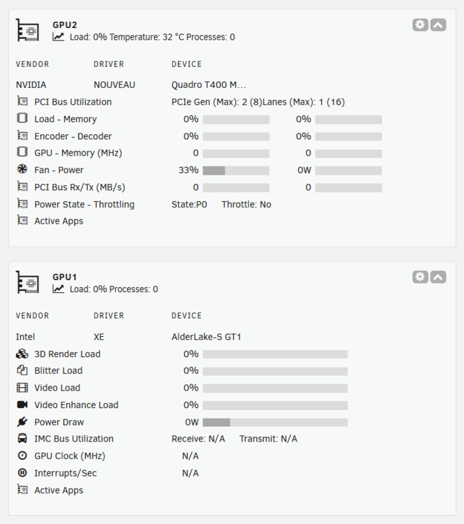

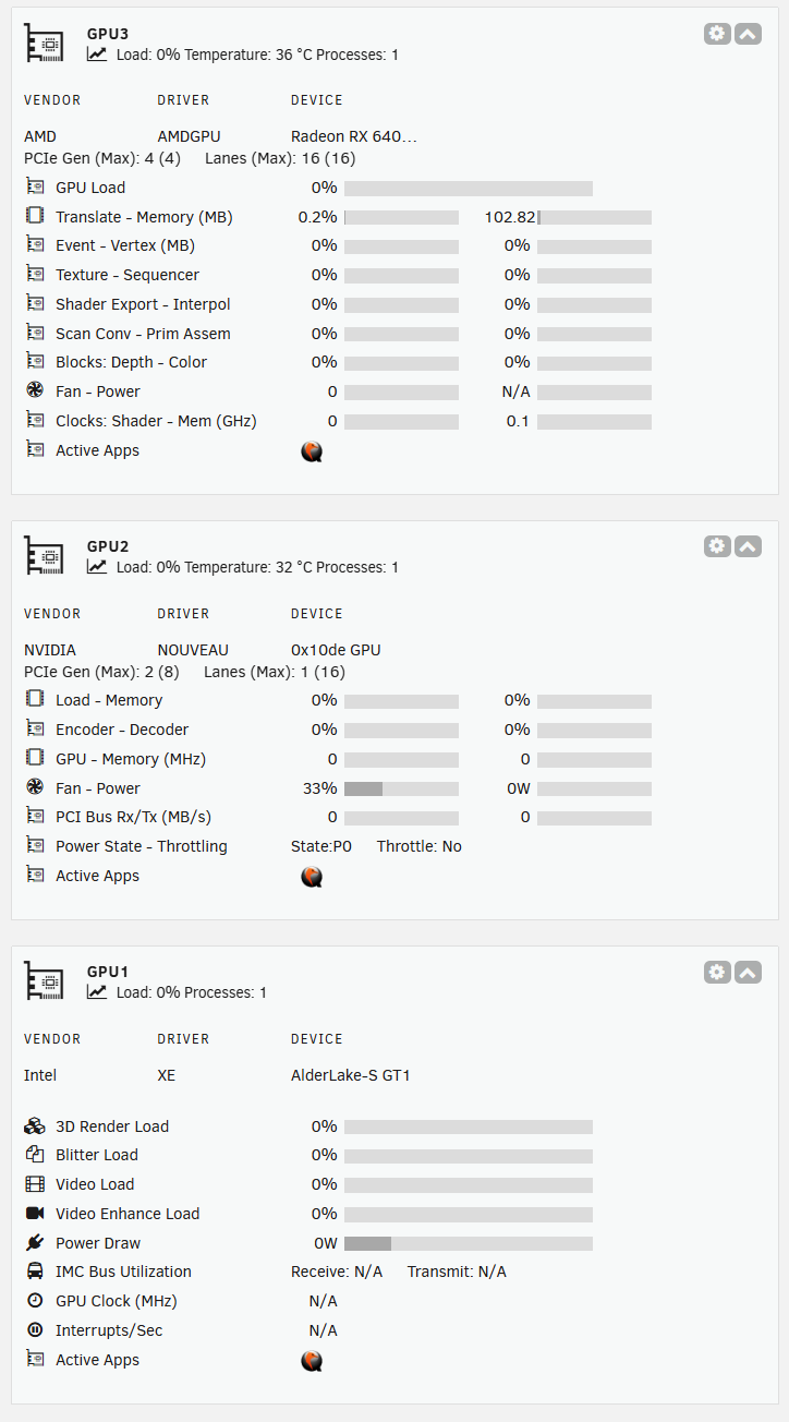

TESTERS Required

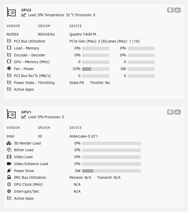

Looking for some testers. I have started building a framework for Nouveau and Intel XE drivers. Currently they dont expose much data but will show active apps, Currently Nouveau will be required for Virgl in 7.1 as still working on support for Nvidia Drivers.
Note old package will used after a reboot and you will need to install again.
I have added Driver to the panel as there are two drivers available XE/i915 for Intel and Nvidia and Nouveau for NV cards. I have included PCI bus for all dGPUs and it is currently hidden for iGPU.
I have tickets logged for dev teams to get metrics doc link but may take a while and be dependant on kernel updates.
To install but include the path you have placed the package.
root@computenode:/# installpkg gpustat-2025.03.09-x86_64.txz

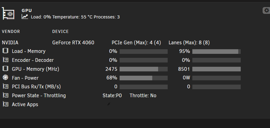

Hello,
Since a few weeks, the "Active Apps" section doesn't show anything when the GPU is being used.
It was working fine, but now doesn't. Is this something fixable?
GPU not being used:
GPU being used:
Thank you!

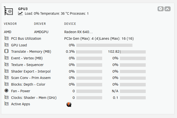

Any users running 6.12 or 7.0 with AMD GPUs
Looking to see results of tree /sys/kernel/debug/dri
Hopefully there should be a path with the PCI address of the card.
If there is can you provide me details for /sys/kernel/debug/dri/0000:06.00.0/clients change PCI I'd to match your card.
Ideally with apps running on the card.
###2025.03.11 Released
Add support for AMD Apps.
Add Initial support for XE and Nouveau drivers, metrics limited to apps, Temp and Fans.
Nouveau and XE will be more for 7.1 with new kernel, Nouveau for support of virgl3d as Nvidia drivers not supported at this time.
