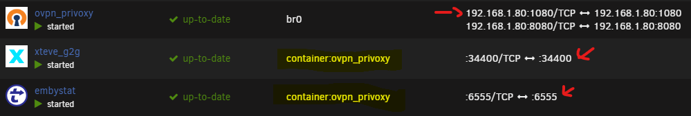

to 1.

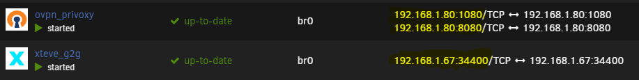

basic situation before bridged to VPN
ovpn_privoxy is my vpn docker connected to my vpn provider and providing as mentioned a http and socks proxy, xteve cant use this features.

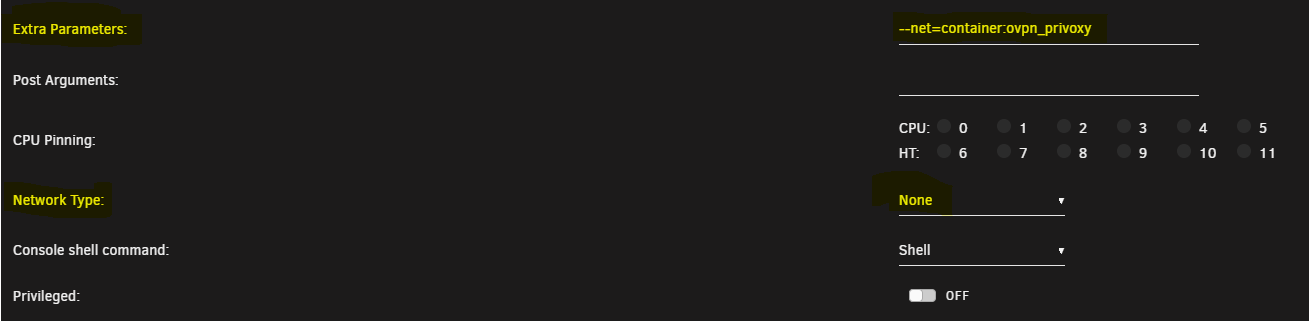

as mentioned, here my dockers are each on br0 with their own ip, now i ll bridge xteve to use the vpn docker
todo so, simply remove the network from xteve and add the following line in this usecase to extra parameters
--net=container:ovpn_privoxy

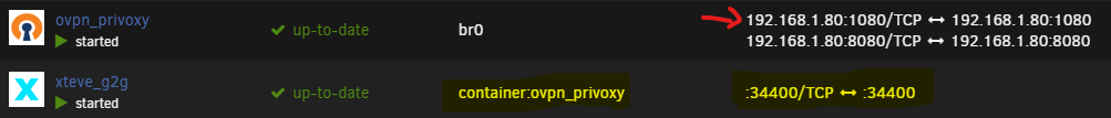

now xteve will use the network stack from the vpn container, will look like this
xteve docker now doesnt have a own ip anymore and using the container:ovpn_privoxy as network.
to reach xteve webui now u enter the ip from ovpn_privoxy and the port from the client app, http://192.168.1.80:34400/web in this usecase,
now the xteve external traffic will use the vpn connection from ovpn_privoxy, thats it here ;) thanks to limetech now ;)

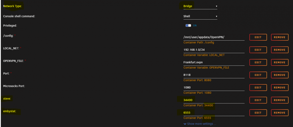

sample with a second working app
like above, ovpn_privoxy is the docker providing the network, now for a 2nd "client" docker, to reach the clients now
http://192.168.1.80:34400/web  <- xteve app
http://192.168.1.80:6555  <- emby app
of course is the http proxy (port 8080) and socks proxy (port 1080) also still available, has no influence ...
i hope this helps howto use the --net.... extra parameter

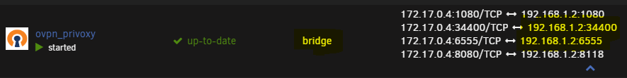

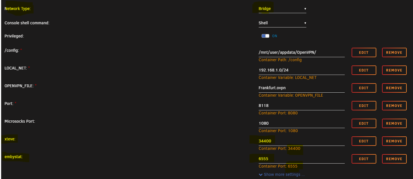

now, to 2. (VPN docker is running on host unraid in bridge mode)
only difference is now, u have to add the port mappings to the VPN docker, in this case i would add 34400:34400 and 6555:6555 to the VPN docker
would result here in this (my unraid server has the ip 192.168.1.2
thats the only difference when using the VPN docker in bridge mode, now your vpn and apps are all accessed via 192.168.1.2:.....
