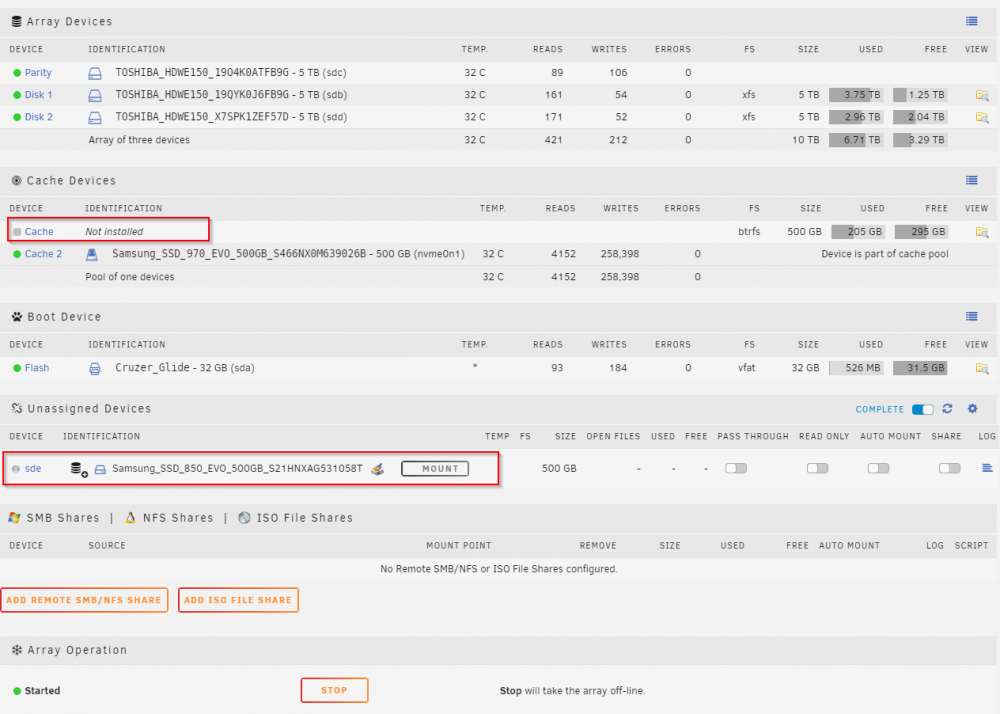

Here is the screen shot I took prior to moving disks around.
Here is where I am now.

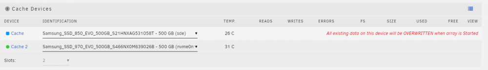

I have been reading around a bit (and searching) and sorry, just nervous...  I stopped the array, and at that point the option does show up where I can Select the 850 EVO disk as the Cache disk.  It throws up a red warning (in line with that disk) that it will erase all data.  It does not specifically say only on that disk though.  :)

I guess I would just like some confirmation here that i'm going about this the correct way.
Can I just start the array back up after adding the 850 EVO as Cache disk?  It will erase the data on that single disk, but not the Cache 2 disk?
Yes, it's saying "This device", which seems correct, but I am just trying to validate my thoughts here, before wiping out the Array, when that ended up being the device.  Thanks.

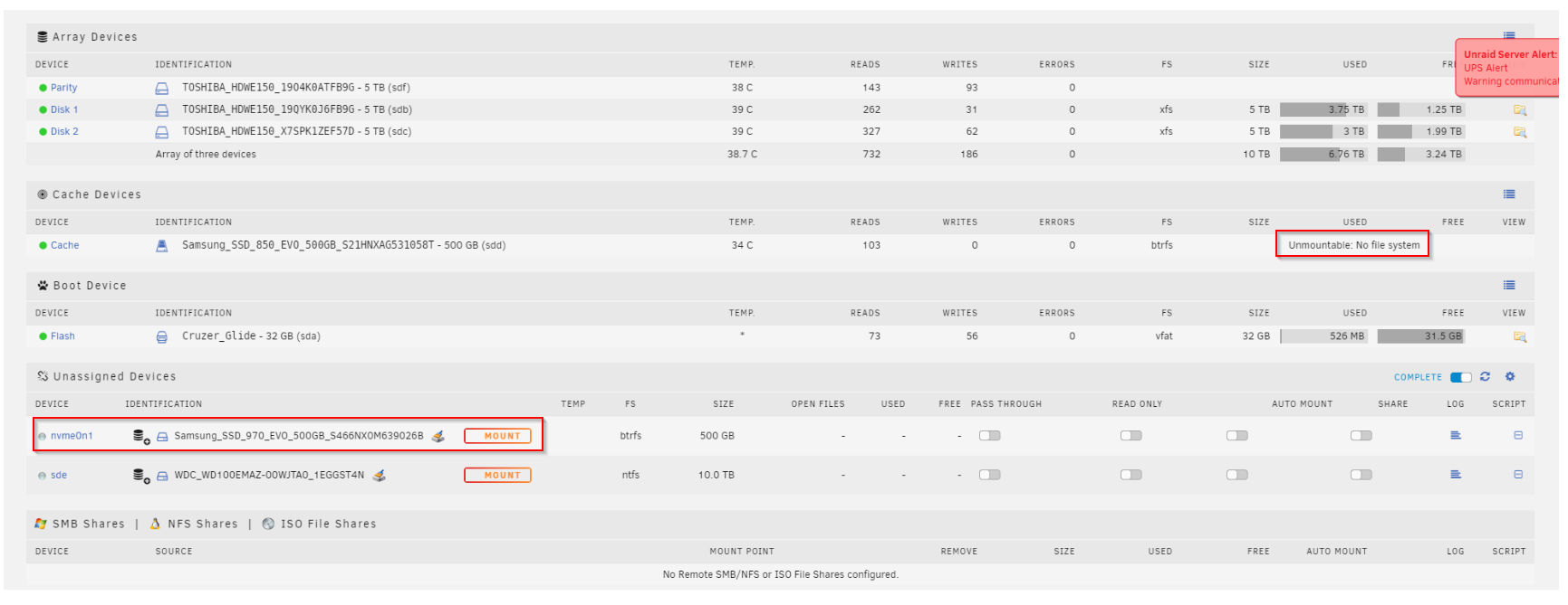

Now, when I start up it's not seeing that the M.2 drive (a 970 EVO) is part of the pool.  The SATA SSD (an 850 EVO) shows up in the pool properly.  ish.  So, it's essentially opposite as before.
The ish part, is that it says that there is no file system on the 850.  Which is puzzling.  How did that happen?  That just can't be accurate...  So, even if I were to follow the same procedure that worked before, now my file system is completely toast it seems.

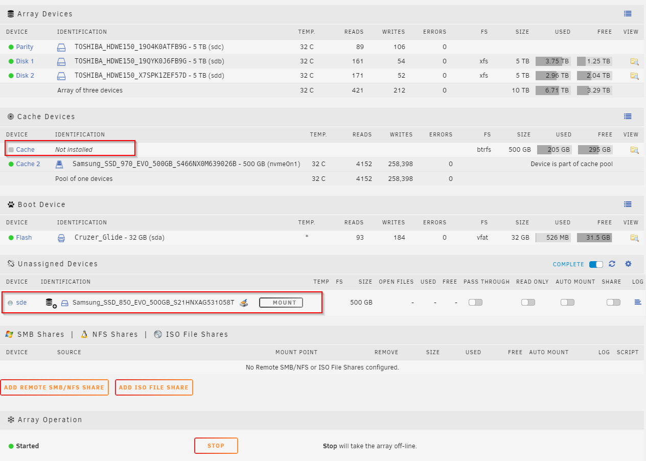

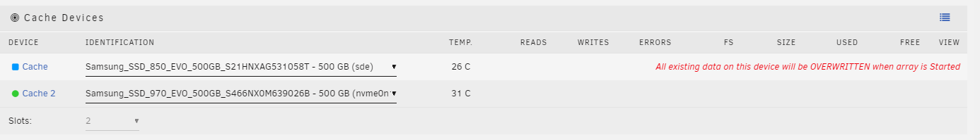

So, looking for guidance on this next step.  attaching a new pictures and diagnostic.unraid-diagnostics-20200317-1659.zip

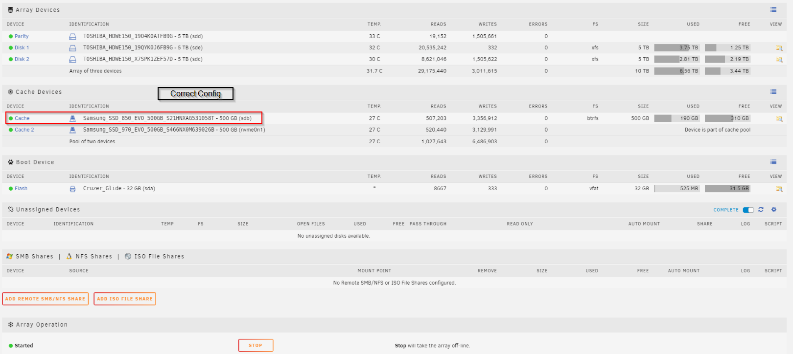

So, got data backed up.  Proceeding with recommendation of formatting and moving on with life.  I stop the array and before just formatting the 850, I decide I want the 970 to be Cache, and the 850 to be backup.  So, i re-order the disks and start the disk pool.  Fully expecting it to barf and say FORMAT.  Well, it didn't.  No warning of dataloss, nothing like that.  Poof, she just started up and pretended like nothing ever happened.  I is running a BTRFS operation, but the data is there.
