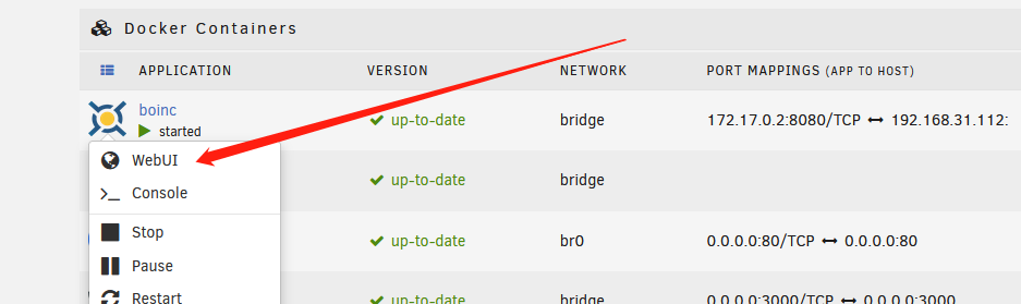

3 hours ago, Squid said:
Depending upon your point of view, the reason is that its either an error you made or an error LSIO made in the template.  To run it in bridge mode, you need to explicitly enter in a port in the entry that states WebGUI Port:8080 default
We have never ever made a mistake 😎
