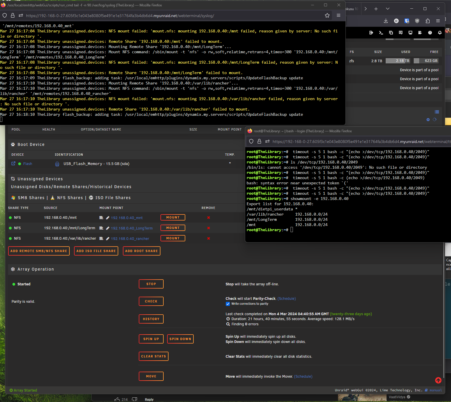

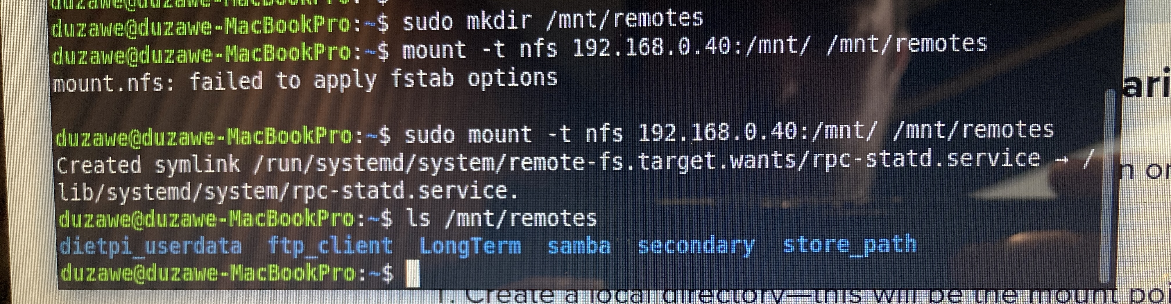

Is this mount there at /mnt/LongTerm?
there is indeed.
root@PiBox:/# ls /mnt/
dietpi_userdata  ftp_client  LongTerm  samba  secondary  store_path
there is also a /var/lib/rancher
root@PiBox:/# ls /var/lib/rancher
cross-seed-config  downloads  lost+found  qbit-config  qbit-manage-config  watchstate

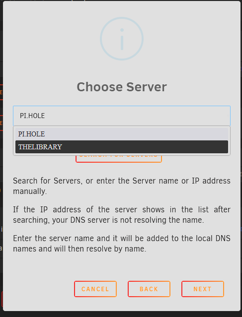

I would remove and readd the remote shares and verify that UD can see the server (Search For Servers) and the NFS share (Load Shares).  Use the server name UD finds and don't enter the IP address.

Finds and adds the share doesn't mount it and says the server is off line.

14 minutes ago, dlandon said:
I can get it to work on my Mint Laptop. But Unraid wont mount it.

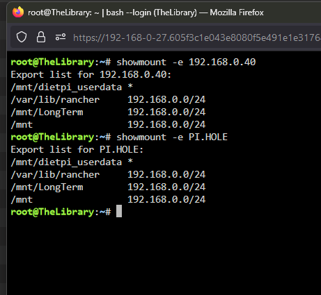

The "List Shares" for NFS shares uses showmount to list the NFS shares found on the server.  That's why it finds them.
The server status (online) has changed from being a ping on the server to a check if the port is open.  Your server needs to use the standard port (2049) for NFS.  Check that your server is using that port.
The reason you're just now seeing this is you probably updated UD and the OS at the same time.  This changed occurred in UD some time ago.
root@PiBox:/# rpcinfo -p | grep nfs
    100003    3   tcp   2049  nfs
    100003    4   tcp   2049  nfs
    100003    3   udp   2049  nfs
root@PiBox:/#
root@PiBox:/#
Give me the output of this command:
timeout -s 5 1 bash -c "(echo >/dev/tcp/IP/2049)"
change IP to the server IP address.
I get nothing from the unraid box
root@TheLibrary:~#  timeout -s 5 1 bash -c "(echo >/dev/tcp/192.168.0.40/2049)"
root@TheLibrary:~#
root@TheLibrary:~#
That indicates that the port is open.

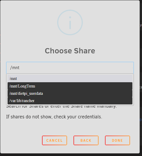

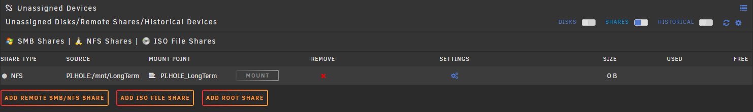

Show a screen shot of the UD page showing the remote shares.

Is this what you need?
The mount points you are trying to mount remotely are not Unraid shares and you are setting the export rules manually for those shares.  This is an Unraid share entry in the exports file:
"/mnt/user/isos" -fsid=105,async,no_subtree_check *(rw,sec=sys,insecure,anongid=100,anonuid=99,all_squash)
I suggest you take a look at this entry and compare to your entries and see if changes are needed.  I suspect a permissions issue that UD is having trouble with.  Check if 'all_squash' makes a difference.
As a test, share a normal Unraid share with NFS and try to mount that and see how it goes.
I fully understand that you can mount those with other systems.  The issue is that the UD NFS client is probably more restrictive about permissions.
