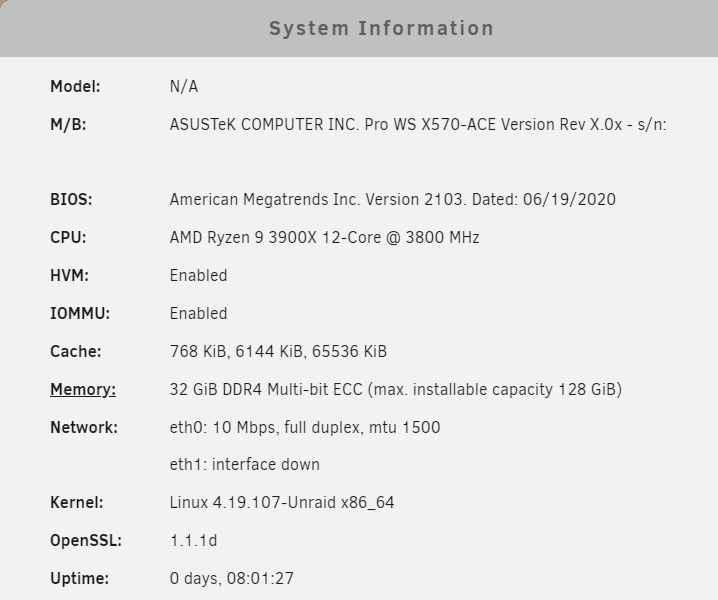

Actually looking at my dashboard.. the server has only been up less than 8 hours, but I have a lot of drops as shown in the picture
Found what I was talking about with the NIC (eth0). I did just switch network cables, but it didn't help. It seems to be an issue with the NIC for some reason.
Edited by bkastner

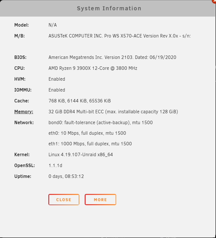

Okay... so I brought the other NIC up and bonded them to test... network speeds are definitely better and I don't have the stuttering, but it does show eth0 as 10Mbps and eth1 as 1000 Mbps... no idea why, and I am open to any suggestions to help.
I know other's have used the same MB, so not sure why I am having difficulties.
Okay... last comment before bed. It seems my issue is the Realtek RTL8117 NIC, which had been assigned as eth0. I've broken the bond, switched NICs so the Intel I211-AT NIC is eth0 and disabled the Realtek NIC and network performance (at least locally) is normal again. I also don't get any drop errors anymore.
Is there a known issue with the RTL8117? Or is it unique to me? I am hoping to get a 10GB NIC down the road so both on-board NICs will likely be turned off eventually, but I'd be curious to know if the issue is just my MB for some reason.
Hopefully everyone's Plex experience is back to normal and I can let this lie.
