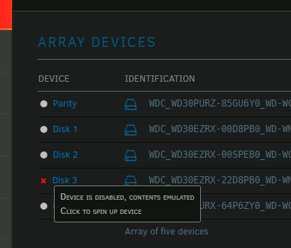

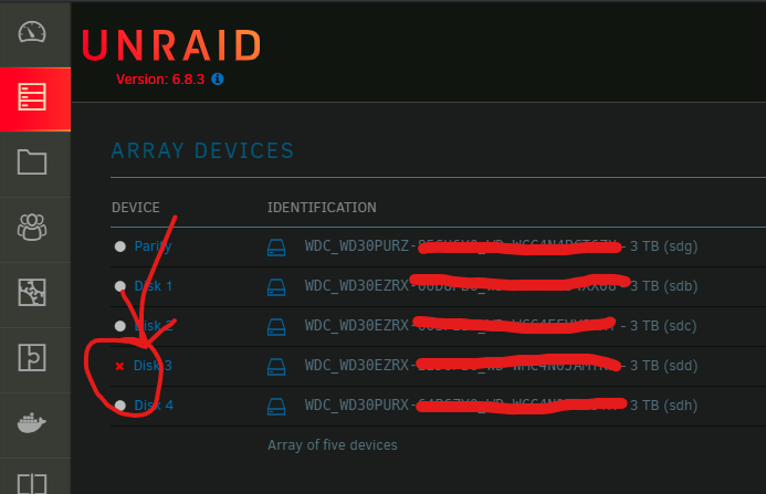

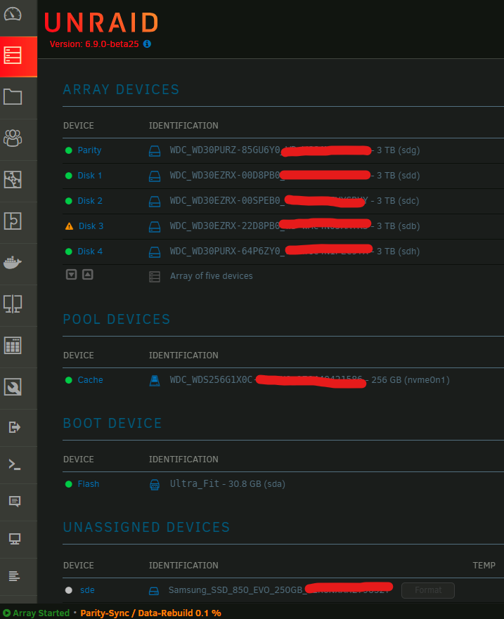

I have a problem with one of the HDDs.
I noticed an "x"  on the disk (photo)
I don't know what happened, can you help me diagnose the problem?

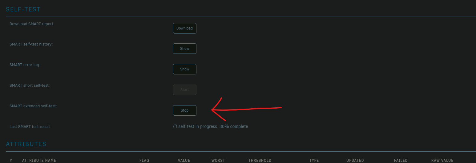

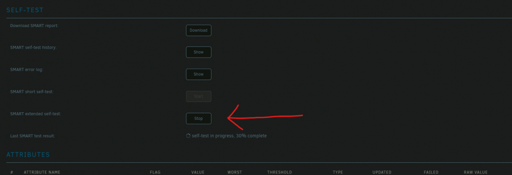

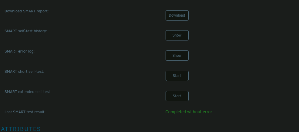

I'm doing this test, but it will take a few hours - SMART extended self-test
Of course, the SMART extended self-test did very well. (this test lasted several hours)

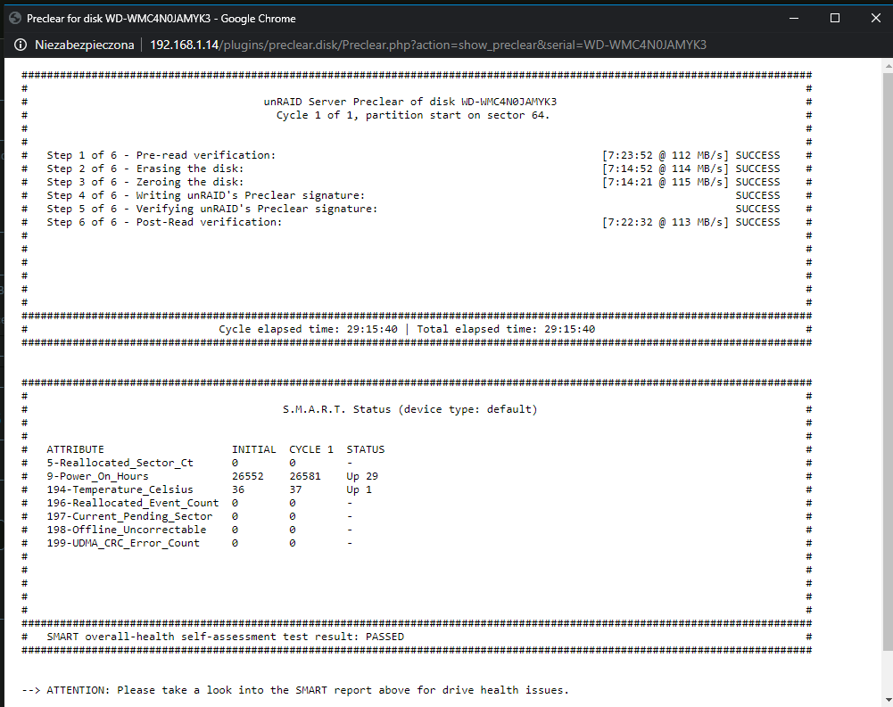

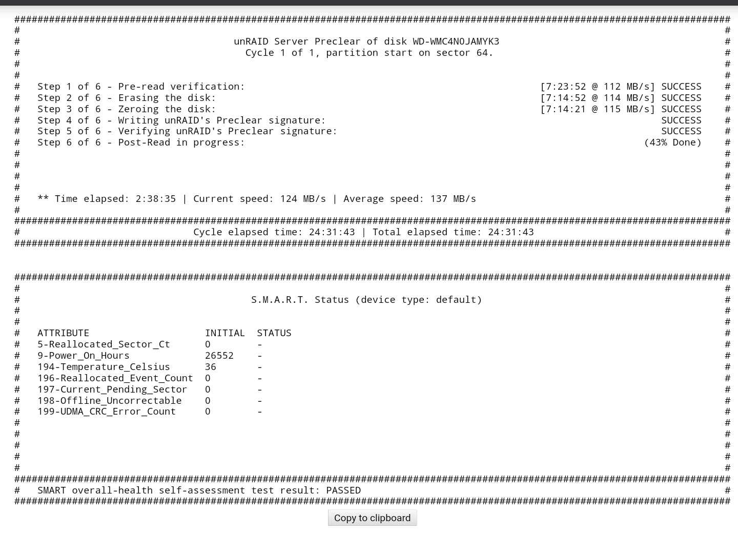

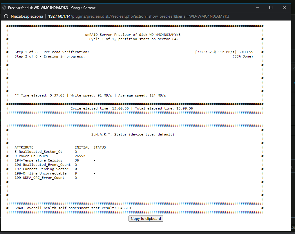

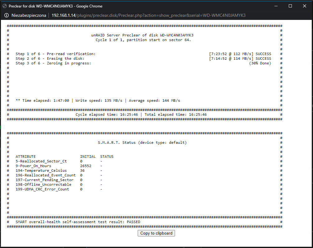

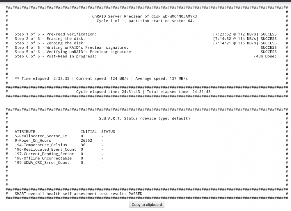

So I deleted this disk from Array and decided to treat it now with Preclear. For now, it is on step 2 out of 6 steps. (Pretclear has been doing a long time too)
Waiting for it to finish, then I will add the disk to Array.
Hope it helps.
Edited by ZiemaF
Preclear is still running
What do you mean with you deleted the disk from the array ?
Is the disk still emulated? Otherwise I hope you have backups of the data that was on disk 3!

Preaclear is not finished doing yet.
One disk failure will not result in data loss (I hope)
Depends on your answer to this question
Yes, the entire drive was emulated.

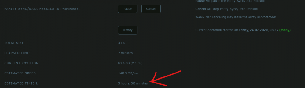

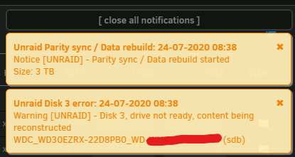

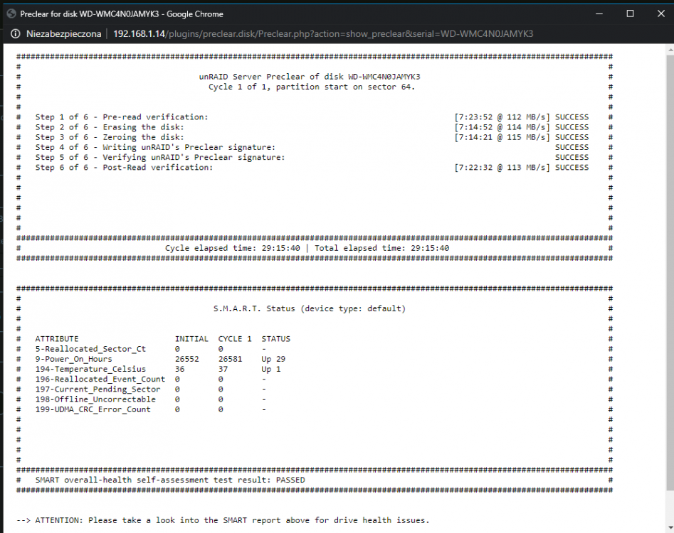

Pretclear was successful.

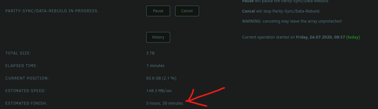

I have now reconnected this disk to Array and the data-rebuild has started.
The data-rebuild process itself will now take over 5 hours. I'll let you know when it ends.
I didn't delete it, I just disconnected it. But the disk was emulated.
I disconnected from the Array so that the disk was unassigned then I could make Preclear on that disk.

The disk that was cleaned with Preclear I added it back to the Array and it rebuilt.
HDD has been working for several days without a problem.
