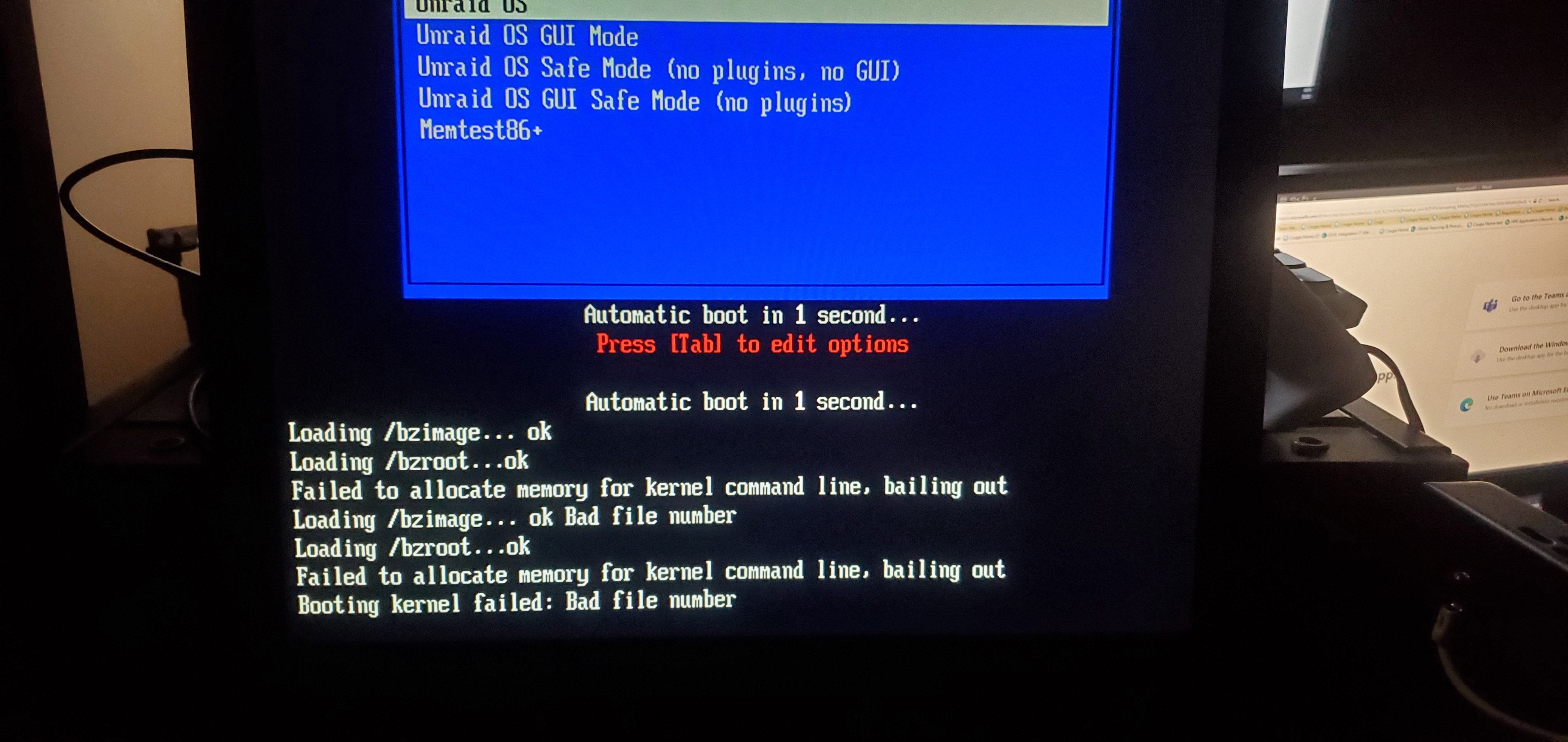

Problem: Upgraded server hardware from Dell Poweredge R710 to a Dell Poweredge R910 when attempting to boot from USB i get an error message; Failed to Allocate memory for Kernel command line, bailing out booting kernel failed: bad file number.

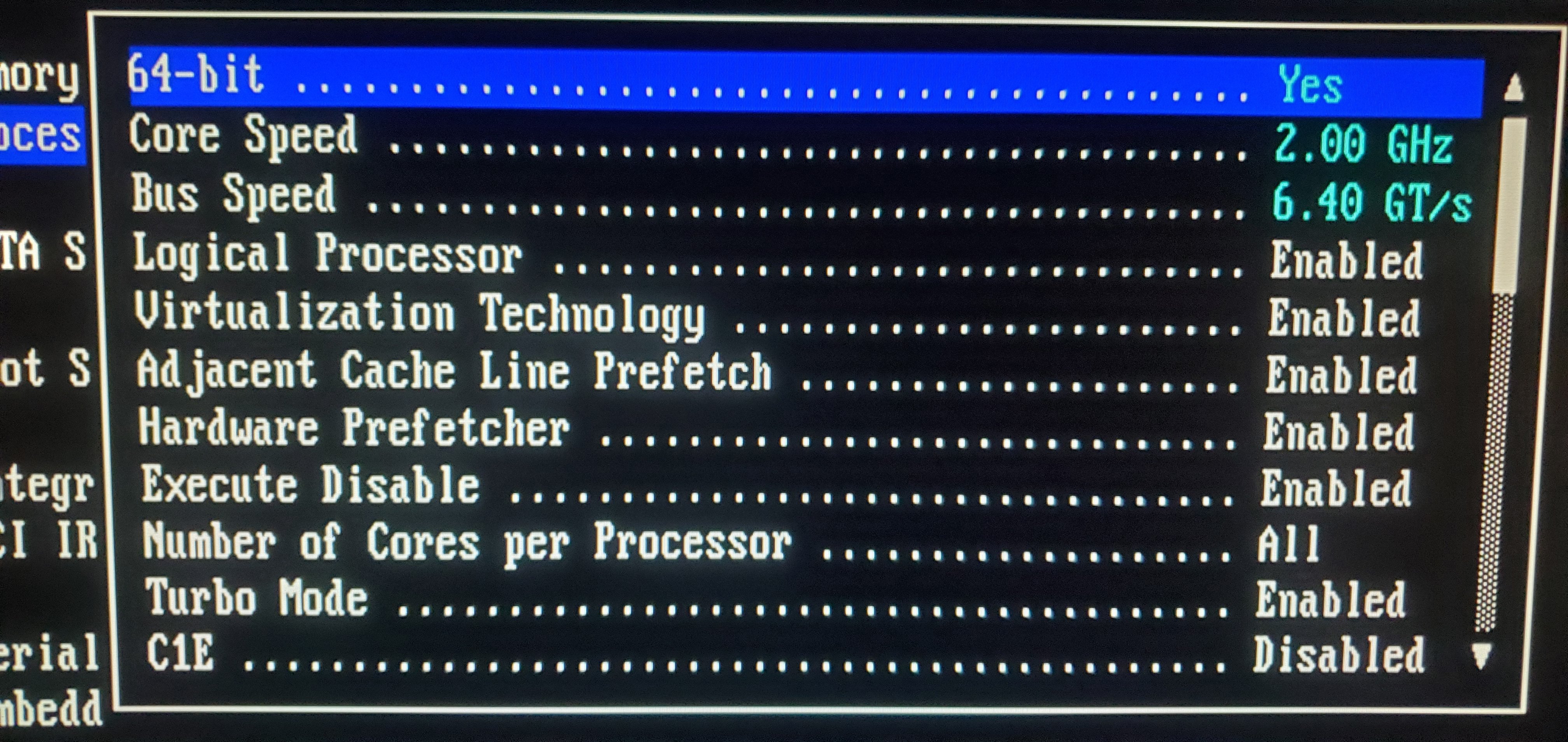

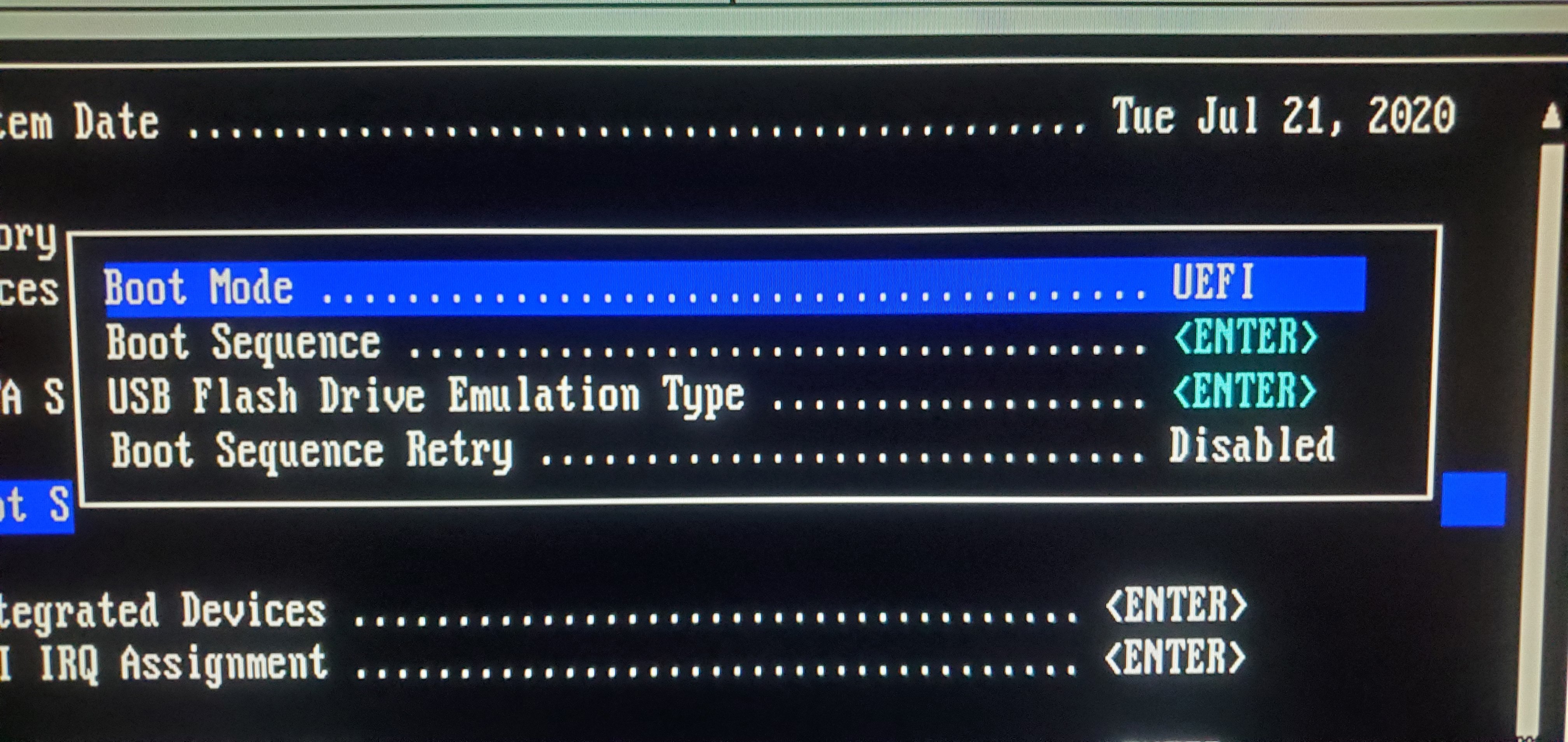

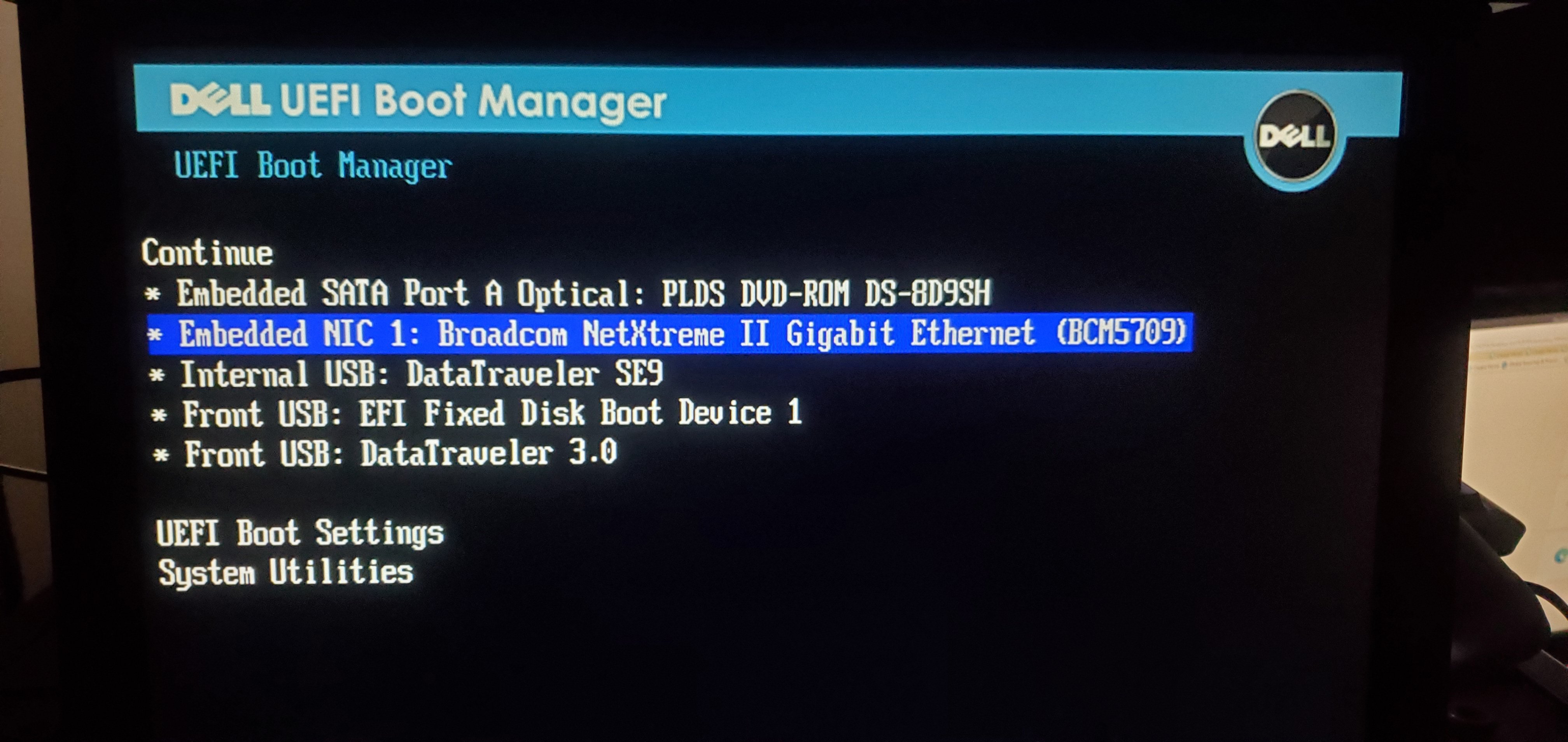

I have verified that the hardware is recognized in the BIOS and posts without issue, the problem comes when i attempt to boot from the Unraid USB in UEFI mode, when i attempt to boot in legacy mode it never gets to the splash screen (GRUB Loader) to boot Unraid. Seeing that there were several people with similar issues i looked for resolution and was unable to find one:

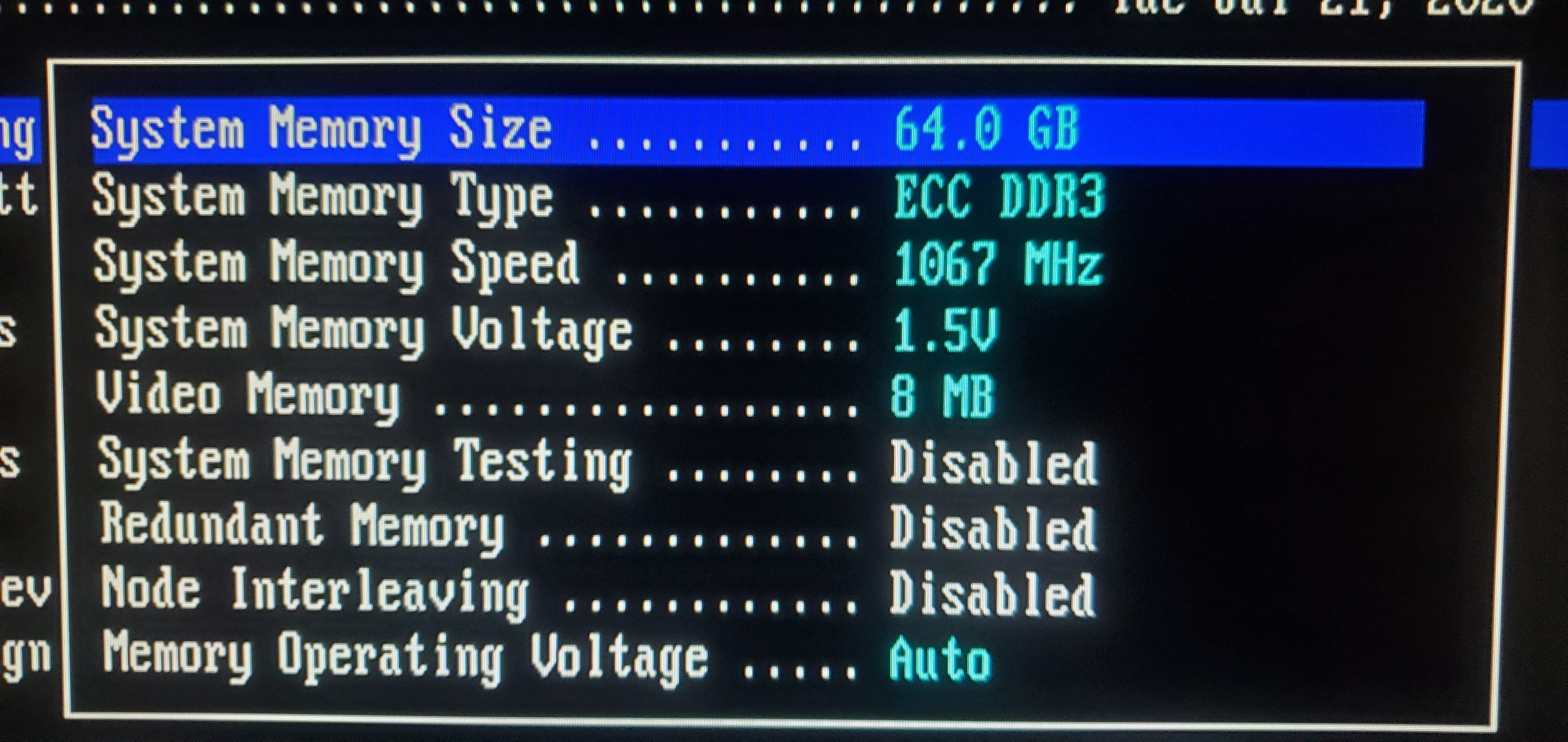

  2. There is an issue with the allocation of memory as video memory in the BIOS/ UEFI that causes the failure of the booting of Syslinux.
    1. I am unable to change the allocation of system memory in the BIOS, it currently shows 8MB and does not allow for editing.
As a side note i have attempted to boot the USB in legacy mode as a drive, hard disk, and floppy none of which have solved the issue. I have also built a new flash-drive with the utility found at https://unraid.net/download using the latest stable release both with and without UEFI support. I have also tried the internal and external USB (front/ back) and all give the same results.
