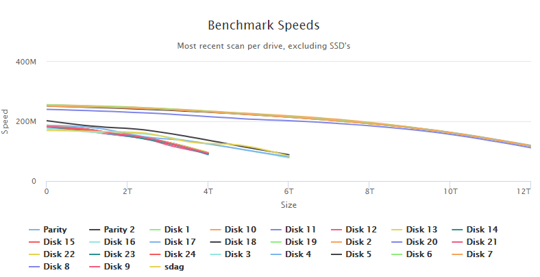

Had 8 data disks (12tb and 6tb) previously. Added 16 4tb drives and everything seemed fine, but when monthly parity check came it took 3.5 days instead of about 1. Duration correlates to speed staying around 40. Altho currently at 1.48tb (12.4%) and getting 70, but that is still way less. Does the parity calculation get exponentially more difficult and makes it slower or i something else going on? The disk speed docker test does not have the 4tb disks capped at 40. A 6tb seagate barracuda (shucked) was added since the first slow check. Being as everything else seems fine I haven't worried about that issue thinking at the next monthly check if it does the same thing then I'll post. I had to perform an unclean shutdown earlier which triggered the check, but canceled it to add the 6tb disk and restarted the check.

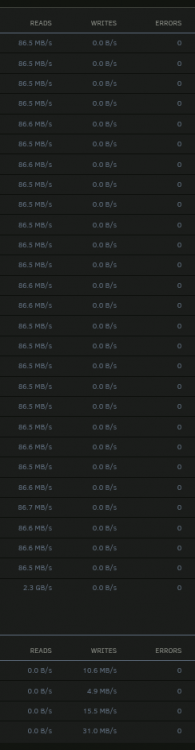

There are a few writes going on to disk8, not much but it can still make a difference, current speed is 85MB/s, make sure it stops writing to the array and see if it improves, other than that nothing jumps out.
when mover ran (< 1 gig of files) reads dipped a bit but bounced back and have maintained 75 to 88. Still quite a bit slower than used to be. Position is 2.14 tb (17.8%). After it passes the 4tb mark ill update as thats the only main variable left then. Gonna script something to grab the speeds as it goes to be able to see a graph over time and correlations with disk speed graph.

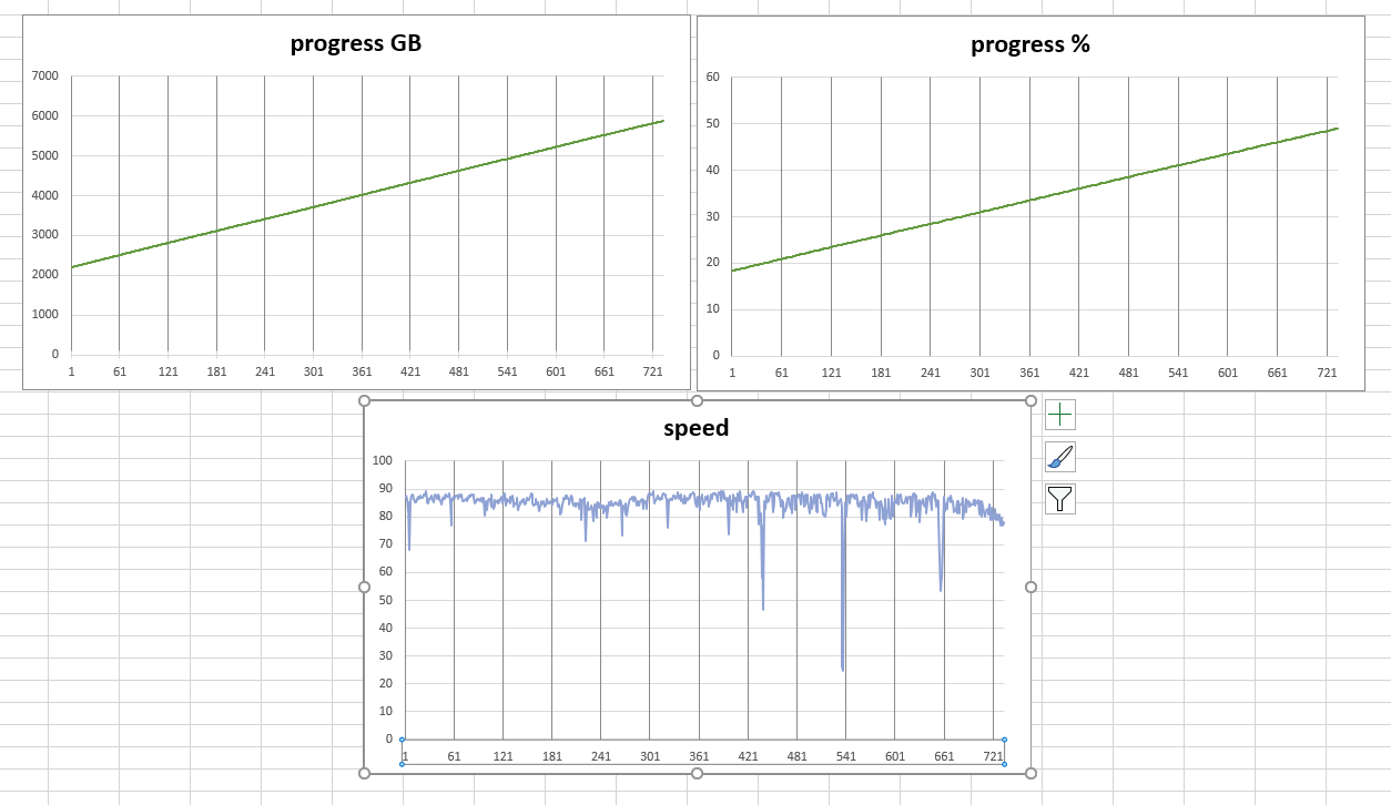

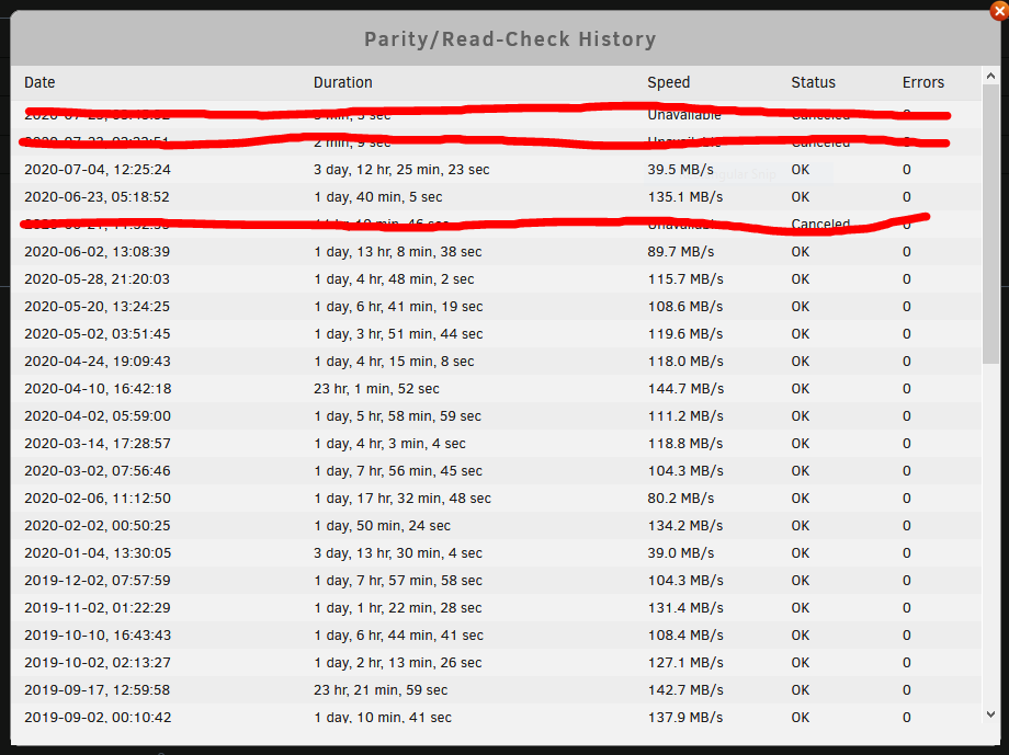

Excel was not cooperating with how was trying to graph, so 3 graphs (left out time left). Stat are grabbed every minute and parsed after from text file since this was thrown in quickly. Will have it fixed and grab the whole run when monthly runs on the 1st and then will add to the linked post. The old config of 8 disk array did at least 1 or 2 parity checks after updating to 6.8.3. Being as there was a check on 5-20 & 5-28, 3 or 4+ checks have happened on 6.8.3 and the many others in the 6.8.X range (i tend to update 1 to 3 months after an update is out as that requires a restart). Currently at 6.03 tb (50.2%), and only reading from the 5 array 12 tb disks (and 2 parity) is still at ~80 (def better than 30/40). Guess I crossed some threshold of disk count to cause slowness in 6.8, probably.

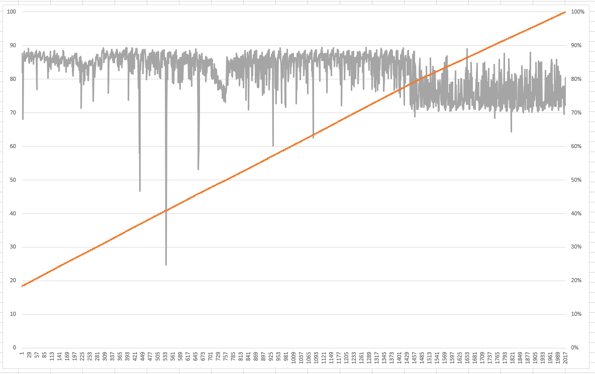

The drop at 80% is weird, but should have a full picture in a week when full run is recorded. Almost 2 days is slow (1d 19h), but tolerable compared to 3.5 days. Since it looks like the slowdown is a 6.8.x issue, ill mark this as solved.
