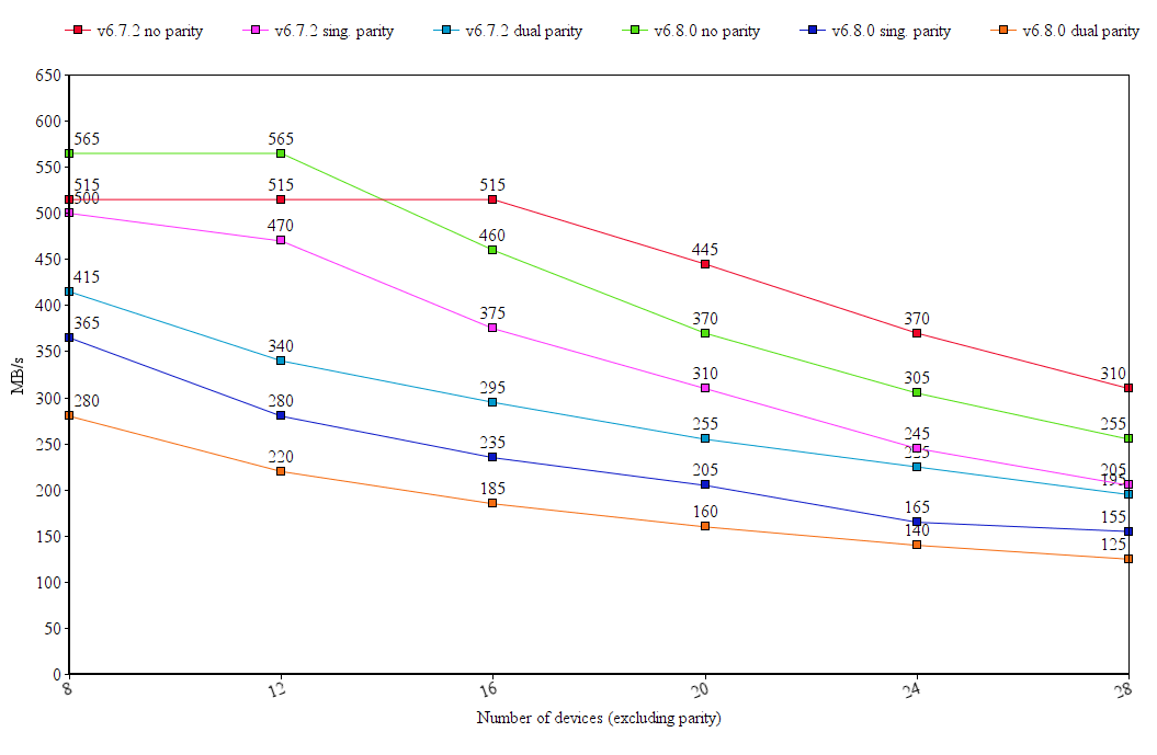

This is from my test server using only SSDs:
You can see parity check speed with v6.8 is always slower independent of array size, in fact v6.7.2 is faster with dual parity than v6.8.0 with single parity, there's one curious exception, a read check (no parity) with 8 or 12 devices where v6.8.0 is noticeably faster, all results are consistent on repeat testing (+/- 5MB/s).

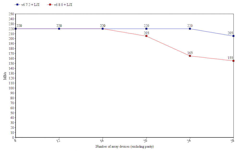

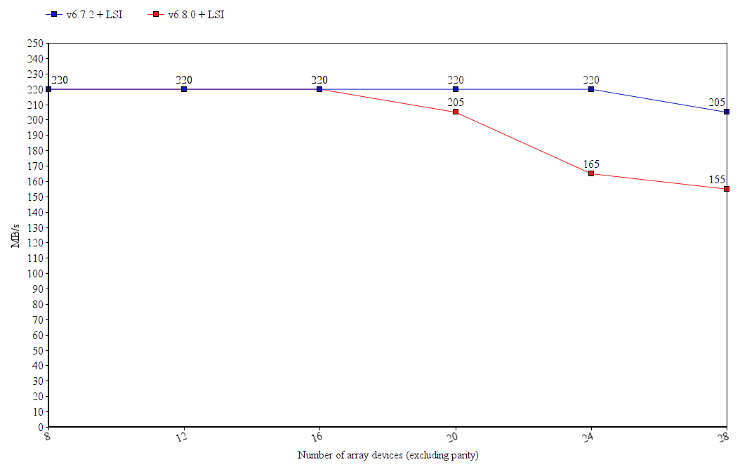

Since most servers are disk/controller limited I ran another test this time always using one slower SSD with a max read speed of 220MB/s (with single parity):
So in a typical HDD array where disks are limited from 150 to 200MB/s the user would only start noticing the issue with more than 20 devices or so.

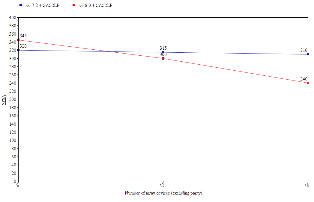

I'm limited by the hardware I can test on but to try and rule it out as much as possible, mostly the disk controllers, I also did some tests using 2 old SAS2LP controllers (also single parity):
I can only connect up to 16 devices on both controllers (parity is on an Intel onboard SATA port), but the trend seems clear, though interestingly it's faster than before with 8 devices, this can be because the tunables used with v6.7.2 are more tuned for the LSI or the new code just works better with the SAS2LP and few devices.
