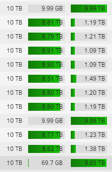

Just wanted to confirm, that this explains some pretty huge difference in used space on empty array disks.
I emptied 3 identical 10 TB disks on my array and - 2 older ones have ~10GB used space, while the newest one has ~70GB.
I assume, the 3rd disk was formatted with the newer version of xfs?
Same with the newest 18TB drives, I guess? They all have 126GB used space freshly formatted, instead of ~18GB...
Would very much appreciate, if anyone could confirm, that I'm understanding this correctly.
You are.
