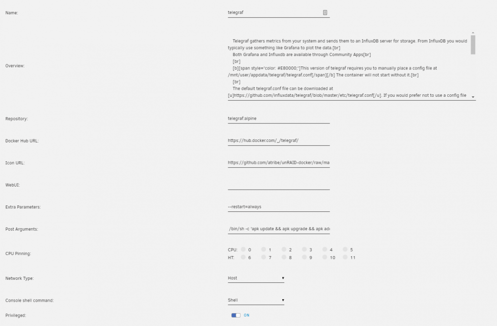

I seem to have gone backwards as now my panel is not reporting anything I am getting everywhere NO data and in the telegraf logs all I see is the following lines
/bin/sh: 1: apk: not found
using the alpine container?

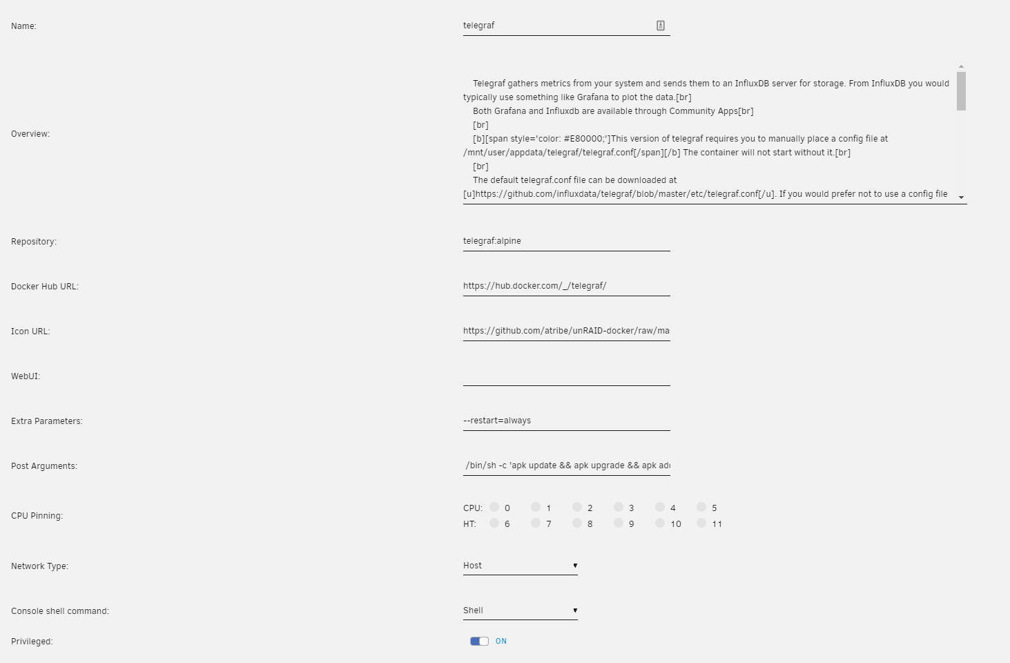

I accidentally changed it from alpine to latest, that seems to have caused this issue, but still get some n/a in the interface
Please share all your setup configurations for Telegraf and Grafana
sorry the docker configuration or the conf files for both?
docker and confs
Hey,
this looks awesome. Is there a Tutorial on how to install this?
i dont have unraid installed yet (waiting on my hardware)
I  woul like to Install this as soon i have my unraid up and running :)
Greetings

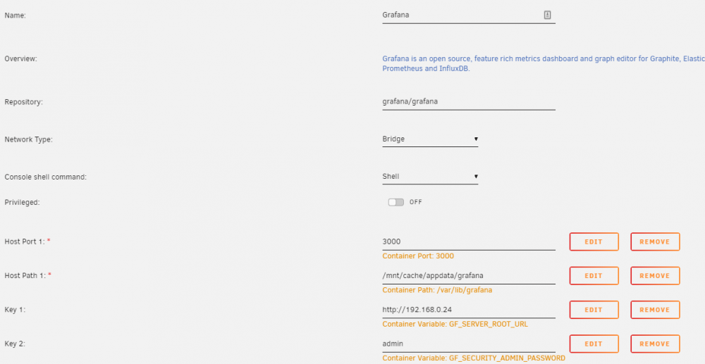

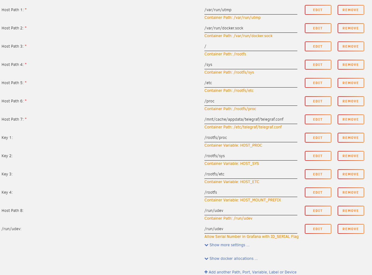

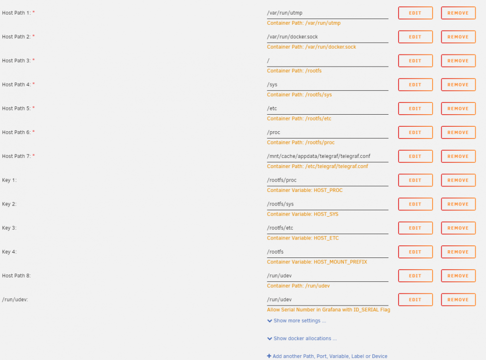

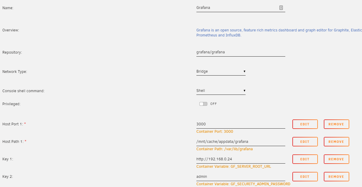

Thanks again GilbN for the assistance, I found the conf file for telegraf but I am not sure where the conf file for grafana is stored as it is not under appdata/grafana
grafana_docker.thumb.PNG.7a301f61e027dd14421b59aed931197d.PNGtelegraf.ziptelegraf_docker2.thumb.PNG.96c57db3b8cbca290104ed75afcbc07a.PNGtelegraf_docker1.thumb.PNG.0aaaab646b0113a9683fbb8cfb15ca20.PNG
grafana_docker.thumb.PNG.7a301f61e027dd14421b59aed931197d.PNG telegraf.zip 55.14 kB · 0 downloads telegraf_docker2.thumb.PNG.96c57db3b8cbca290104ed75afcbc07a.PNGtelegraf_docker1.thumb.PNG.0aaaab646b0113a9683fbb8cfb15ca20.PNG
you have two /run/udev mounts, remove one. Not sure if that can create conflicts. And pastebin you telegraf.conf please.

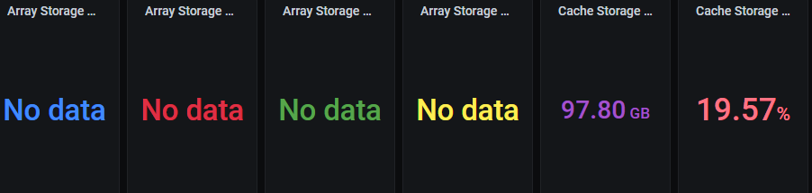

I found the reason for the no data as it was pointing to /mnt/user0 which is not present on my system, mine is all /mnt/user so changed that and now it shows the total sizes and growth.
Do you not have any drives in the array?
I have 14 array drives and 2 parity drives.
Does it say /mnt/xxx or /rootfs/mnt/xxx in Grafana for you.
A bit wierd you dont have user0 in the disk.path column
I manually edited them all to /mnt/user as on my array I don't see that directory with 6.8.3
Ah, do you have any dedicated cache devices?
Yes I have a NVME cache drive, I have selected the drives at the top of the grafana for cache/array/parity.
I think its this line in your config.
ignore_fs = ["tmpfs", "devtmpfs", "devfs", "iso9660", "overlay", "aufs", "squa shfs"]
"squa shfs" is probably also ignoring fuse.shfs
Edited by GilbN
how should I change this or should I now just leave it alone?
See if ignore_fs = ["tmpfs", "devtmpfs", "devfs", "iso9660", "overlay", "aufs"]  adds the user0 path
