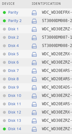

One last question on the OCD front notice in the image attached how Disk 3 is missing - its cos I made what used to be Disk 3 to be Parity 2.  Is there an easy fix for this or - leave well enough alone?
I waited a while before posting up here as I am not a true expert in walking someone through the steps required.  What you want to do can be done.
Read through this section on converting file systems on an array:
     https://wiki.unraid.net/index.php/File_System_Conversion#Mirror_each_disk_with_rsync.2C_preserving_parity
Particularly the section entitled "Mirroring procedure to convert drives"   Read and understand the steps 10 through 16.   The steps detail how to reassign a disk from one position to another.  Since you have dual parity, you will have to rebuild parity because the Parity2 calculation is disk location dependent!  So don't click the box for Parity is already valid
Personally, I would copy out those steps, paste the text into a text document and print out the instructions.  Then mark up the copy, crossing anything that does not have to be done for your somewhat simpler procedure and change the numbers to the exact disk#'s (and disk serial number--using the last four numbers is usually sufficient.)  that you will be working in the reassignment.   Then make a check mark as you do each step.
