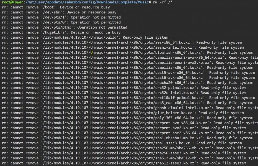

So I did execute
rm -rf \*
on accident and then stopped it pretty quickly (<2s), and the command generated a bunch of cannot remove messages,

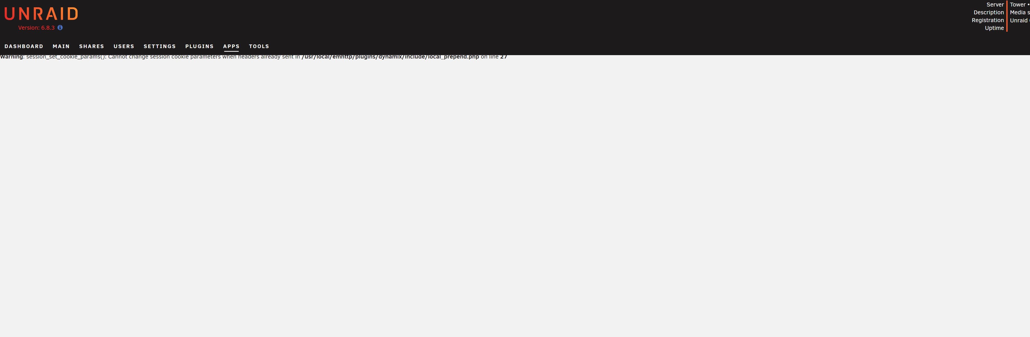

now the Web UI doesn't work, but the shares, docker containers all seem to be live and working.

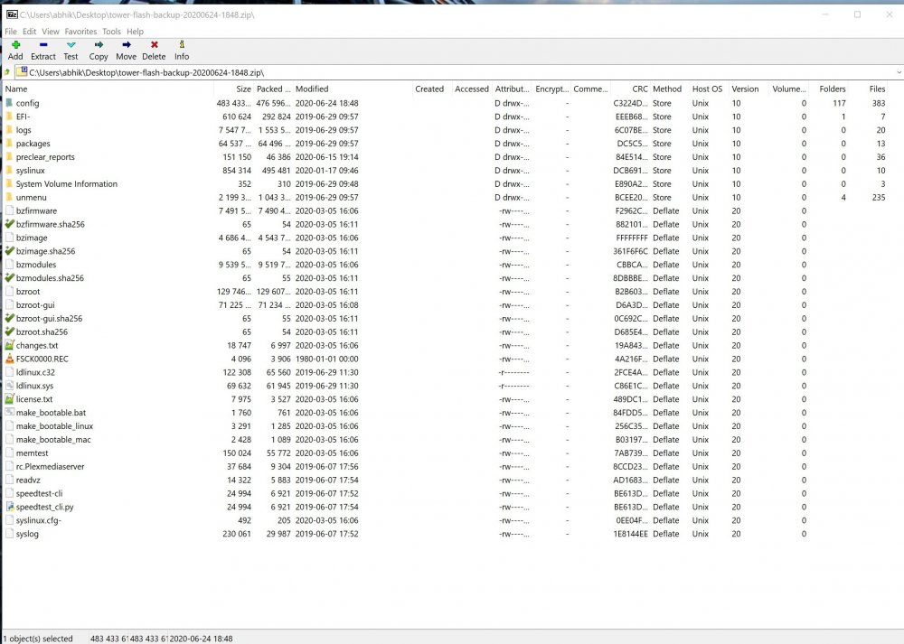

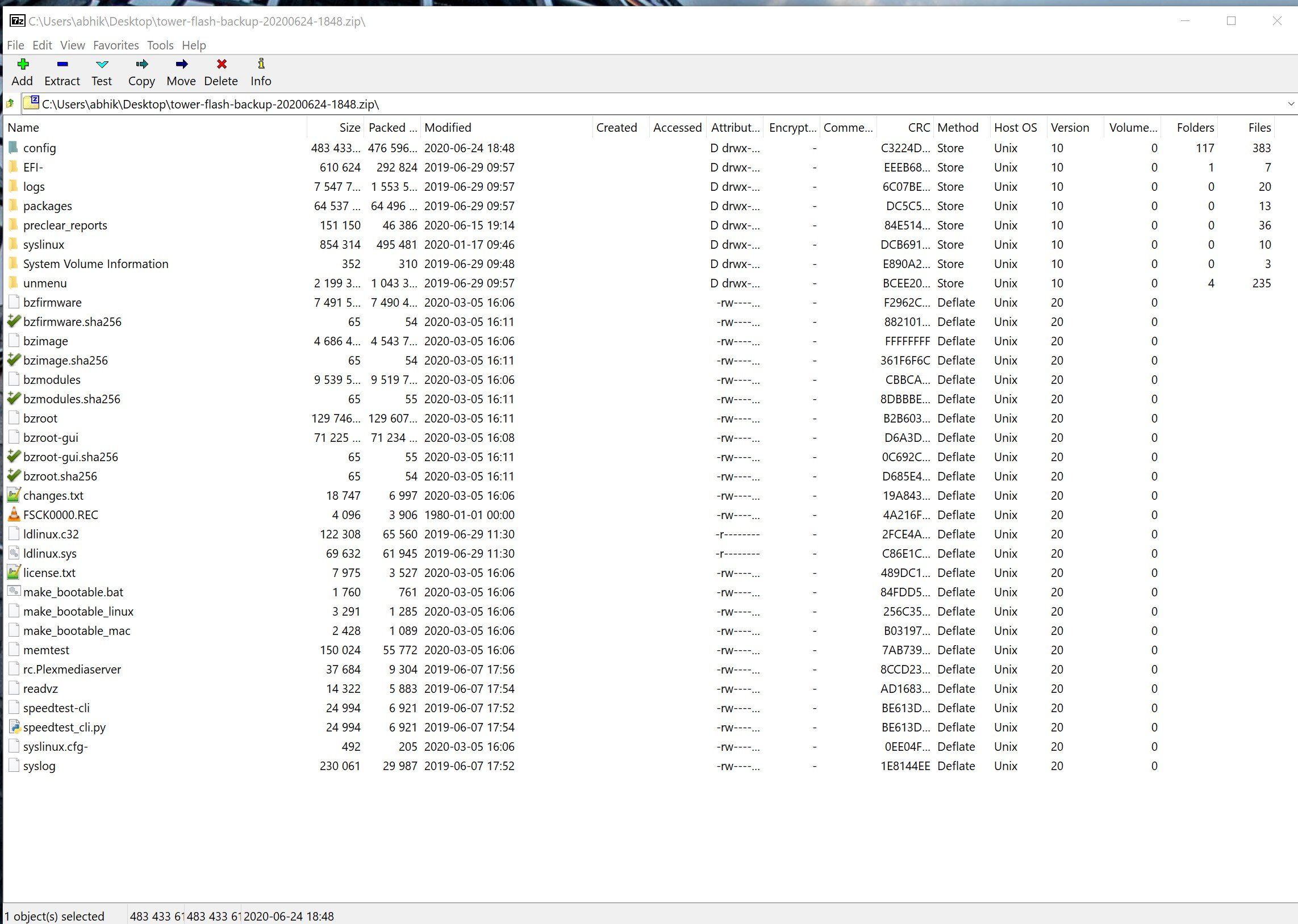

I found a back up from June (06/24) saved on my desktop - I think I replaced the USB drive then and this was saved for that.1055025300_Screenshot2020-09-22191521.thumb.jpg.565ae5d5066ed43d8aeba6f4229364bc.jpg
So can I use anything from this?
The config folder and disk assignments should be pretty accurate.
Pretty accurate and is accurate are two different things.  If there's any doubt if you moved the parity drive to be a data drive since June, then delete super.dat and reassign the disks manually.
Other than that, everything in /config you want.
