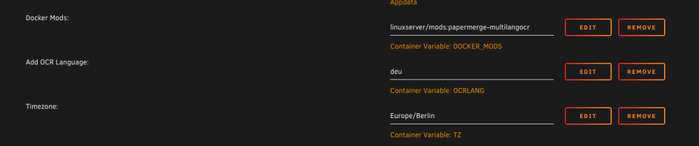

  • to get german the interface in german language add the following to papermerge.conf.py in appdata folder LANGUAGE_CODE = "de-DE" to get german language for OCR go to docker shell and type a
  • Hey i use this also use this tool in german and for all the not english users check out the mod.   https://github.com/linuxserver/docker-mods/tree/papermerge-multilangocr   With th
  • First of all, thank you for providing us this Template  I just installed it and have one question: As far as I know papermerge should come with German and English lanugage support. But after inst

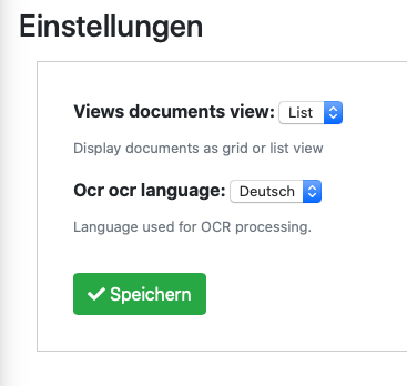

Seems to work, because now it says "OCR = GERMAN" (see screen)
I'll verify that with some documents containing special german chars like Ü-Ä-Ö 😜

If we add German we have to add other languages also. So the full language pack for tesseract is over 600MB.
With the mod you just have to add an environment variable for the German tesseract package.
We build papermerge from source and need to supply a config file as there isn't a default one, just an example one has to change for ones need.
thx a lot! the mod is a nice solution to satisfy the mob ;)

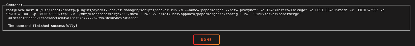

Anyone have any idea if their is a variable for the Clock or setting timezone? Looking at last user login, having just logged in the time is WAY off.
Have you checked that the TZ env variable is in the run command and that it is correct?
Try to exec the date command inside the container and see if that is correct.
Appears the TZ in run command is correct; Not sure how to run the date command inside container exactly? 😞

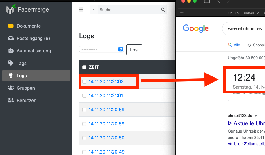

"# date
Mon Oct 12 18:36:08 CDT 2020
Papermerge however in the GUI shows my login time as "Oct. 12, 2020, 11:36 p.m."
Something awry somewhere. DOH. It got the "36" part right. :scratches head:
6 hours ago, blaine07 said:
The terminal is reporting the correct time.
"# date
Looks like you might have to set the correct timezone in papermerge. Isn't there any setting you can set?
I’m guessing your right but not seeing it anywhere. Settings menu VERY limited. Not seeing a variable to set anywhere.
Anyone else’s time grossly incorrect? [emoji848]
@blaine07 it would appear my times are incorrect as well. When I review the logs via the GUI in Papermerge, the times displaying for me are about 5 hours ahead of what my actual time is. Wouldn't have noticed it without you pointing it out lol

@blaine07 my timestamps are also not correct.
current time of my MacMini = 17:54
time in the papermerge log = 15:54
time in console (unraid and docker) after the command "date" = Tue Oct 13 17:54:36 CEST 2020
That "exact 2 hours difference" thing seems to be a well known problem when googling that .. some kind of UTC (Linux standard) in addition to another time zone (Berlin +1 hours ) AND the european day light saving zone (+1 hour) ...

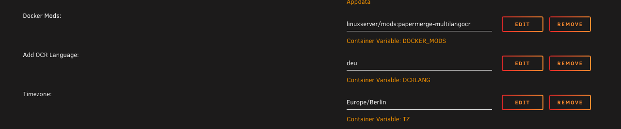

With this you can add additional languages.
The problem with (console in the container->install additional languages) is they are gone with every upade.
See the config here for german:
Edited by d3fault

But can you please verify the timestamps in you log with the real time?
I set my timezone to Europe/Berlin as well but time in the logs differs one hour to the current time
726979649_Bildschirmfoto2020-11-14um12_24_15.png.b8067f078a4de5d6c78a9a32b486b984.png
