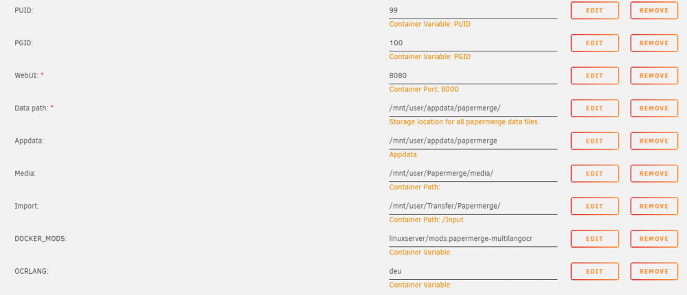

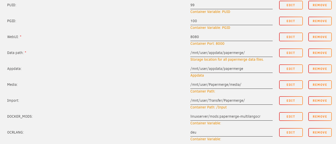

I tried to install this mod but for some reasons i cant get it running.
I think the variables are set correctly but if i start the docker, this variables are not shown in the command line.
If it's not in the run command, you have done something wrong.
Please post the text of the docker run command next time. The screenshot is low quality and hard to read.
Sorry, my bad
root@localhost:# /usr/local/emhttp/plugins/dynamix.docker.manager/scripts/docker run -d --name='papermerge' --net='bridge' -e TZ="Europe/Berlin" -e HOST_OS="Unraid" -e 'PUID'='99' -e 'PGID'='100' -p '8080:8000/tcp' -v '/mnt/user/appdata/papermerge/':'/data':'rw' -v '/mnt/user/appdata/papermerge':'/config':'rw' -v '/mnt/user/Papermerge/media/':'/media':'rw' -v '/mnt/user/Transfer/Papermerge/':'/Input':'rw' 'linuxserver/papermerge'
Can you hit the edit button behind the docker mods entry and show that? I'm not exactly sure, but I believe you haven't set the key value.
Gesendet von meinem ONEPLUS A6013 mit Tapatalk
yes ... that was the problem. now it works. Thank you very much

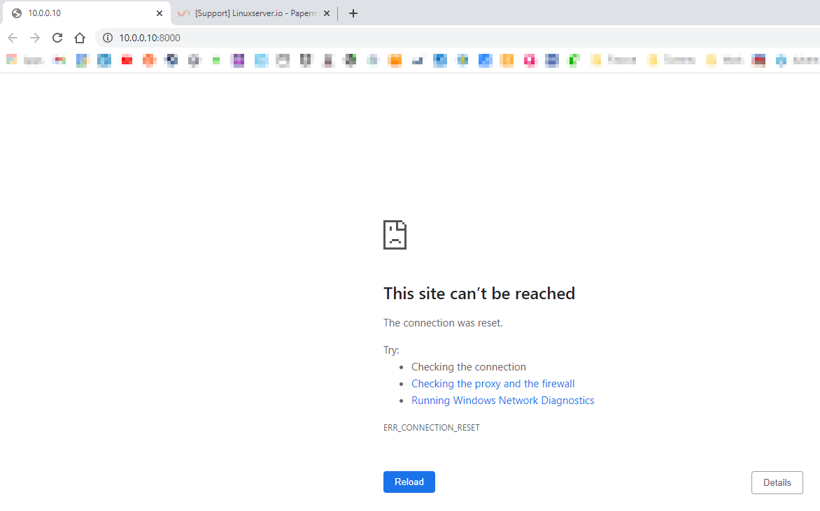

So the last few days I've lost local access to this container completely for some reason. I don't really understand why?
But it works via my reverse proxy still? How weird.
That doesn't make sense as your proxy is using the same address. Something locally on your computer blocking the page? Or any setting you have done in papermerge?
