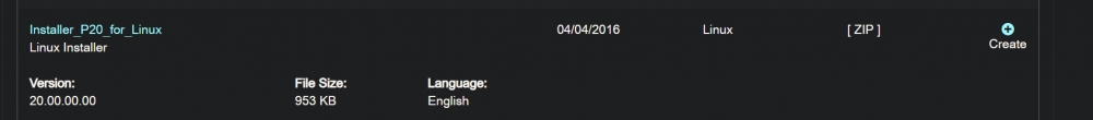

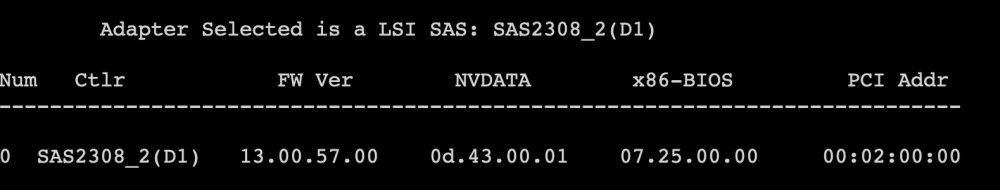

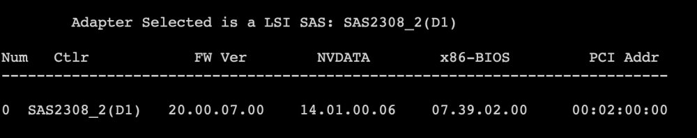

  • Hello,   As everyone, i was seeing some warnings in the syslog. Thanks to this thread, i updaded my 9211-8i from :   Num Ctlr FW Ver NVDATA x86-BIOS
  • Nice video from Art of Server on how to find the various roms, bios, firmwares on the Broadcom website.

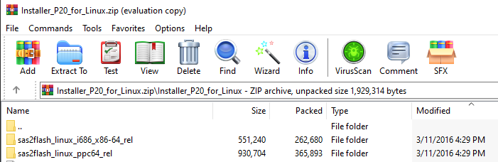

It sounds like you forgot to do some steps. You should first unpack the installer (Installer_P16_for_Linux in the example) and then copy sas3flash to the lsi directory on the USB, something like:
cp Installer_P16_for_Linux\sas3flash_linux_x64_rel\sas3flash /boot/LSI
This is explained but without commandlines in the part starting with 'From the installer package we only need sas3flash (sas2flash for SAS2 models):'

-rwxr-xr-x 1 root root 167424 Jun 13 18:40 sas3flash.exe
You've downloaded/unpacked the wrong installer, probably installer_Pxx_for_Windows or _for_DOS instead of for_Linux
Thanks, I missed that.
Thank you so much for this thread. The most challenging part was navigating the Broadcom website to find my firmware. It worked great for my old SAS 9207-8i (even if the newest firmware is 8ish years old at this point, it's newer than what I had :) )
