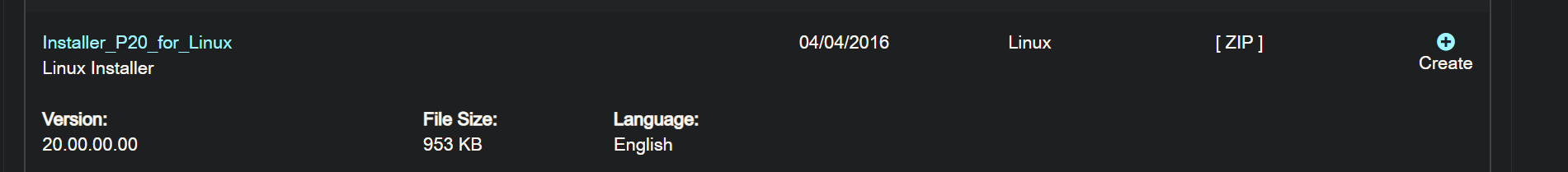

The last version for 9207-8i is
Installer_P20_for_Linux  Version: 20.00.00.00 04/04/2016?
some how Installer_P16_for_Linux Version: 17.00.00.00 having 11/13/2019 newver date ?!?
i buyed the card with v 20.00.07.00 flashed that is the lasted version right ?
No, it's 20.00.07.00
you mean installer or firmware?
i already got  flash v20.00.07.00 on my card
but wanted installer for linux to see flash2sas -list command
and finded only Installer_P20_for_Linux  Version: 20.00.00.00 04/04/2016
also founded that linux installer is same date like for Dos installer
Sorry, misread, yes that's the latest one, and it's whatever is on the LSI site.
Thanks , i downloaded and checked by -list command like in you first post... :)
