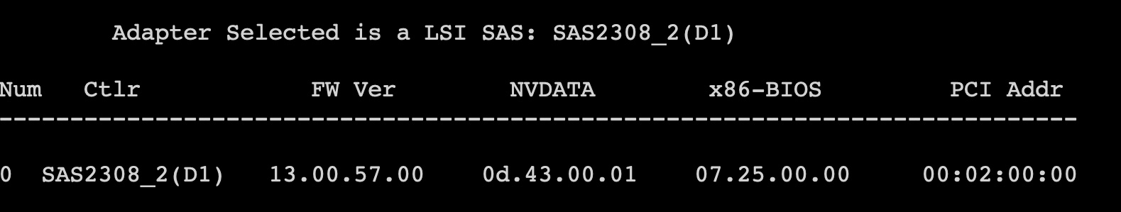

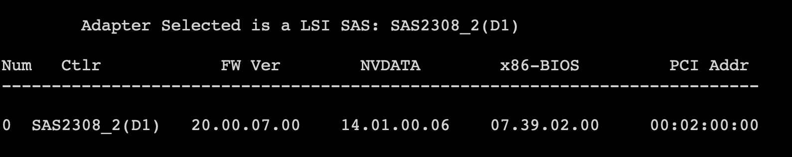

fyi if anyone has a HP 220 LSI 9207-8i I was able to upgrade the firmware and bios of p20 with p14 linux sas2flash.
