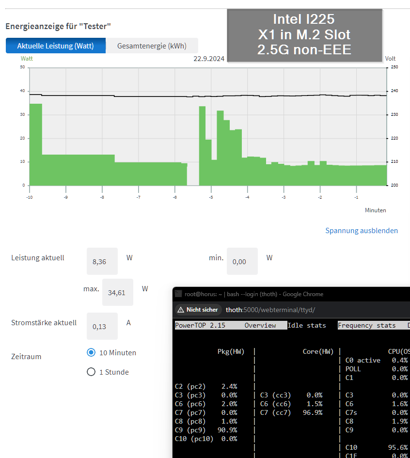

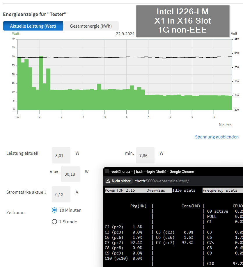

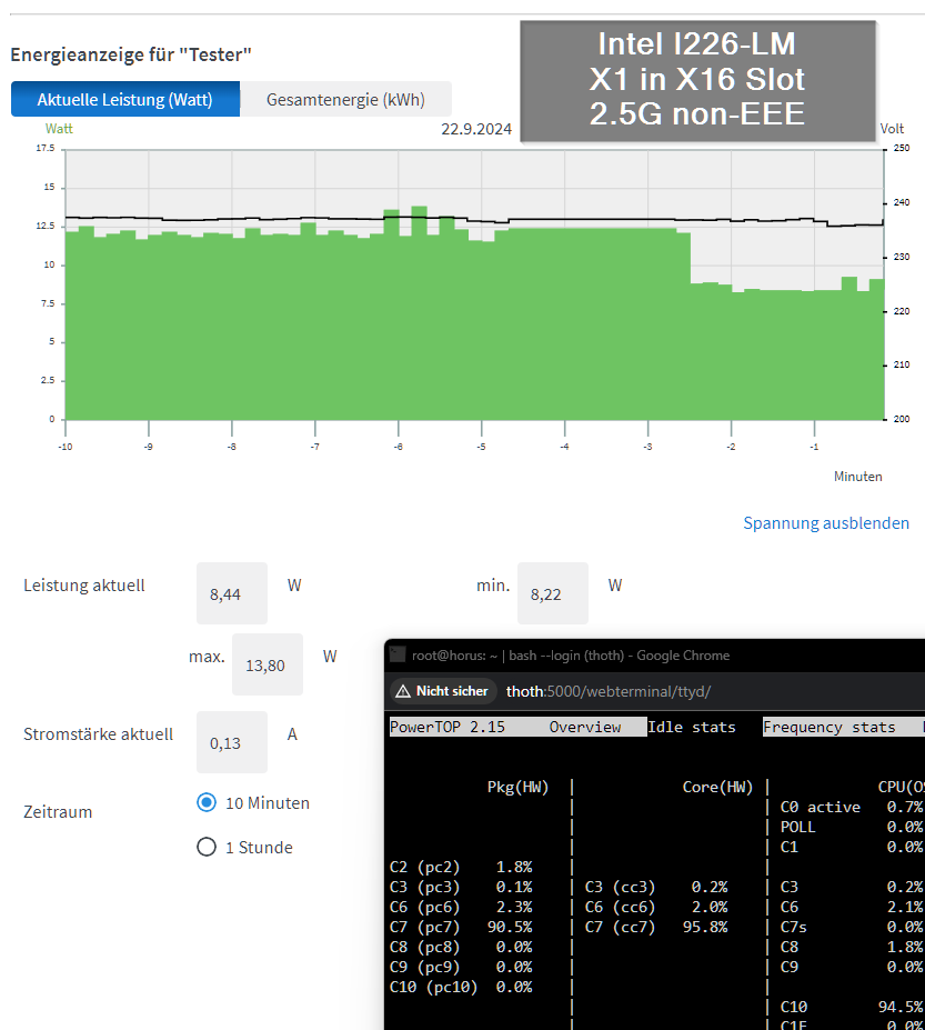

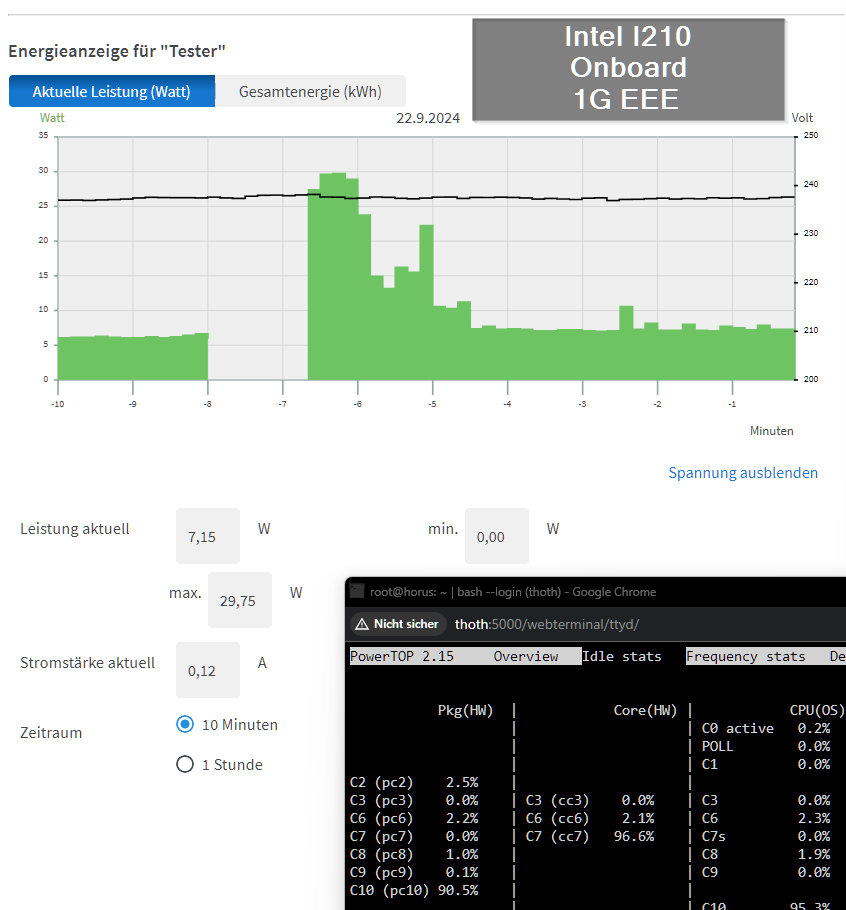

As I had problems to get my new WD Black 8TB running in the C246N-WU2, I disassembled everything and made several new power measurements and c-state tests.
7.15 watts and C10 without any additional cards:
8.44 watts and C7 with Intel I226-LM card in PCIE X16 slot and 2.5G connection ("LM" means "long support from Intel"):
8.01 watts and C7 with Intel I226-LM card in PCIE X16 slot and 1G connection:

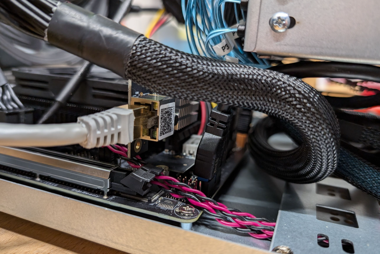

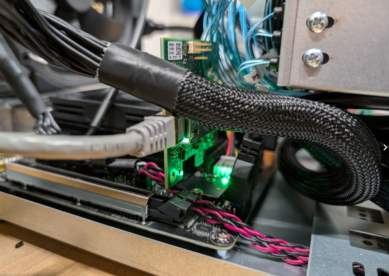

As mentioned the WD Black NVMe didn't like to run, so I tried to install the 2.5G with an M.2 to PCIE X4 riser in the M.2 slot as follows, but although the server booted, the card was not recognized by Unraid (not visible through lspci):
But I had a second 2.5G X1 card from IOCrest with Intel I225 controller and surprisingly this one worked:
8.36 watts and C9:

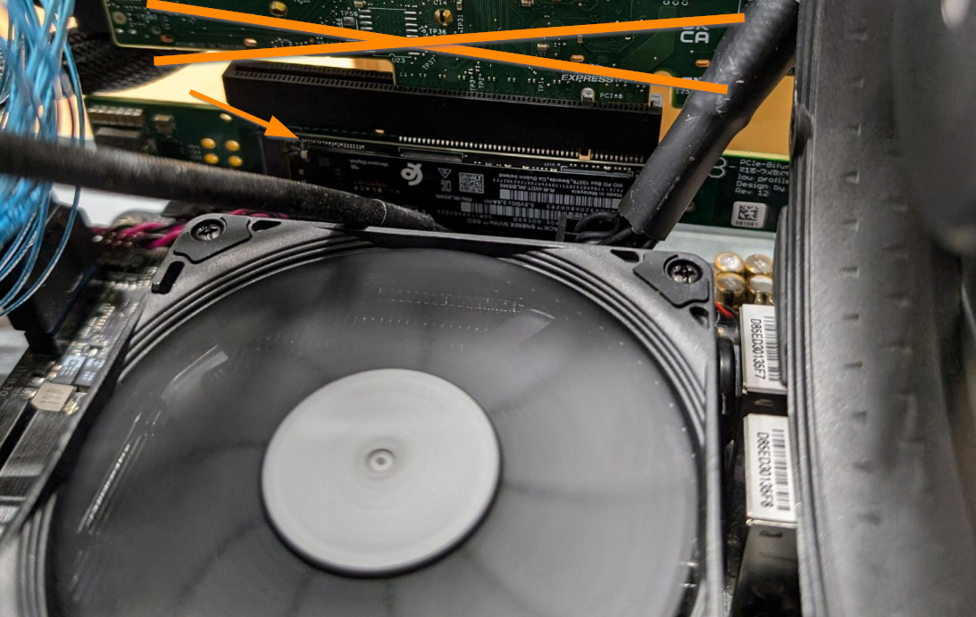

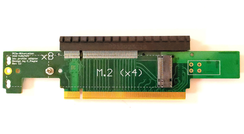

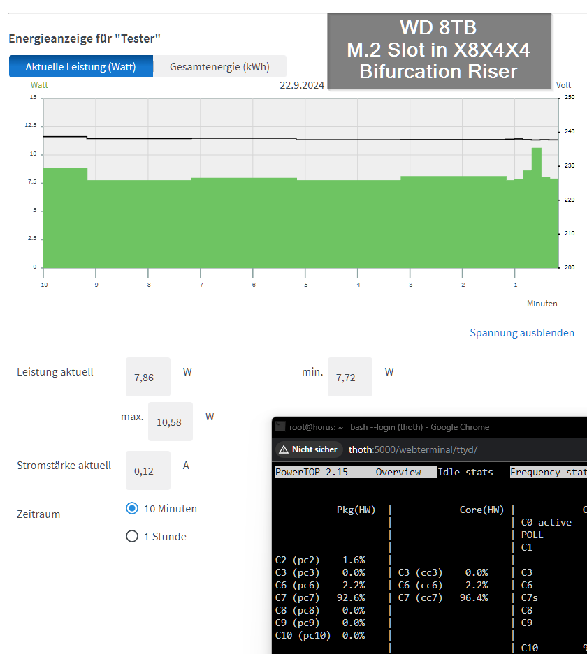

And a last offtopic test was the WD Black 8TB inside a C-Payne X8X4X4 Bifurcation Riser:
measurement was without the HBA card:
Reached 7.86 watts at C7:
So the Bifurcation Riser has only a slight overhead of 0.7 watts. Note: Of course such Risers do not work with every board. For example recent Intel boards only support X8X8 and there must be a setting in the BIOS to enable it. The C246N-WU2 allows X8X8 and X8X4X4. An AMD board often allows X4X4X4X4.

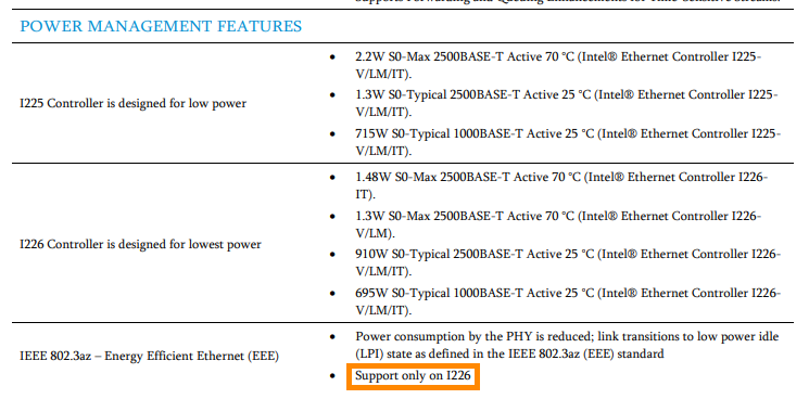

Now back to the 2.5G cards: I think every 2.5G card with Intel controller should reach good C-states. I recommend a card with I226 because regarding the Intel Specs it is the only controller which supports 802.3az (EEE):
Sadly I was not able to enable it. It seems my QNAP QSW-2104-2T supports only EEE with 1G connections, which makes me mad as this restriction is not mentioned anywhere.
