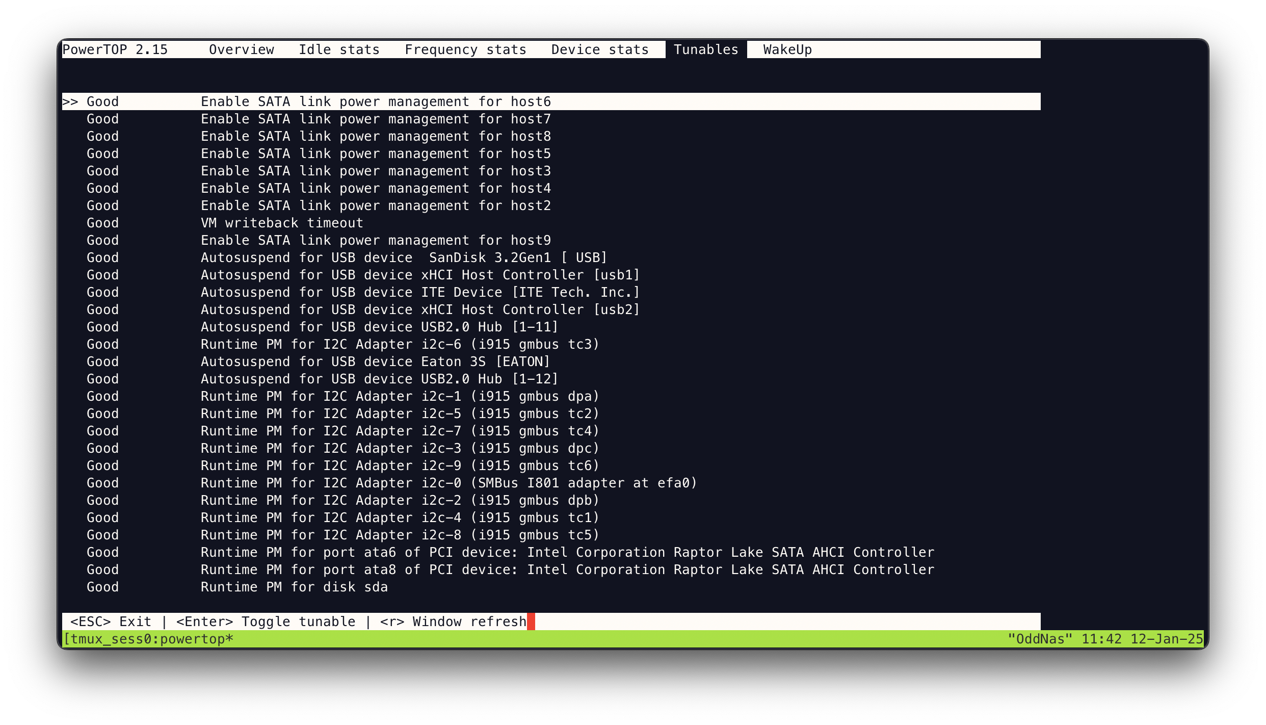

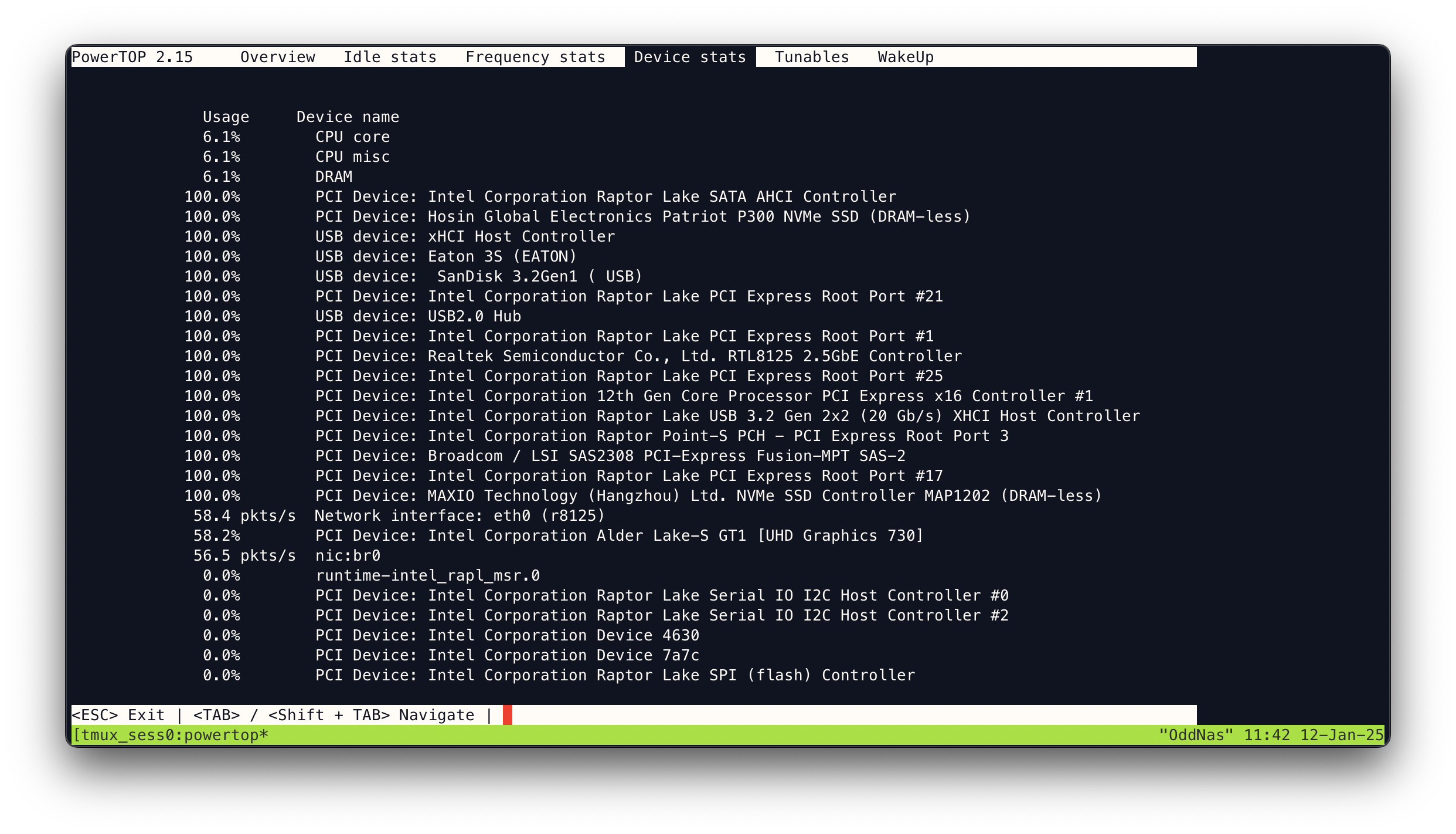

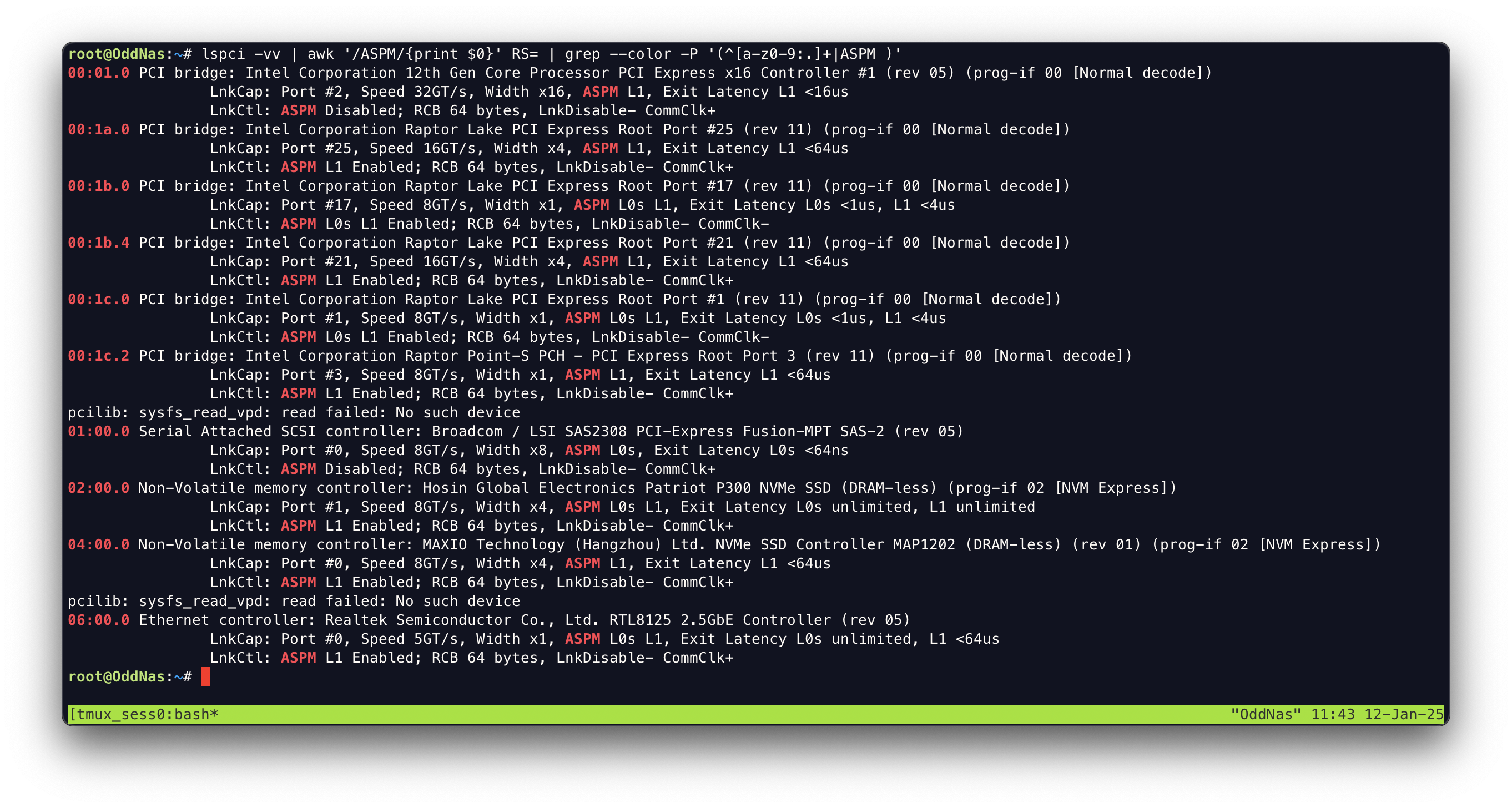

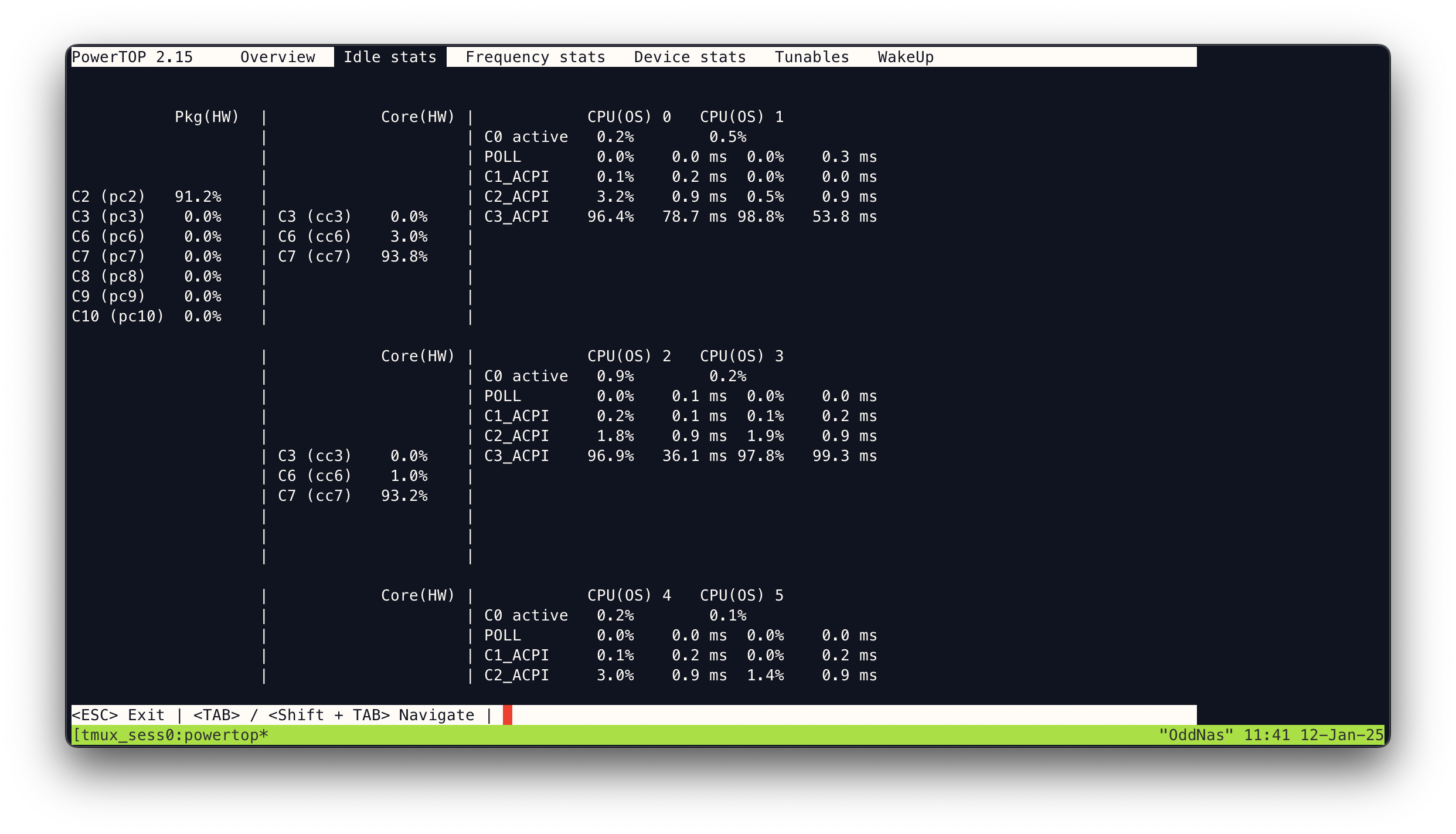

I recently switched to a new MB and now it seems I can't reach the same high C-States anymore.
New Mainboard is the Z790 Aorus Elite DDR4, other than that I only added an LSI-9207-8i to my system.
Settings are these: Link to image with settings (from this thread), since someone else with the DDR5 version of the board was able to reach C10 I was hoping I could as well with that board
Not sure what exactly to make of the info powertop shows me, my best guess would be something between my CPU and the LSI card I have? (Though other things have Usage at 100% too)
Tunables are all on good
The command showing ASPM states shows some as disabled, I've double-checked the bios settings, but there doesn't seem to be anything related to ASPM on disabled/auto anymore

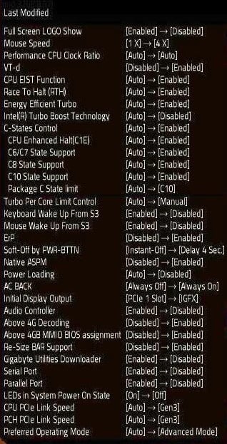

Hey guy´s,
i have a small problem with powertop and i thought my mainboard is the problem, because with a gigabyte Mainboard and TruenasScale it works well.
But i´ve already change my Z690 Taichi to a Gigabyte b760 aorus elite ax and the Problem is still the same:
I only get "Pckg OS instead of Pck HW" - is there a BIOS Setting i´m missing?
No, the used powertop version does not recognize your setup.
 Test it without this card and you probably see better c-states.

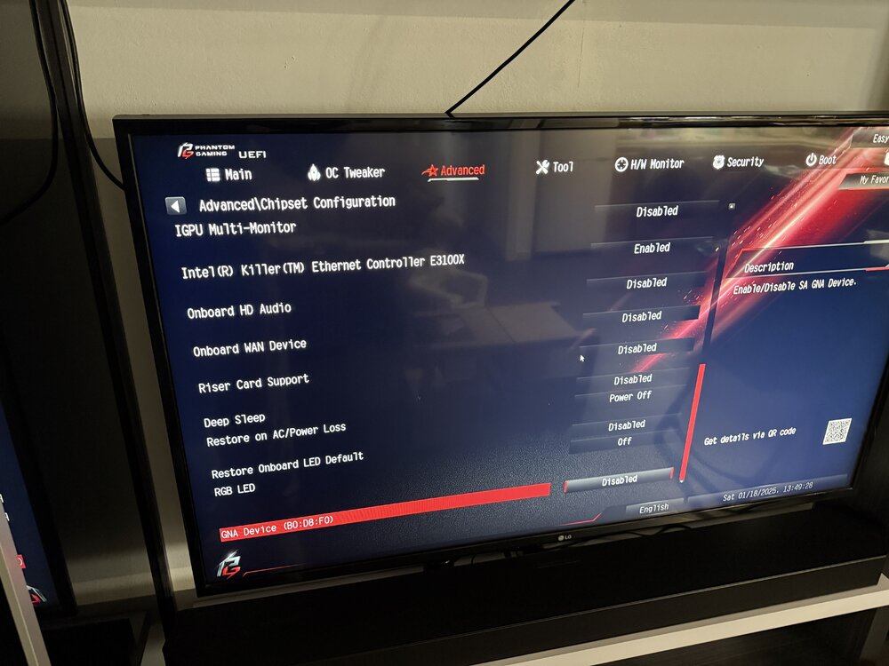

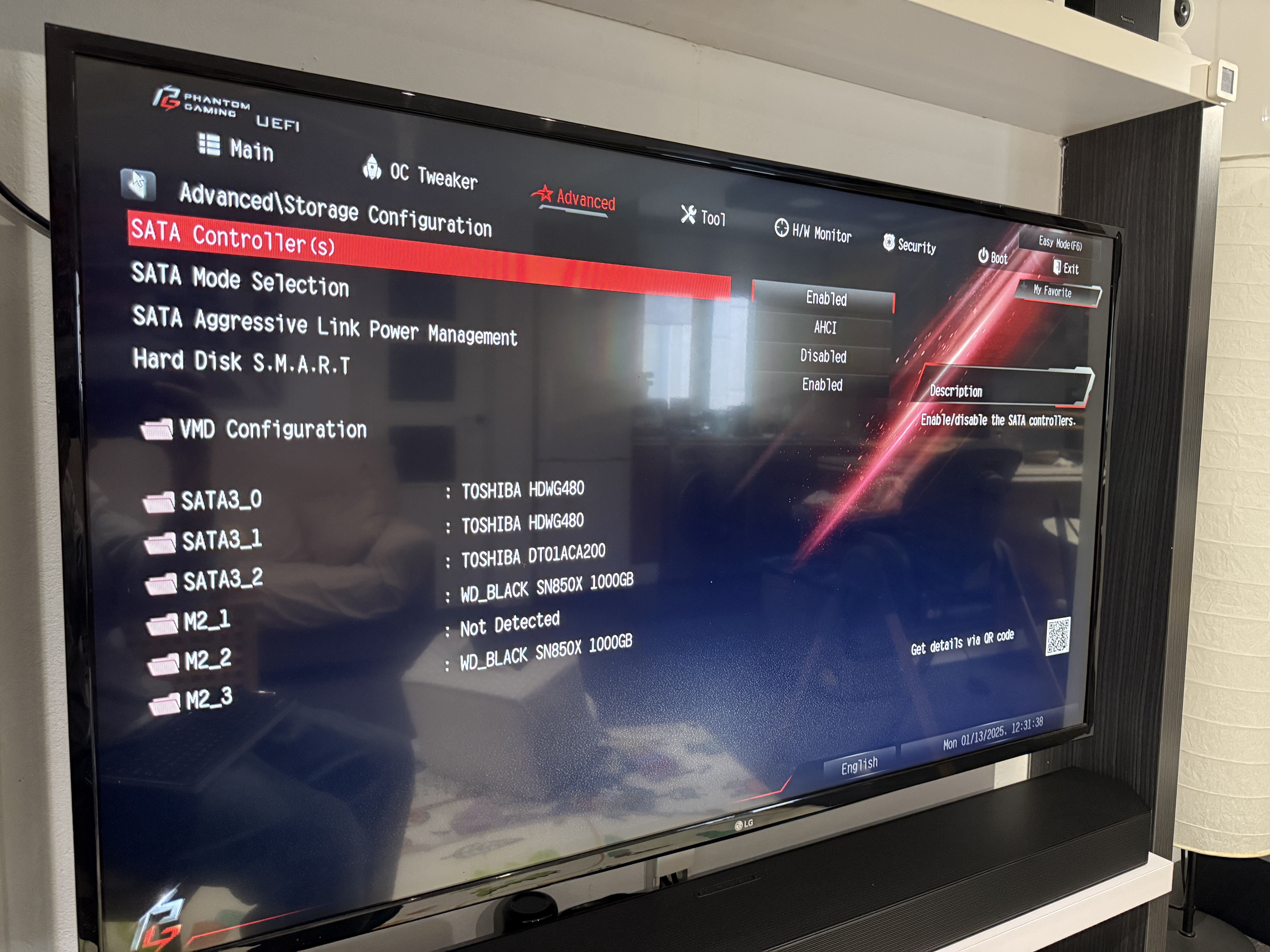

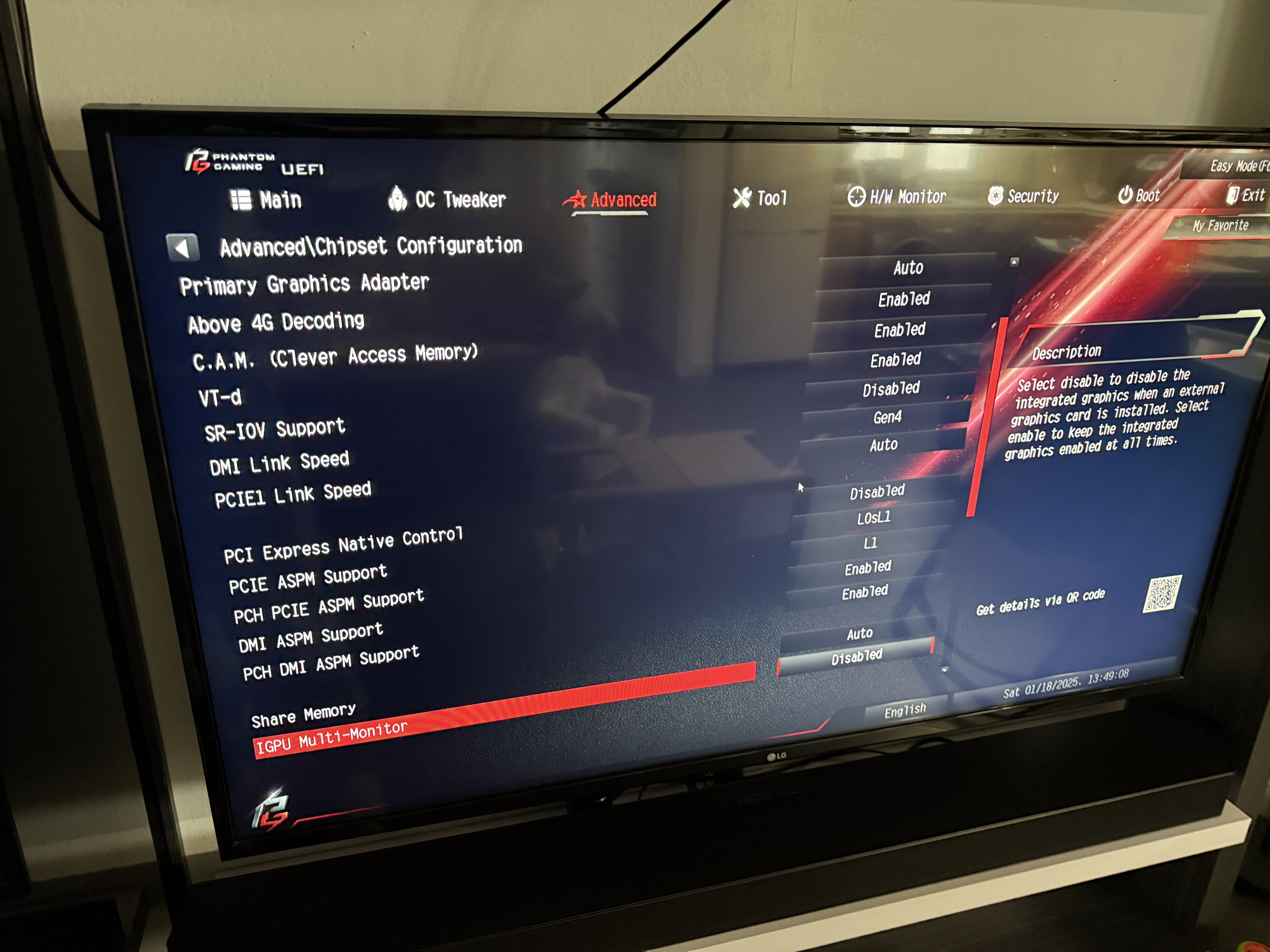

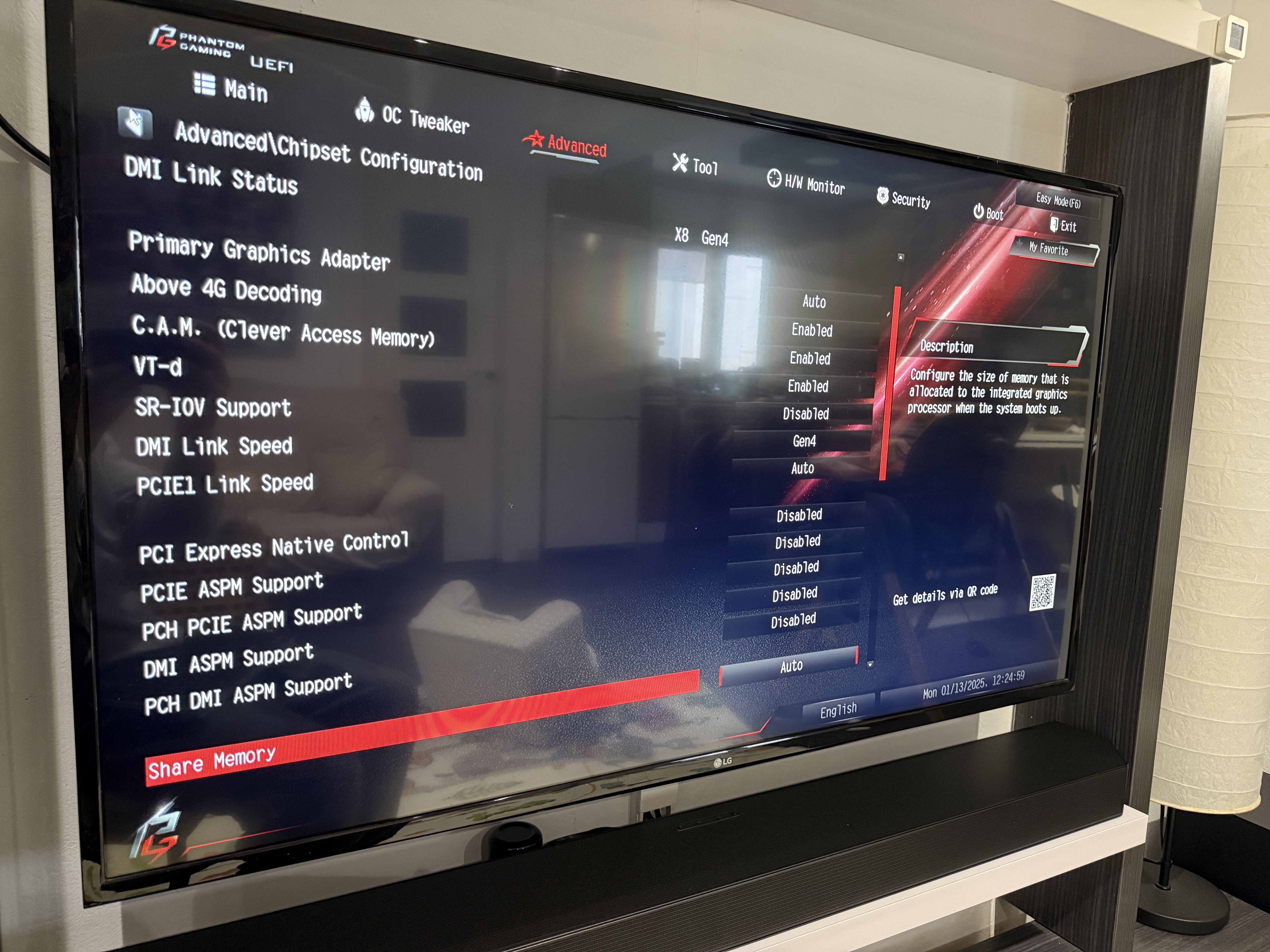

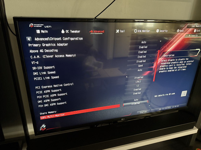

Hello, following this thread, to try to configure my new UnRaid in the best way.
It is about:
Intel 14500
Asrock Z790 ITX/TB4
64gb ddr5 ram
2 x WD SN850X nvme for cache
3 x Sata hdd for array
M2 x6 Sata ASM1166

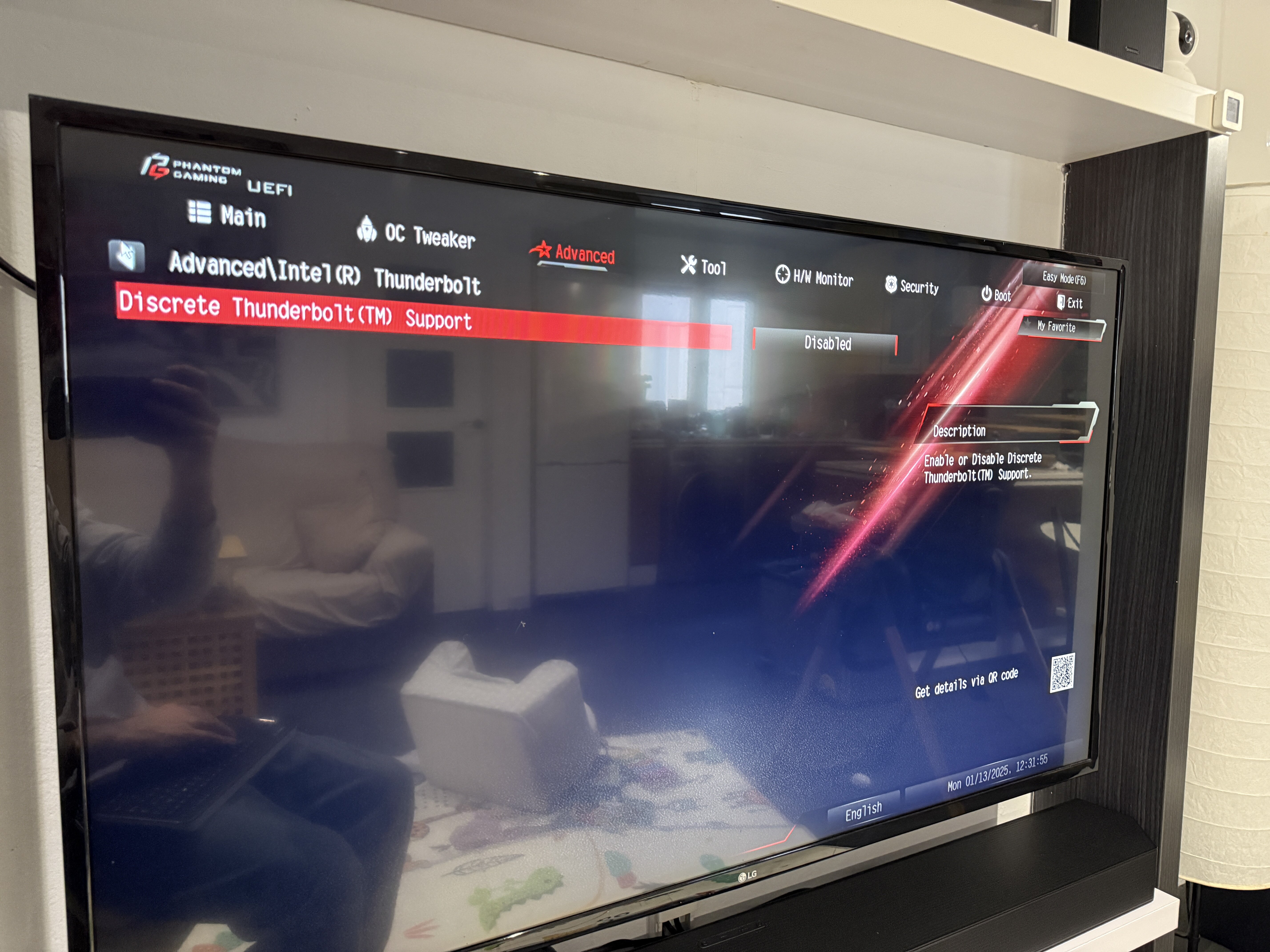

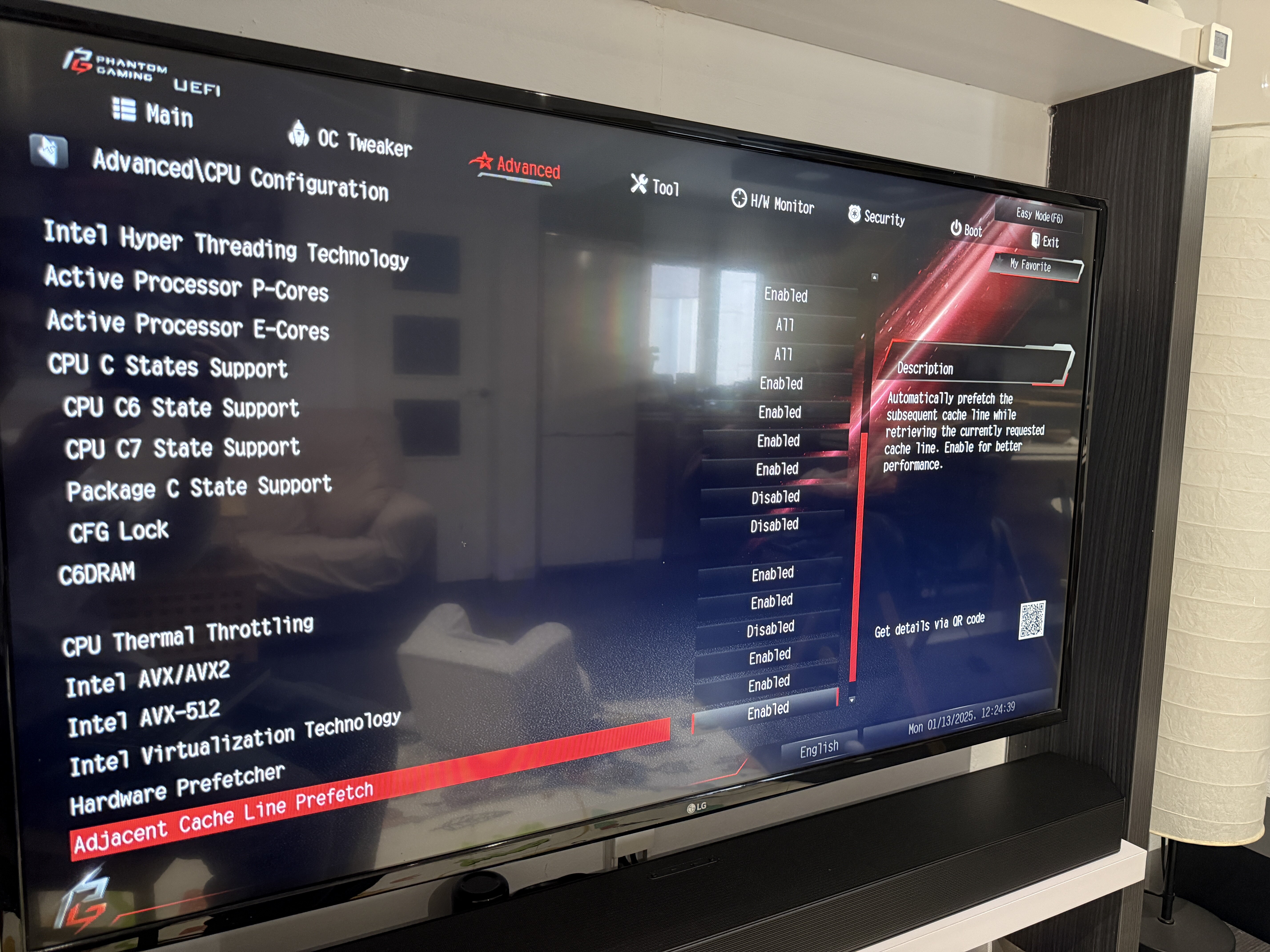

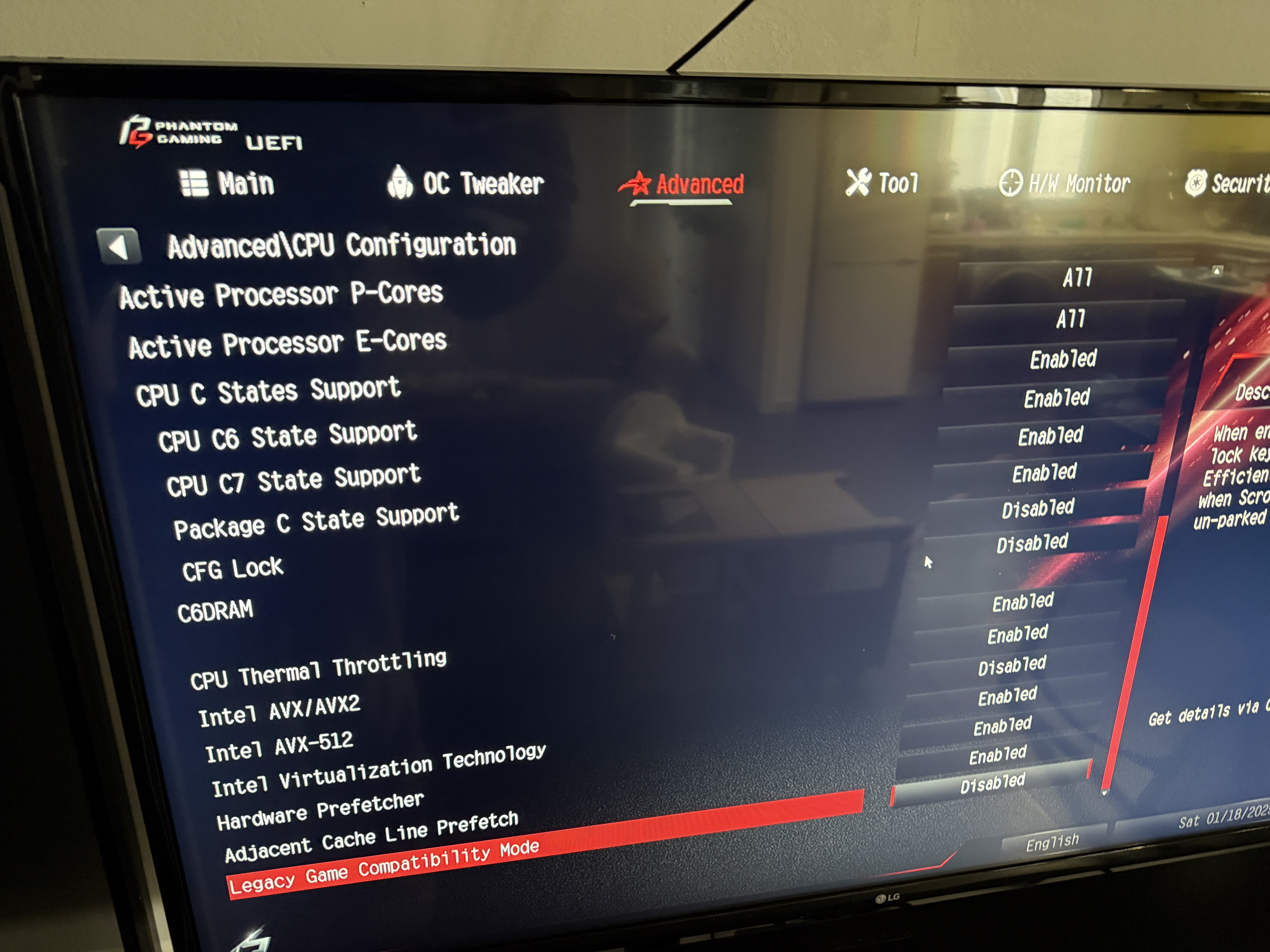

I have enabled all C states in the bios, I have also disabled thunderbolt4 (although it continues to appear in the list of devices despite being disabled) I have also disabled the sound card, wifi and some other things that are not used.
After starting UnRaid, I see C3 states on the packet, but after about an hour, UnRaid stops working (no local access to it or any of the virtual machines or dockers)
I will update with photos of the bios later so you can see my configuration and what I did wrong.
All the devices when listing them, I can see that they support ASPM, except these two:
 PCI bridge: Intel Corporation Thunderbolt 4 Bridge [Maple Ridge 4C 2020] (rev 02) (prog-if 00 [Normal decode])
                LnkCap: Port #0, Speed 8GT/s, Width x4, ASPM L0s L1, Exit Latency L0s <2us, L1 <4us
                LnkCtl: ASPM Disabled; LnkDisable- CommClk+
PCI bridge: Intel Corporation Raptor Lake PCI Express Root Port #21 (rev 11) (prog-if 00 [Normal decode])
                LnkCap: Port #21, Speed 16GT/s, Width x4, ASPM L1, Exit Latency L1 <64us
                LnkCtl: ASPM Disabled; RCB 64 bytes, LnkDisable- CommClk+
Thank you above all for your time and help.
It is about:
Intel 14500
Asrock Z790 ITX/TB4
64gb ddr5 ram
M2 x6 Sata ASM1166

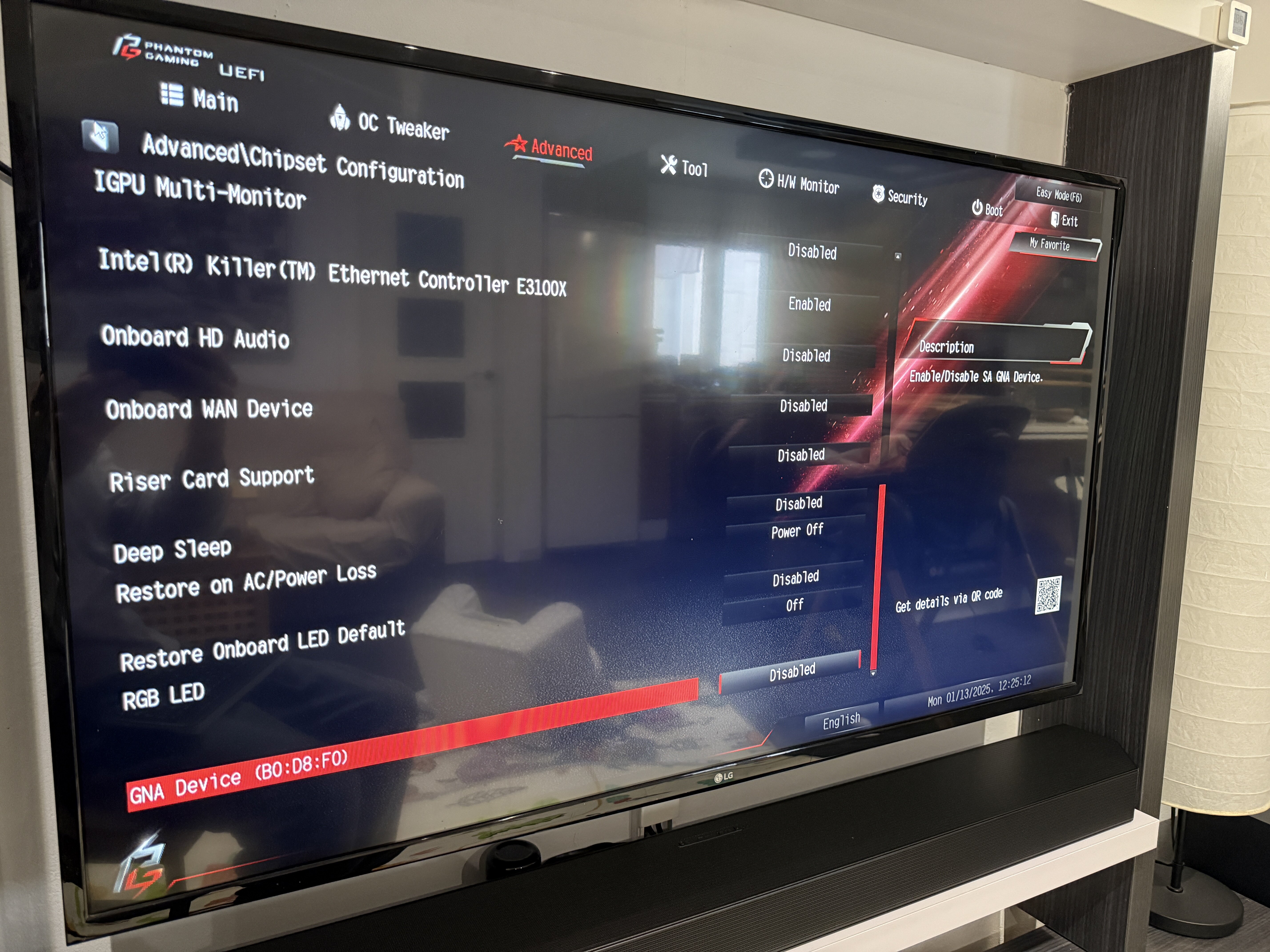

On 1/17/2025 at 12:22 PM, FlowDE said:
Did you tune with Powertop? Your Intel Networkcard won't support any energy savings and if you tune it with Powertop the System gets unresponsive.
https://bugzilla.kernel.org/show_bug.cgi?id=218499
Hello, thank you very much for your reply and information, I didn't know that the version of this ethernet is 226V, it only hangs if I activate C7 in the bios (if I enable all ASPM and C states except C7) everything is fine... But I only get to C3 in package and c6 in core (c2_acpi in cpu) maximum.
If I enable C7 in bios, I get to C3 in package, c7 in Core, C3_ACPI maximum.
So, I'm not very clear now, what is the solution to avoid it hanging with this 226V?
I didn't do anything additional in UnRaid (it doesn't matter if I run the command: powertop --auto-tune &>/dev/null or I don't run it) it hangs whenever c7 is enabled in the bios, it doesn't matter if I run that command or not.

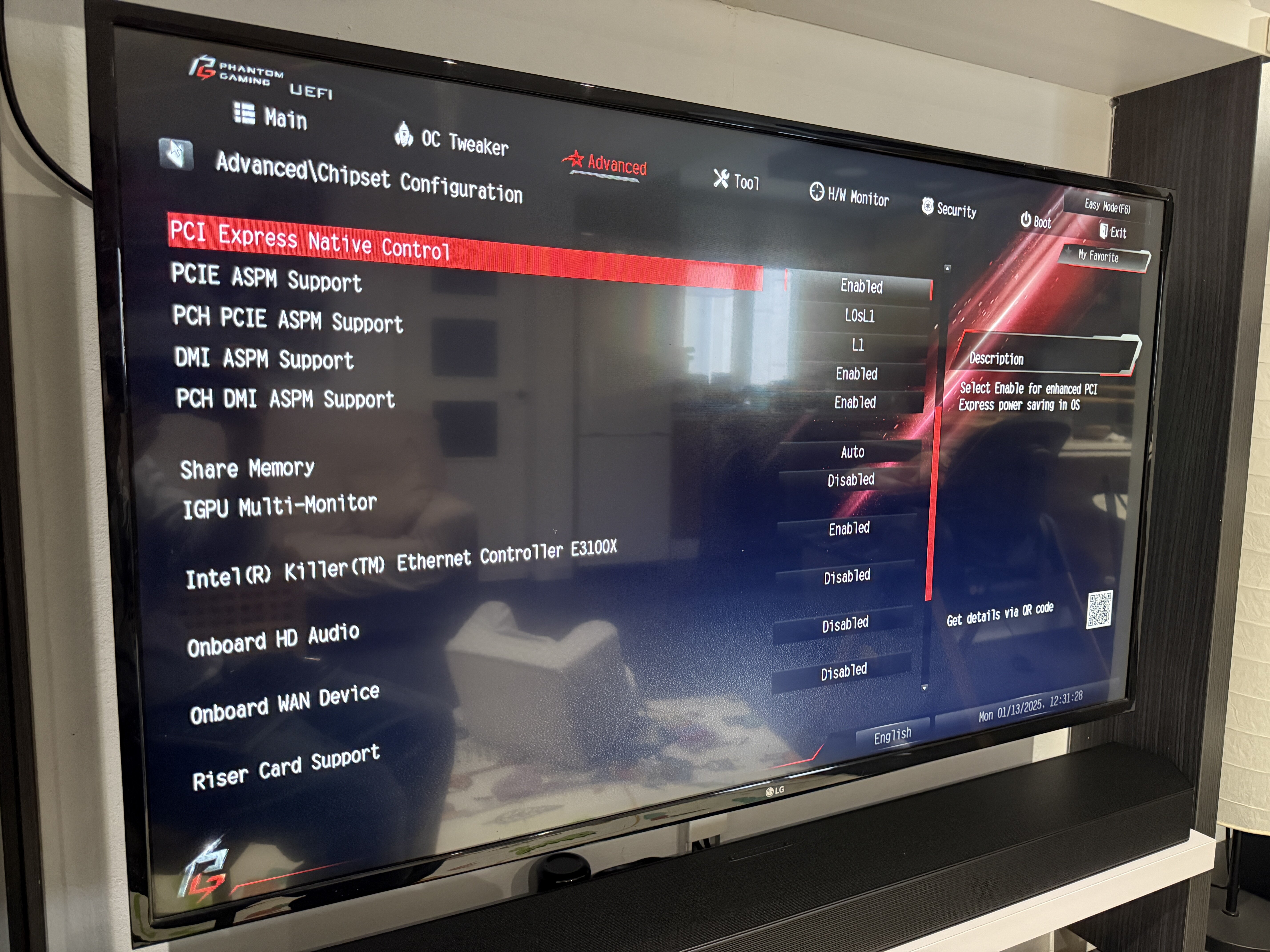

On the other hand: Should PCI EXPRESS NATIVE CONTROL be enabled or disabled?
In the motherboard manual it says that the network card is: E3100X 2.5G LAN
lspci:
09:00.0 Ethernet controller [0200]: Intel Corporation Device [8086:3102] (rev 04)
Edited by Nozle
2 hours ago, Nozle said:
E3100X 2.5G LAN
As this controller was released in 2021 it shouldn't be the I226V, but finally it could be still an issue with this controller or anything else on the board or... Did you update the firmware of the ASM1166? Older firmware versions had problems with deep sleeps states, but usually they didn't cause a system crash, "only" disconnected disks.

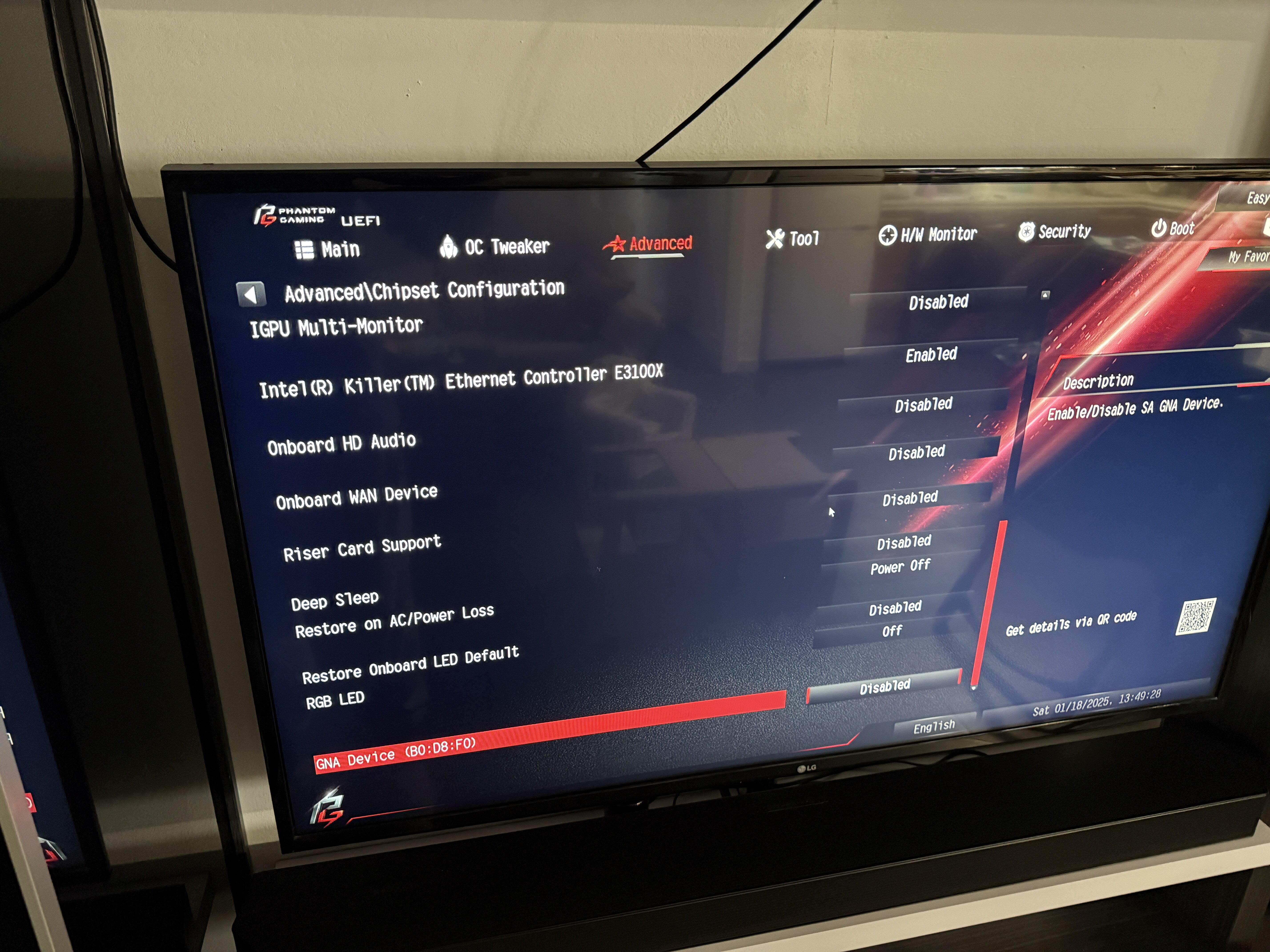

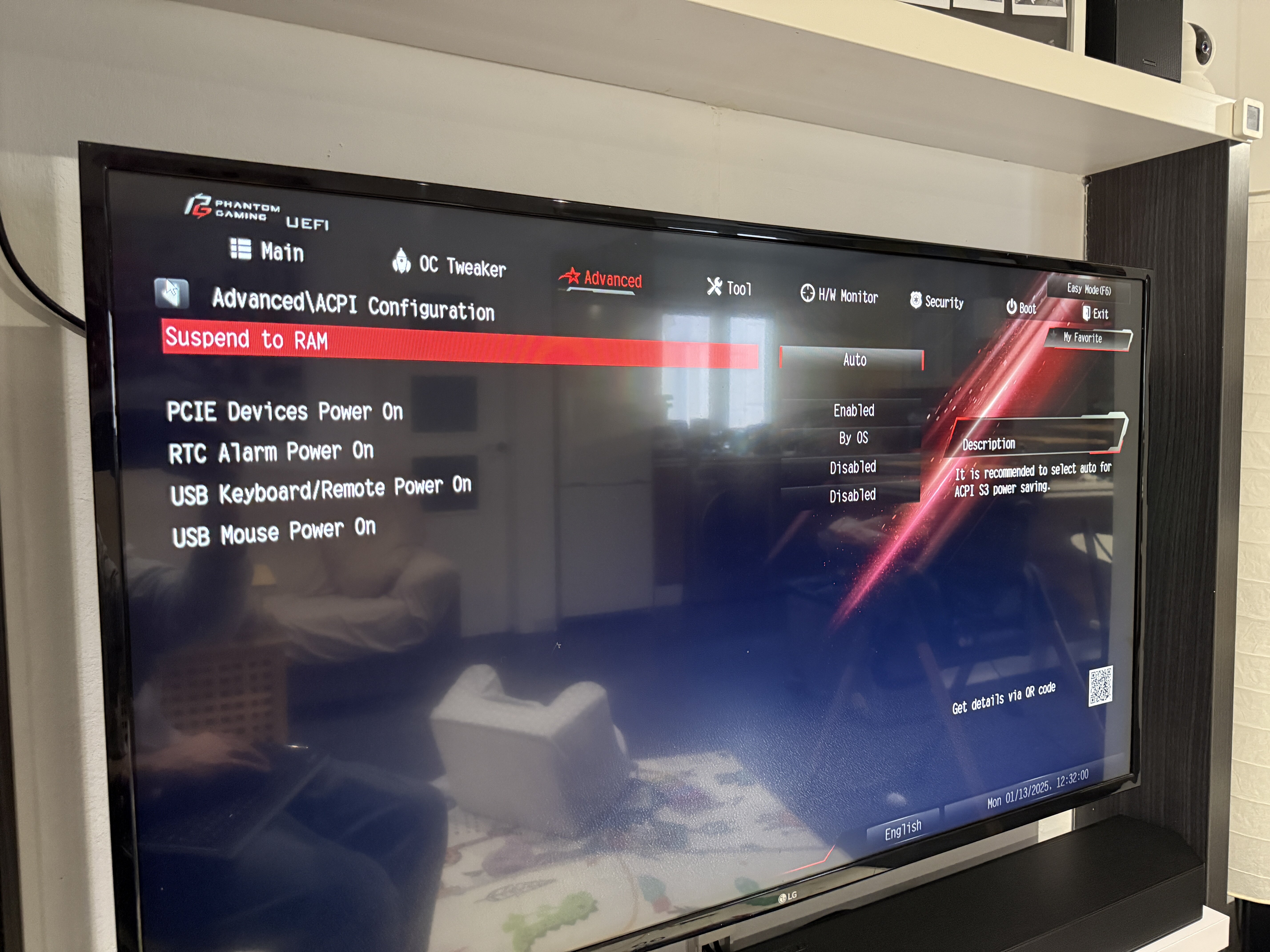

Yeah; The firmware was updated. Right now the bios is configured like this:
I haven't run autotune powertop, but the system hangs after about an hour. This is generating many parity errors for me.
unraid 7 is installed.
asm1166 no have disk connect (is update firmware)
Edited by Nozle
I tried without starting the array, and it worked normally for at least two hours (I restarted it to test with the array started), then it crashed again as usual (bios configuration as in the screenshots above)
The array is two NVME cache disks (one plugged into the chipset slot and another in the rear slot) and 3 8TB HDD disks
I run out of ideas if everything is configured correctly and if I'm doing it wrong or how to solve all this.
My parity every time the system hangs needs to be checked (12 hours) and found more than 1000 errors...

The bios configured as in the previous photos, and powertop autotune is not executed, the array is executed.
Edited by Nozle

If I don't enable c7 in the bios, everything is fine, the crashes appear when enabling c7 as in the photos above
PSU is Seasonic Focus SPX-650
Edited by Nozle
On 1/19/2025 at 11:07 AM, mgutt said:
This is strange. Are you able to login through local display / keyboard if it hangs (so "only" Network is dead) or is it really frozen?
Are you able to test the CPU on a different Mainboard?
I have tried a new 14500 and same problem here, it keeps hanging when enabling C7 in the bios (after about an hour)

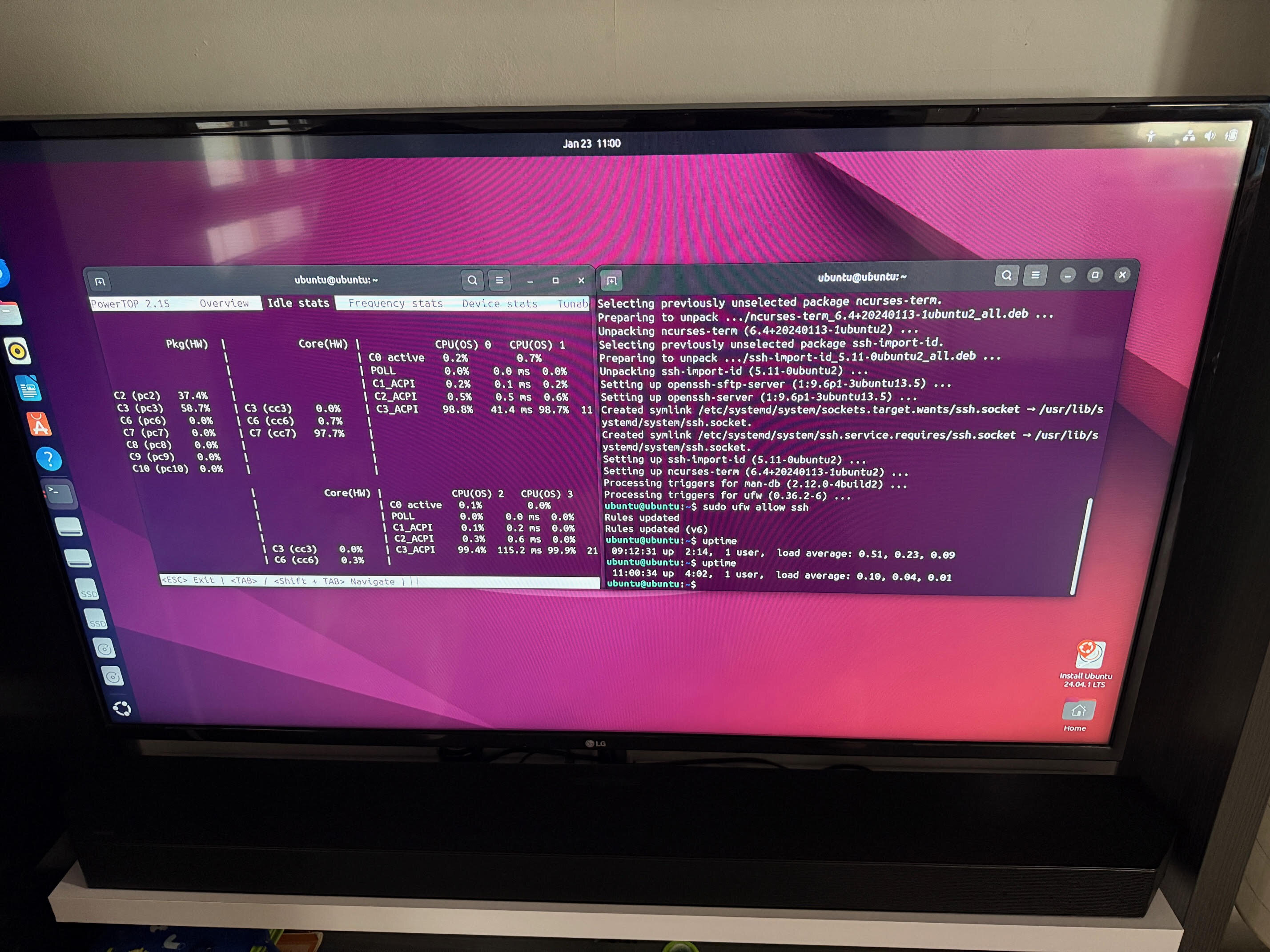

9 minutes ago, mgutt said:
Can you please try it with Ubuntu? Booting without installing from USB should be sufficient.
Sure, I'll try it! What configuration should I do? install powertop and run powertop autotune?
I was able to disable Intel LAN in the bios and get the same crash after an hour and a half.
As you said it crashes without powertop autotune, this shouldn't be necessary, but after 1-2 hours not crashing I would try it with powertop, too.
After approximately two hours with ubuntu live usb and powertop autotune running, it has crashed, I am now testing without autotune.

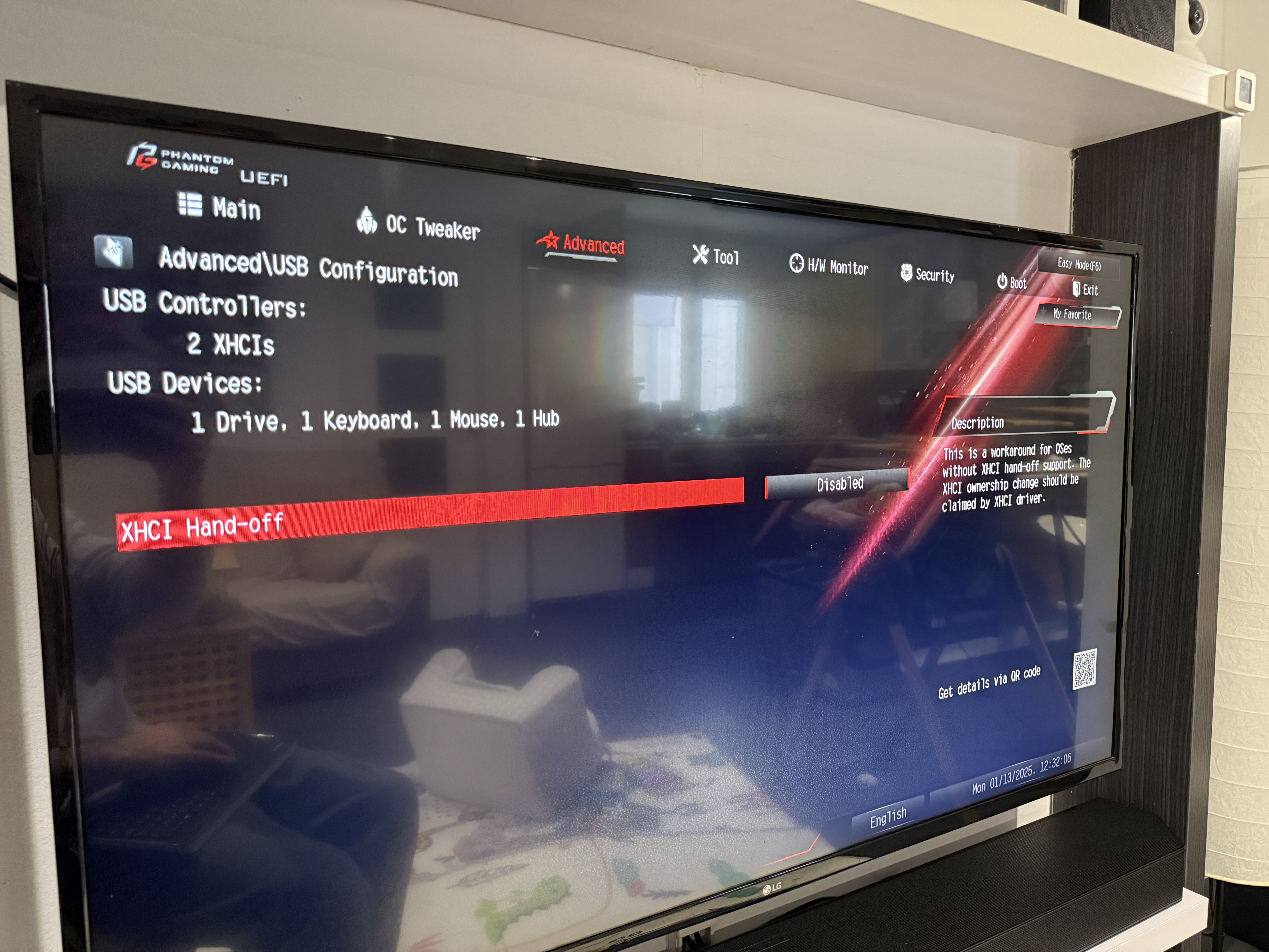

Update, now it has been 4 hours without crashes (ubuntu usb with powertop installed) without running powertop autotune.
