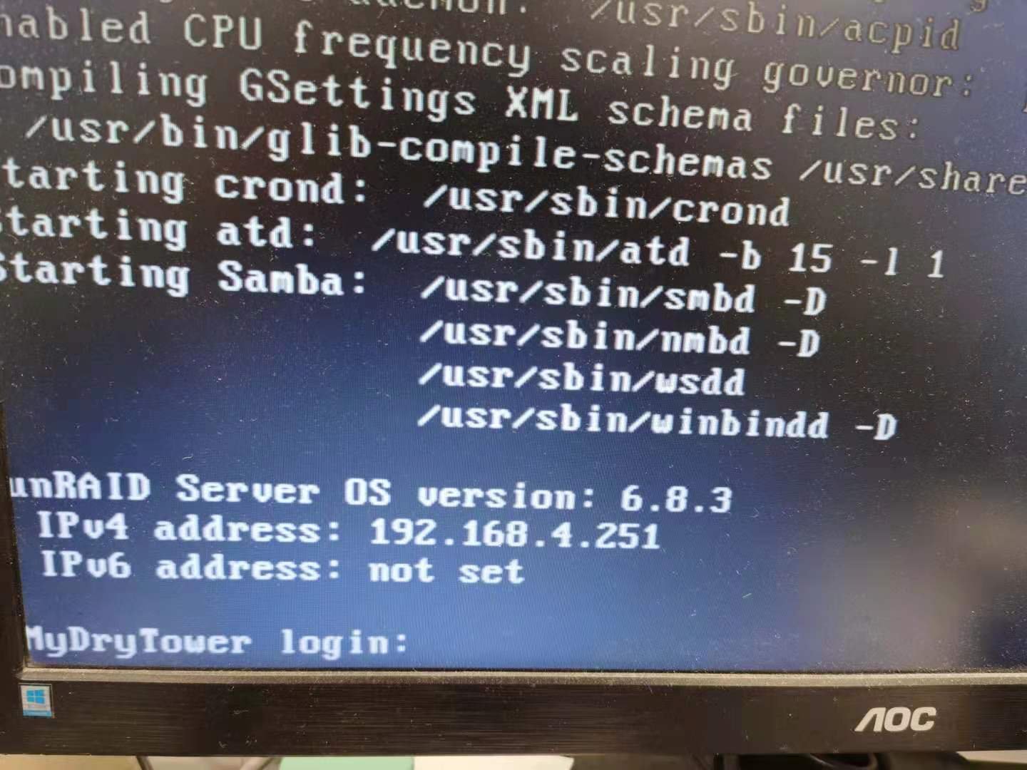

Decided to dive straight into beta 35 (from stable) with my backup server to get ahead of any issues I might encounter as my backup and main are configured very similarly.

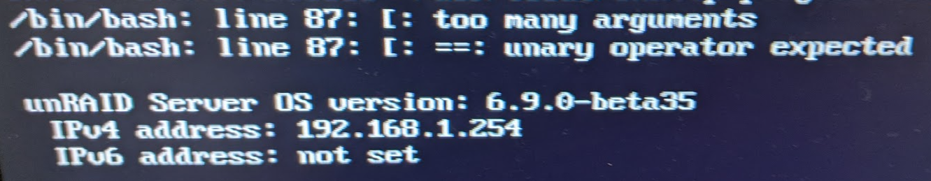

I've noticed two innocuous errors on the monitor attached to the server. They don't show up in the logs anywhere that I can find and there is nothing preceding or following them.
I rebooted into safe mode and those two lines don't appear. So it has something to do with a plugin, but I'm not sure how to go about figuring out which one. I poked through the beta threads and tried some searching but didn't see this mentioned anywhere else yet.
I haven't noticed any lost or broken functionality yet, so they appear to be harmless but I would feel better knowing where they are coming from and what if any damage it may cause.

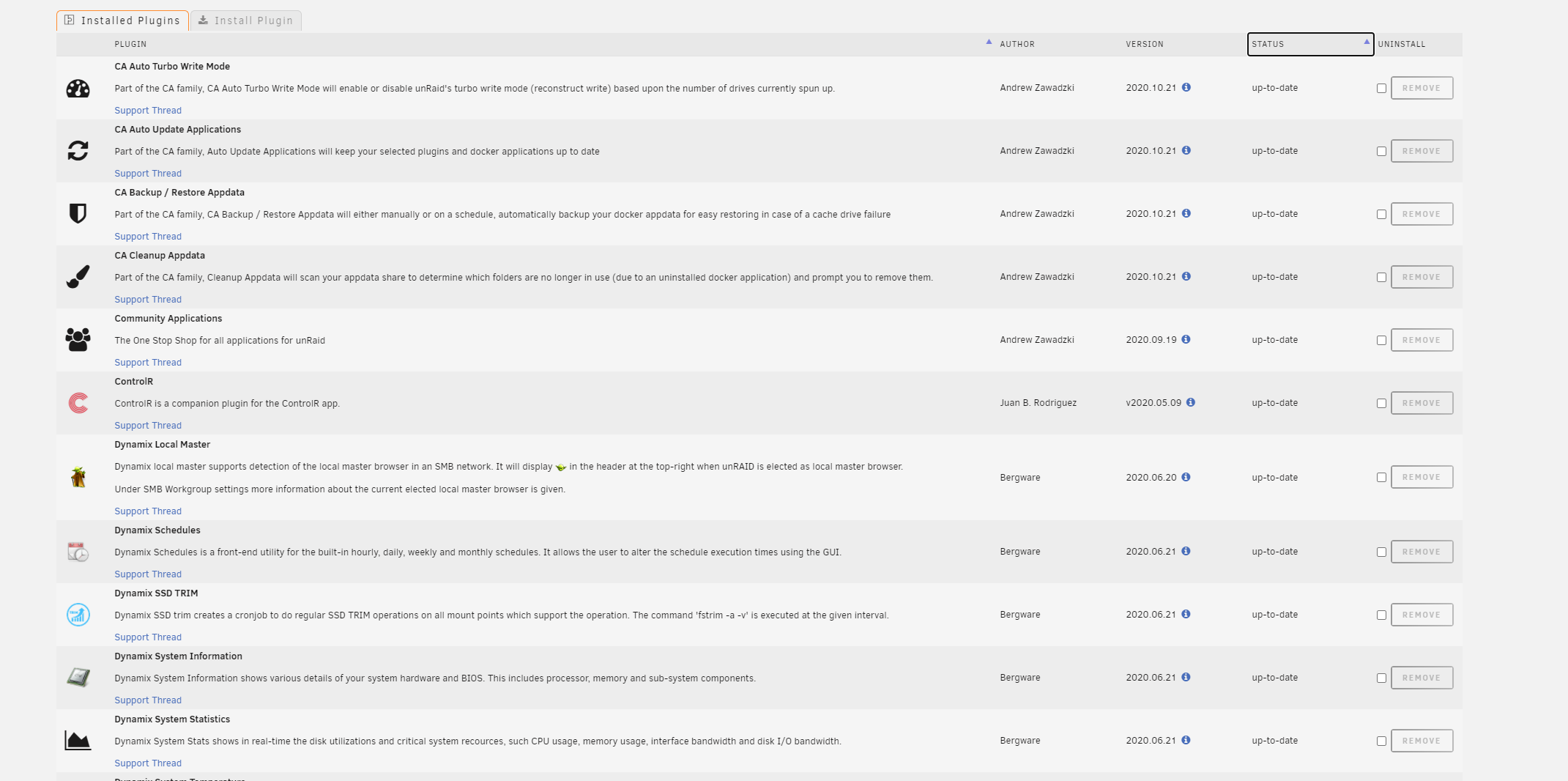

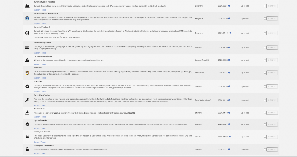

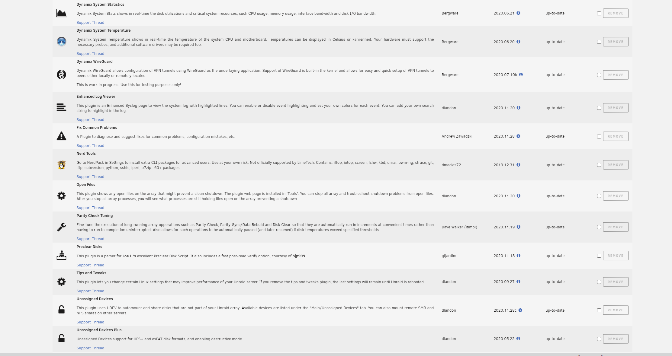

Looks like many of your plugins are not up-to-date. Take care of that and see what happens.

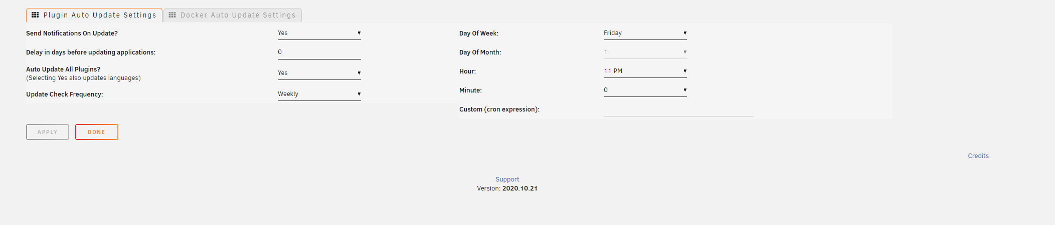

The update checker in UnRAID disagrees with you. I assumed I was all good. How do I tell which are out of date if I can't trust the updater?
EDIT: I even have automatic weekly plugin updates turned on in Squid's plugin.
Edited by weirdcrap
Looks like you're right, I just thought some of them should have newer dates than that.

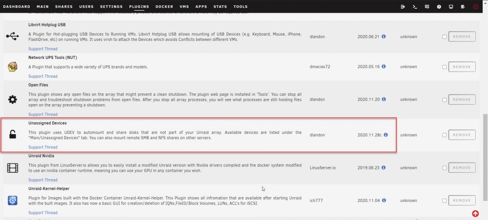

It's actually UD.  First time I've turned on my monitor in about a year and the same thing is there. @dlandon
Nice, how did you figure this out? Something in my diags?
That way that I did it was to look at all the .plgs within /boot/config/plugins and see which code section was long enough to hit a line 87 and then copied / pasted that section and saw that line 87 contained an ==, then uninstalled the plugin rebooted and saw the error didn't reappear.
The way most people would have done it is uninstall one by one followed by a reboot and see when the error disappeared.
Got it.  Fixed in the next release.

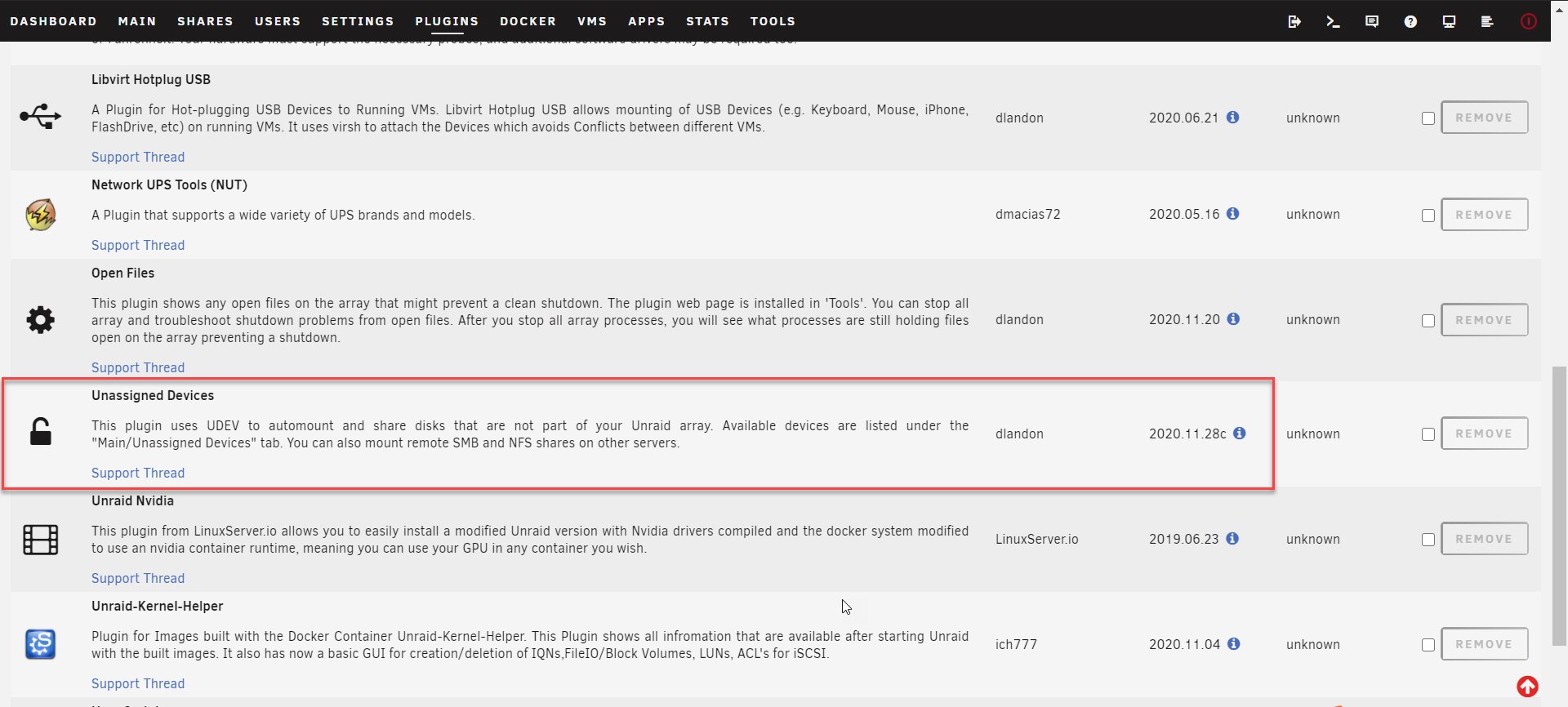

This may be a problem of "Unassigned Devices" 2020.11.28c, there will be no such prompt after uninstalling
