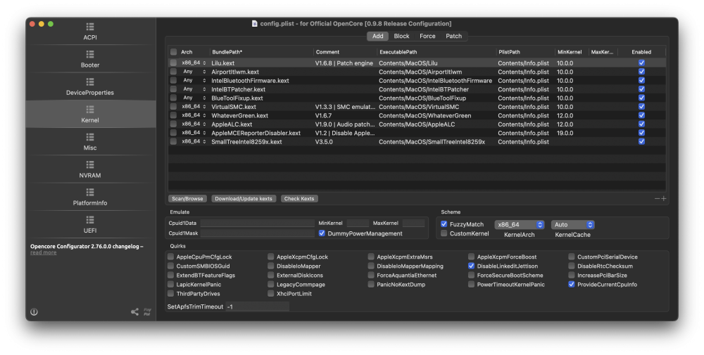

From my running macOS Monterey i've updated to Sonoma 14.3.1. With the help of @ghost82 I updated all the necessary OpenCore kext and config.plist to the newest version, replaced the old OpenCore image and was able to boot in Sonoma.

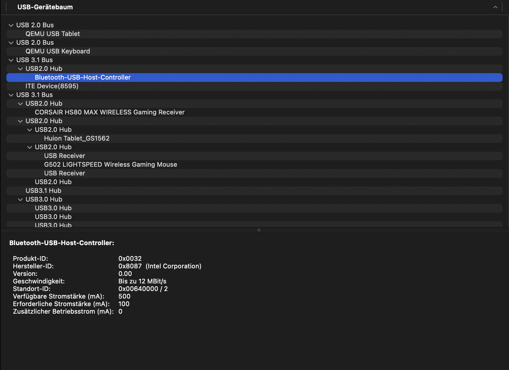

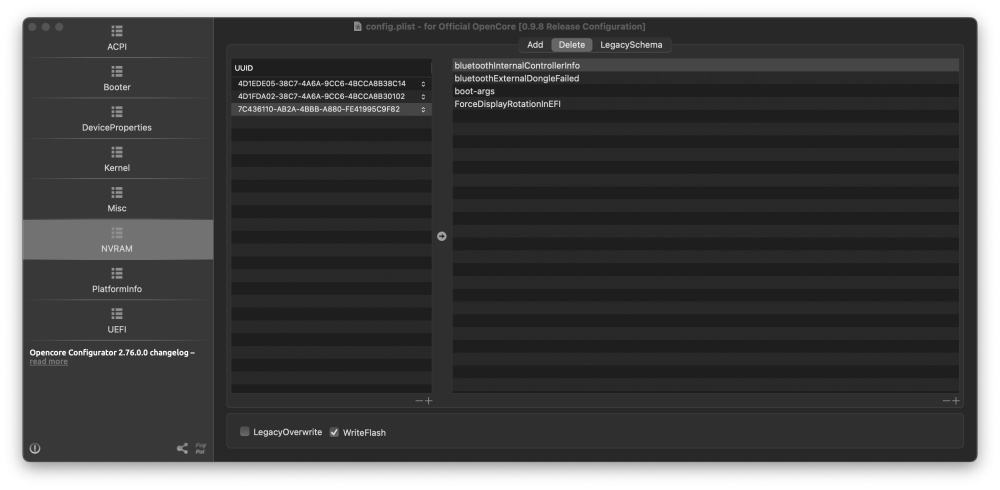

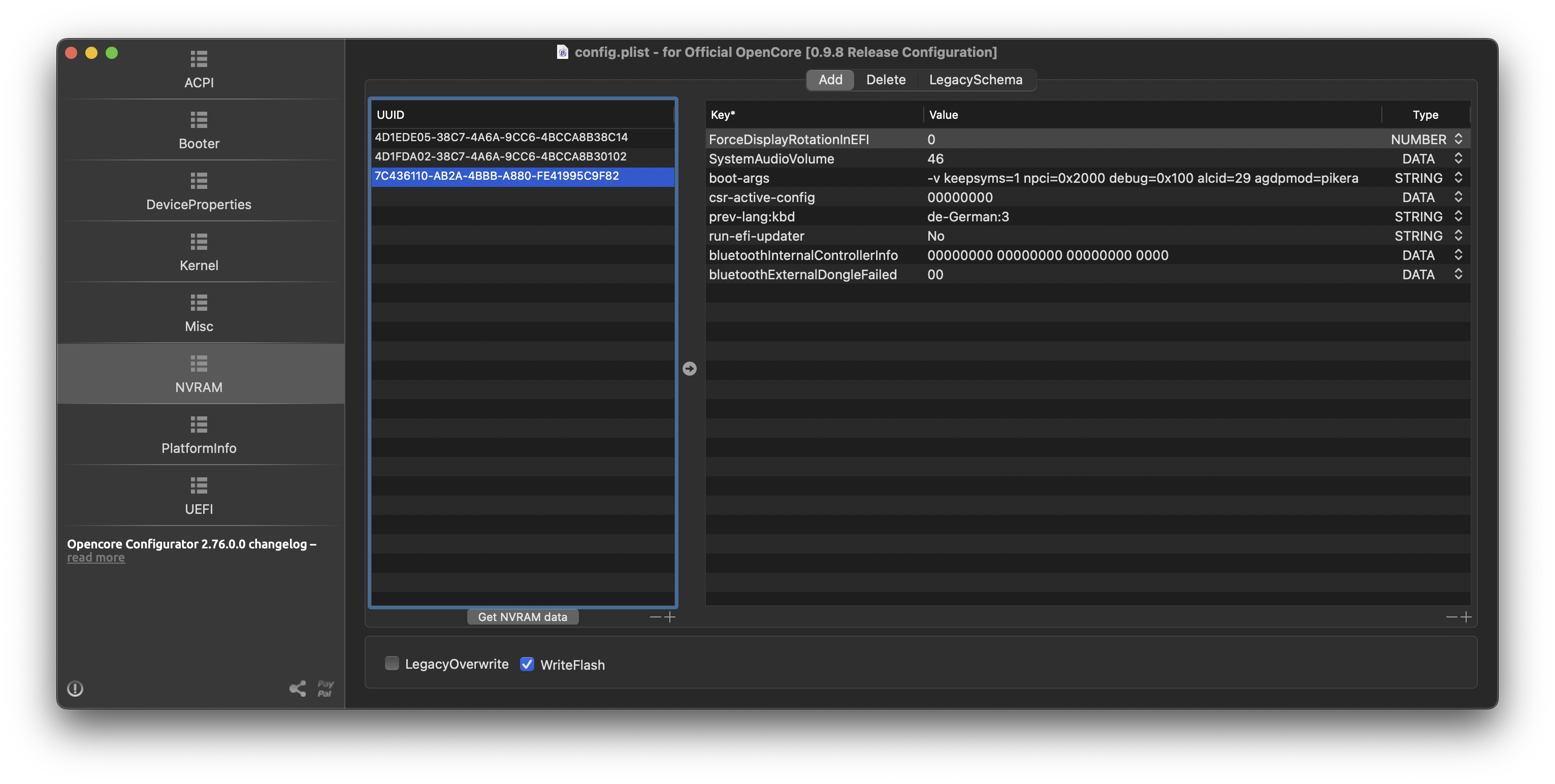

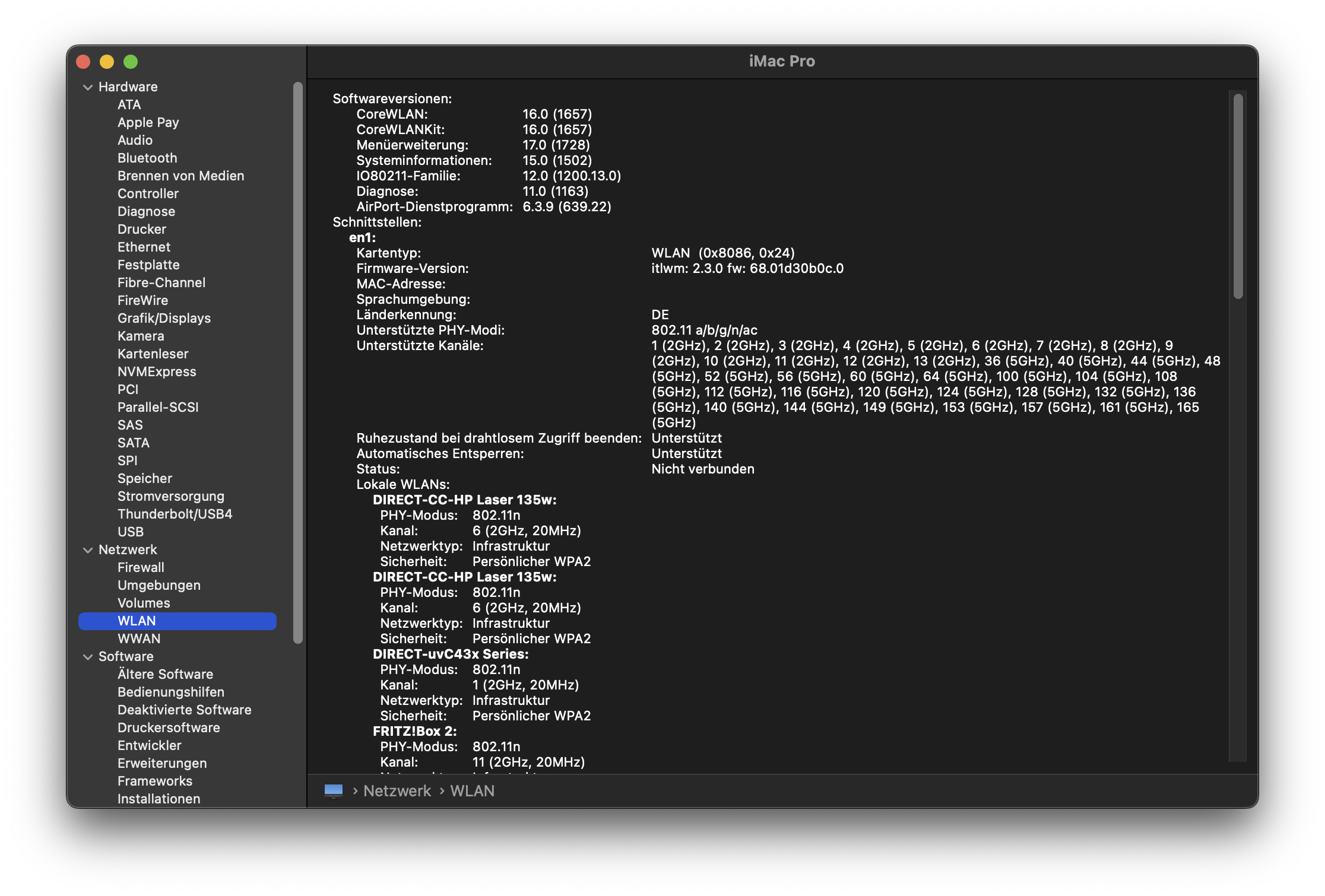

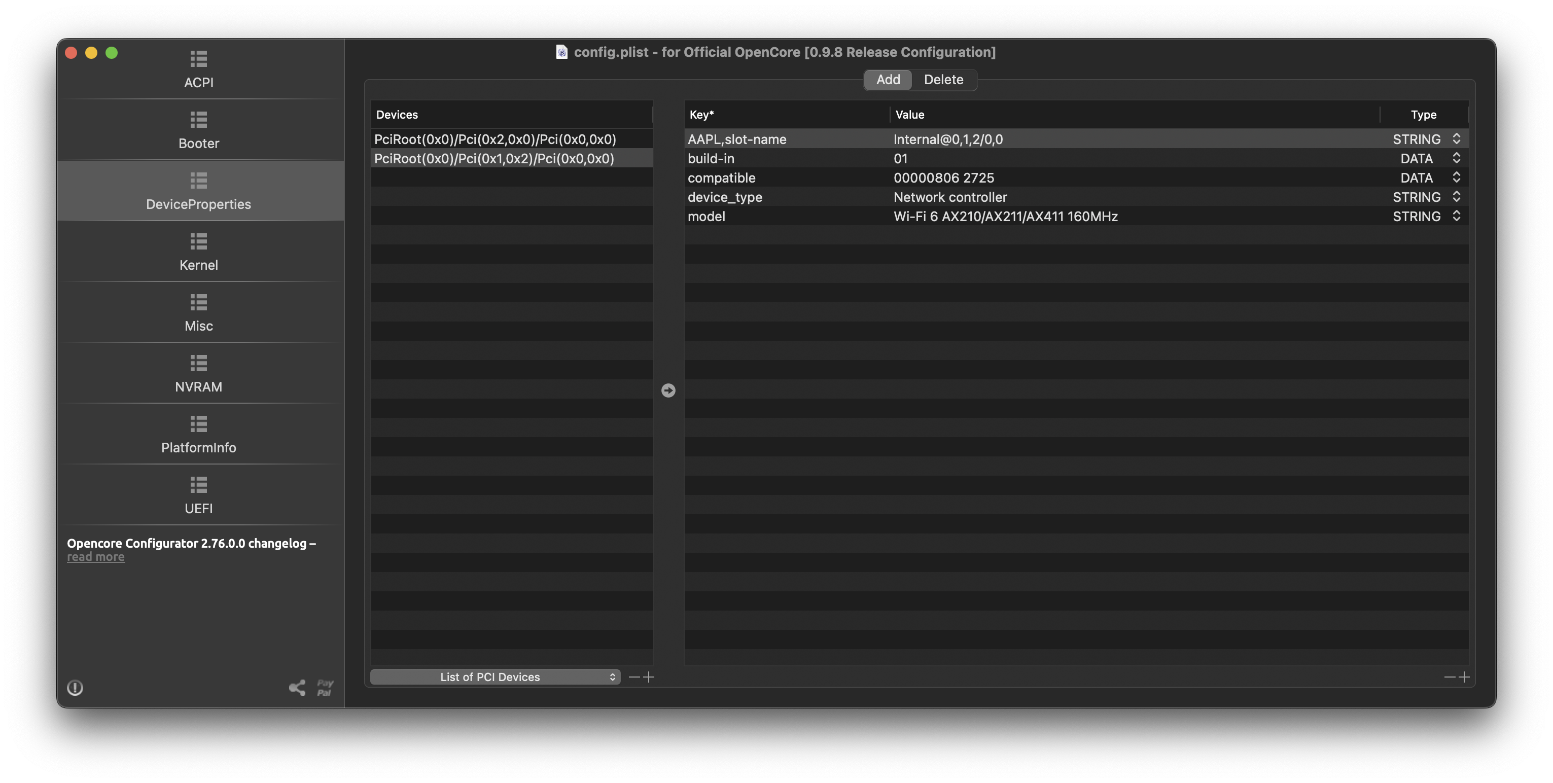

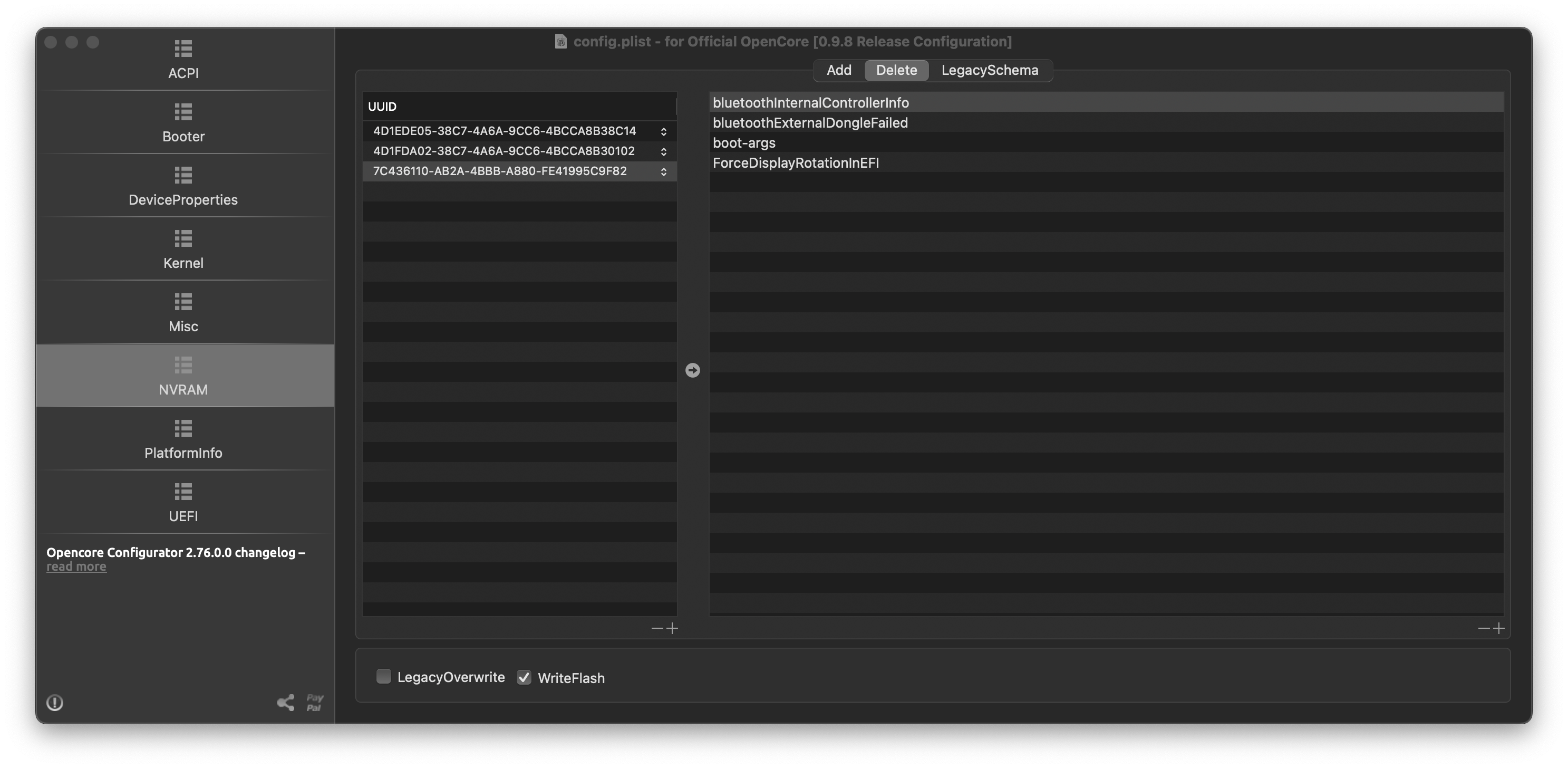

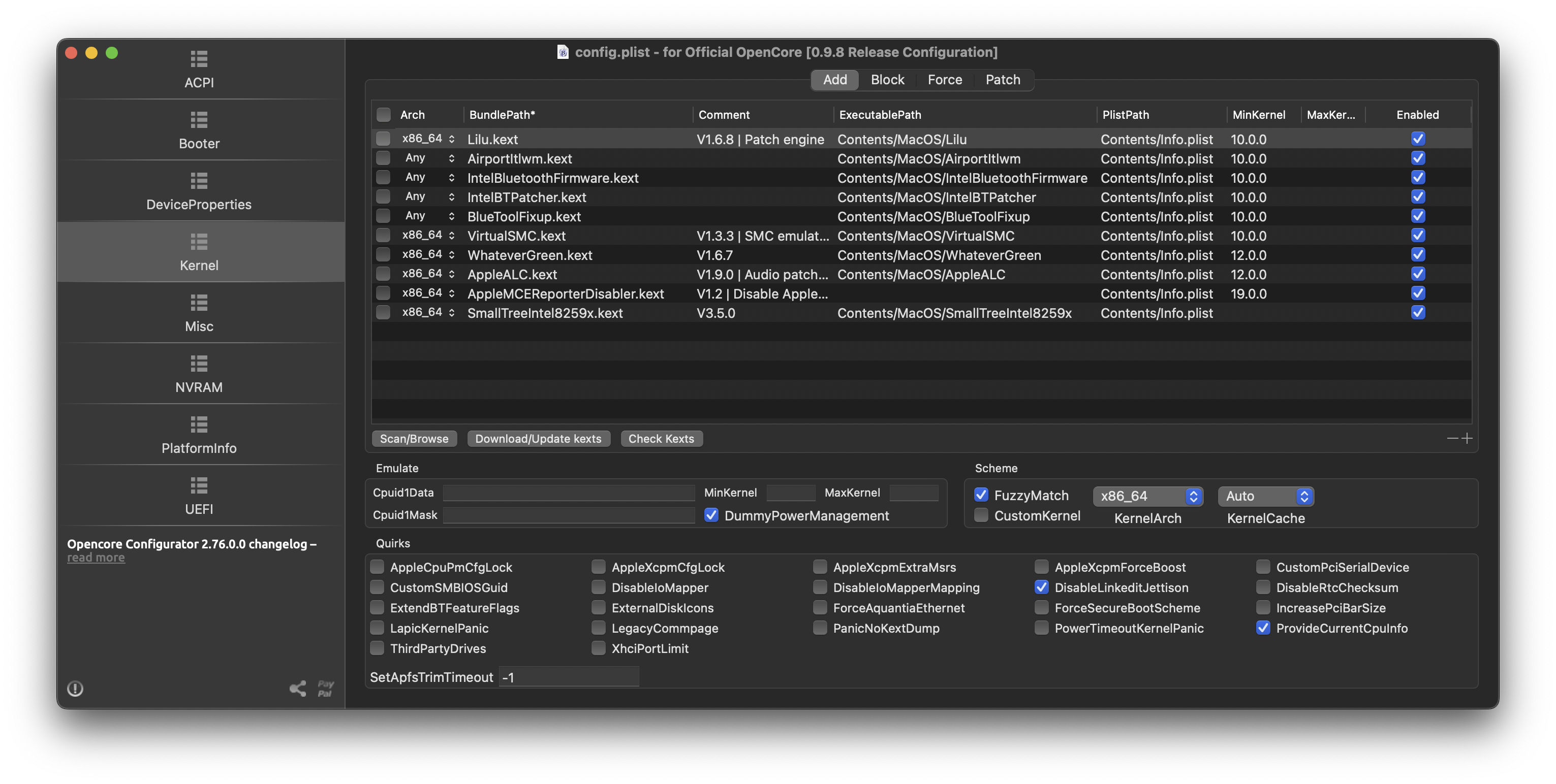

Thx for your reply! AX210,AX211, etc. eg. Cards working very well in Sonoma, regarding to this github: https://github.com/perez987/Intel-AX210-wifi6-on-macOS-Sonoma This is my card. Wifi is running with the kext linked on github above. So I guess that there is no Issue with passthrough of the card. The only part not working is Bluetooth. I am not sure what is wrong in my setup. I tried all possible kext kombinations, others reported as working. So far no luck here on Sonoma. I am currently on 14.3.1, I updated to 14.4Beta, to see if this fixes the problem, but now my macOS does not boot up anymore. Have to go back to my 14.3.1 backup. Not sure why 14.4Beta is not booting after the update.
03:00.0 8086 2725 8086 0024 Disabl Intel Corporation Wi-Fi 6 AX210/AX211/AX411 160MHz Network controller Network controller /pci8086,2725@0 pci8086,2725 PciRoot(0x0)/Pci(0x1,0x2)/Pci(0x0,0x0) Looking for a Wi-Fi solution that does not require disabled SIP (e.g. Intel AX210), I found this on Github. I bought a Wi-Fi 6 AX210/AX211/AX411 160MHz card from Amazon, and pass through the card into Sonoma: <hostdev mode='subsystem' type='pci' managed='yes'> <driver name='vfio'/> <source> <address domain='0x0000' bus='0x07' slot='0x00' function='0x0'/> </source> <alias name='hostdev6'/> <address type='pci' domain='0x0000' bus='0x07' slot='0x00' function='0x0'/> </hostdev> Then I prepared my OpenCore bootloader with all the necessary kext and config.plist settings. Boting in Sonoma, the Wifi Cardworks just fine: Unfortunately Bluetooth does not work and I am not able to pair any device. I double checked the kext, but as far as I see, I don't miss anything. Anyone else out there who tried Intel Wifi/BT on Sonoma and had also success with Bluetooth? I used this three kext in EFI/OC/Kext: IntelBTPatcher.kext V2.4.0 IntelBluetoothFirmware.kext V2.4.0 BlueToolFixup.kext V2.6.9 And I deleted: BrcmBluetoothInjector.kext form EFI/OC/Kext. This should be basically enough to get Bluetooth up and running, but here it dont. Any Idea? What am I missing out? I guess the passthrough has no errors, as my Windows 10 runs flawless (wifi and Bluetooth) with the same XML code I posted above. Help would be nice!

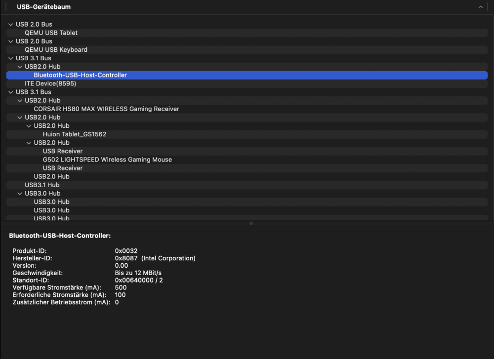

No need for sorries! 1) The dongle is a regular usb dongle. I connect it via USB - USB-C adapter to the USB-C port of my board, as this was the only way to get it working. 2) yes, the headset can run wireless and via cable. and yes, connects fine both via dongle and usb cable to the usb c port. I am not sure if the usb-c is part of the matisse controller. Copy of my IOMMU groups attatched. Best would be if it could work on any other USB port (hub or board manually or with usb plugin manager). If the dongle is connected via USB-C (working) it shows up as this device. If the dongle is connected on the hub which is passthrough (not working) it looks like that (it sorts in one cat deeper in the usb tree). The device is listed as: CORSAIR VIRTUOSO SE Wireless Gaming Headset: Produkt-ID: 0x0a46 Hersteller-ID: 0x1b1c (CORSAIR MEMORY INC.) Version: 0.00 Seriennummer: 142b6156000700da Geschwindigkeit: Bis zu 12 MBit/s Hersteller: Corsair Standort-ID: 0x06311000 / 16 Verfügbare Stromstärke (mA): 500 Erforderliche Stromstärke (mA): 500 Zusätzlicher Betriebsstrom (mA): 0 IOMMU.txt
1) The headset (dongle and connection via usb cable) works fine out of the box on a real mac without any additional software. 2) The headset (dongle and usb cable) does not work on any usb port which is passed through exclusivly on that port. 3) The headset (dongle and usb cable) does not work on any a onboard controller port which is passed through vfio IOMMU group. In my case this is a AMD Matisse USB 3.0 Host Controller | USB controller (09:00.1). On this controller I use a usb hub. The headset also does not work on any of the hubs ports. 4) The headset (dongle and cable) does work out of the box on the USB-C port of the mainboard. I did not configure this usb-c port extra via vfio iommu. My guess is, it belongs to the AMD Matisse USB 3.0 Host Controller. 5 ) The headset does not show up at all, while I trying to attatch it via usb plugin manager. It shows as connectet via plugin interface, but the device does not pop up under MacOs sound settings. Not works means: If connected on both sides, meaning mic and sound are activated in sound settings, the headset does not work. Sound stutters, also recording. When only one part is active in sound settings, the single selected function works just fine. So if sound is on and mic not selected, sound works. Also vice versa, if headset sound is off, speakers on and headset mic is selected for recording, it records just fine. It seems that there is a problem to seperate the two funtions sound and recording.
Very good point! This specific USB Dongle from Corsair indeed has a kext which installs into /L/E via Corsair iCUE Software. There is a <key>idProductArray</key> in info.plist and <key>idVendor</key> <integer>6940</integer> for Corsair itself. I packed the kext down below. But on my Macbook Pro, where no Corsair iCUE Software is installed, the kext is missing and the Dongle works out of the box with MacOS. You think I should give it a try and put the kext into opencore to inject from there rather then /L/E and see if this changes anything? I guess this specific kext has nothing to do with the function of the headset and dongle. CorsairAudio.kext.zip
Did you find a solution for this problem? I also use the Corsair Dongle for a Headset which does not work with the USB Manager Plugin at MacOS. Bit it looks like it is not a Dongle connection problem, cause the same behaviour shows up while connectet via USB cable. I am able to attatch it to the VM, but the device does not show up under MacOS. The dongle only works on Mac at the USB-C Port of my mainboard which seems to be internaly connected with this USB Host controller: It works exlusivly while conneted via this single USB-C Port (sound and mic without any flaws). Directly connected to the HUB I use at this USB Host controller Headset sound is working, but mic is quirky and records with gaps and hickups. When I go to the mic prefs in system>audiopreferences every Video I play starts to stutter. Headset sound alone works fine at all, while mic is off. Under Windows VM Dongle and cable are working without any problems while Headset is attatched via USB Manager Plugin. My Board is a 570Z Aeorus Pro. Any Ideas how to adress the problem under MacOS?
