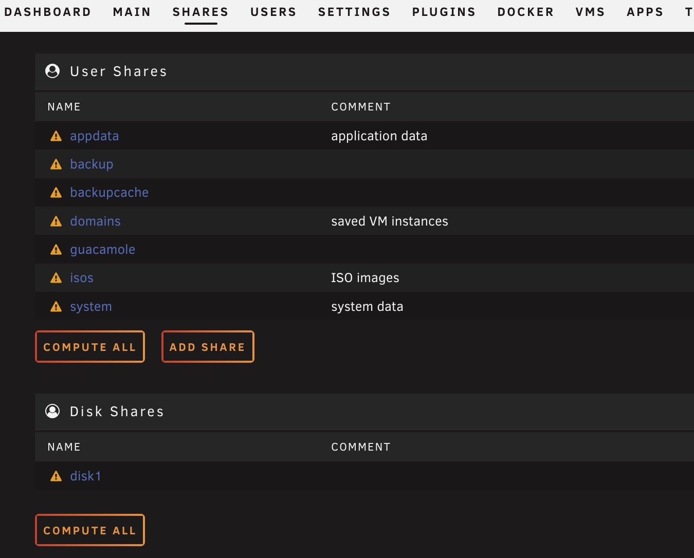

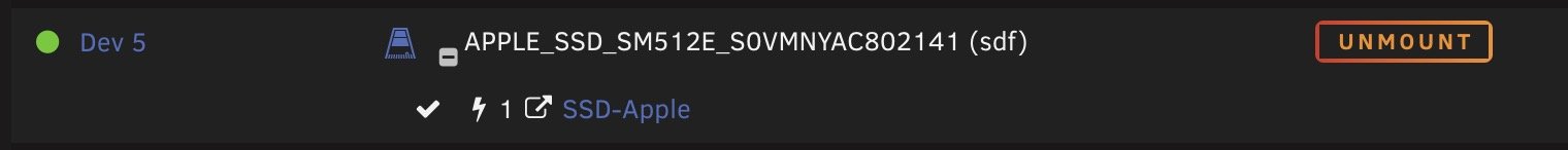

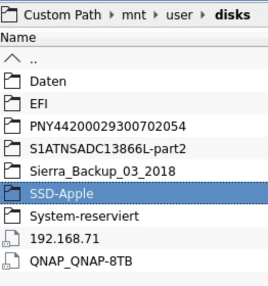

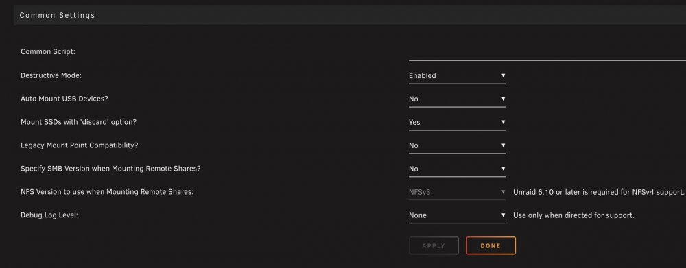

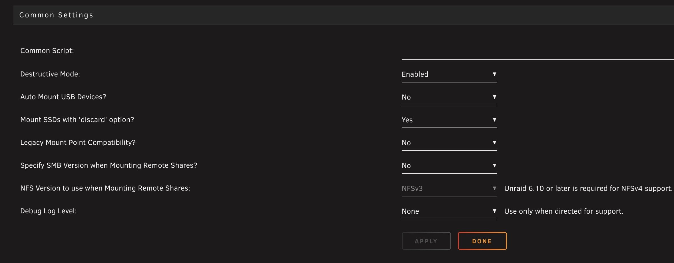

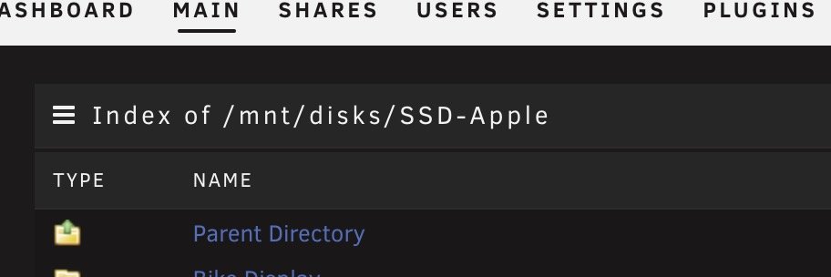

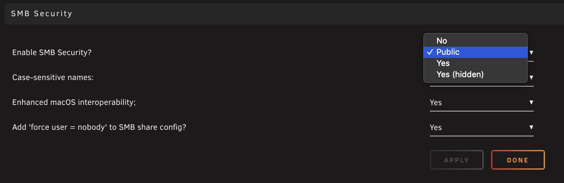

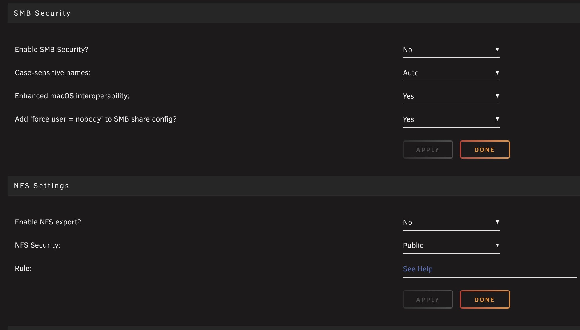

I did not set the 'No' to 'Public' as I thought 'No' ment no security and public access which is oviously not the case. Switching to public did it! Thanks a lot for guiding me through this!
I have a problem with the UD plugin, not beeing able to mount any of my Unassigned shared Disks from /mnt/disks aka /mnt/remotes under windows and MacOS. Under Unraid, via browser I can open them up. I am not sure how to get access to /mnt/shares as I think I switched everything needed on under settings. Via Krusader, I see everything (screenshots att.) Any help?
