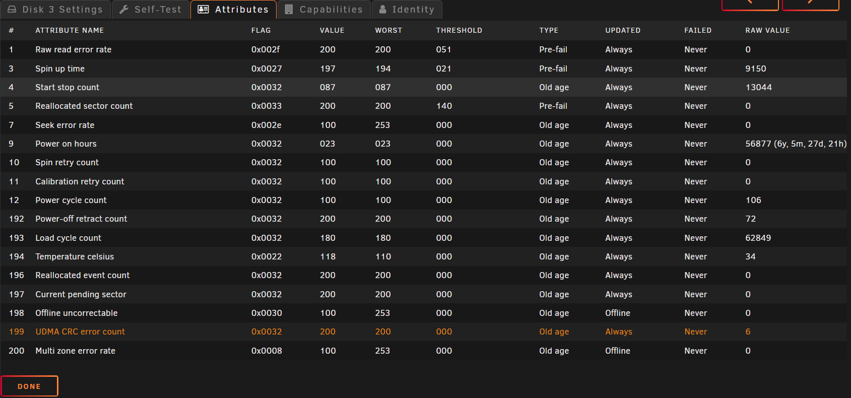

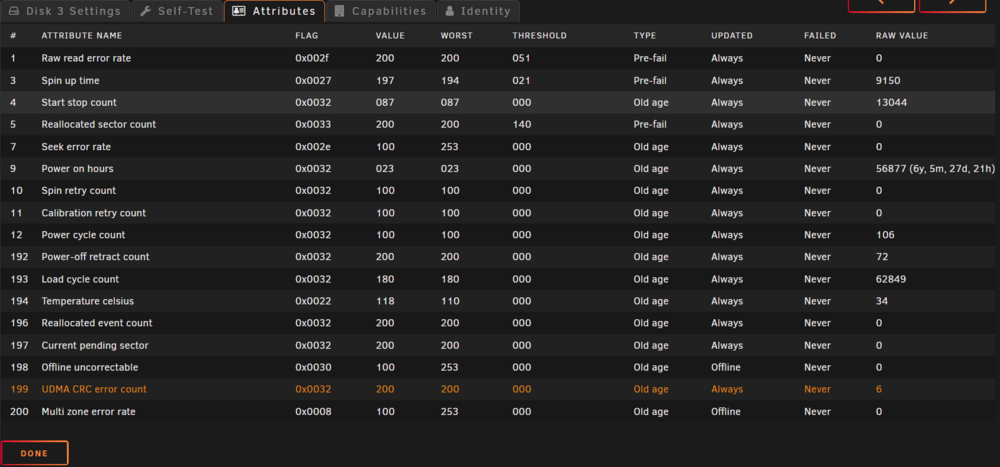

  2. I have a 6TB Drive that is starting to show signs of failure. I want to replace it with an 18TB drive. My plan was to Replace Parity 2 with the 18TB drive and then use the 12TB to replace the 6TB however it looks like I may need to replace the 6TB first. What is the best option. remove the 12TB as the parity and then make the 12TB the replacement for the 6TB Parity WDC_WD181KFGX - 18 TB (sde) Parity 2 WDC_WD120EFAX - 12 TB (sdf) Disk 1 WDC_WD100EFAX - 10 TB (sdh) Disk 2 WDC_WD100EFAX - 10 TB (sdg) Disk 3 WDC_WD60EFRX - 6 TB (sdc) <- Starting to go UDMA CRC error count 6 Disk 4 WDC_WD120EFBX - 12 TB (sdd) Disk 5 WDC_WD120EFAX - 12 TB (sdb)
