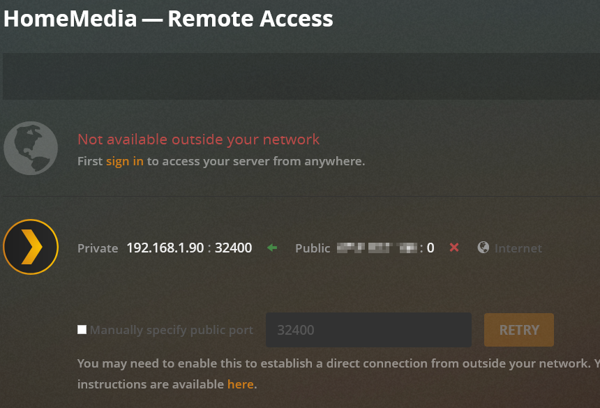

  18. Disable the firewall, Setup port forwarding, enabled NAT and UPnP. Attached the Plex log, Basically its says cannot use loopback adapter 127.0.0.1 and is unable to reach plex.tv but it is able to resolve the IP When I was running this on a windows box, I didn't have this issue. Is there some UnRaid Firewall that is causing the issue? Plex.log
  19. I understand that but any idea on why Plex still can not connect to the internet? It see this external IP just fine, but I am unable to claim the server
  20. I am having the same issue. I tired installing binhex/arch-plexpass by binhex to see if it was an issue with the other container but same issue I tired plexinc/pms-docker by plexinc and it has the port mapping correct [IP]:[PORT] but when running it is unable to access the network as well. I disable my routers firewall (temporally) But same issue it was unable to connect to the internet. Using binhex-qbittorrentvpn with the mapping 172.17.0.2:6881/TCP192.168.1.90:50000 172.17.0.2:6881/UDP192.168.1.90:50000 172.17.0.2:8080/TCP192.168.1.90:8080 172.17.0.2:8118/TCP192.168.1.90:8118 And no problems.
