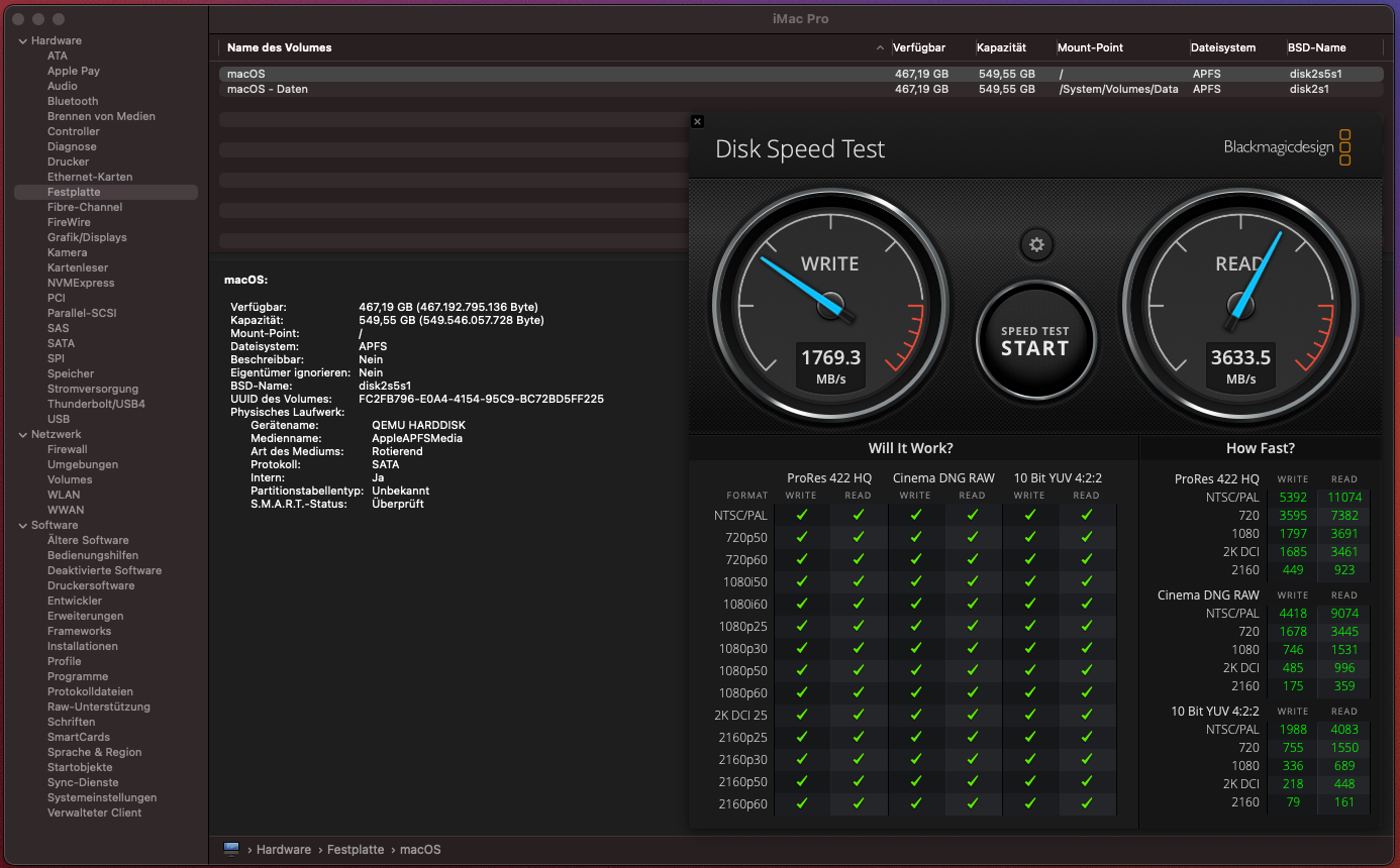

Hi @ghost82... The 1,5 Gbit indicated in the system overview of macOS are not relevant. Here is a benchmark with my image, stored on an nvme:

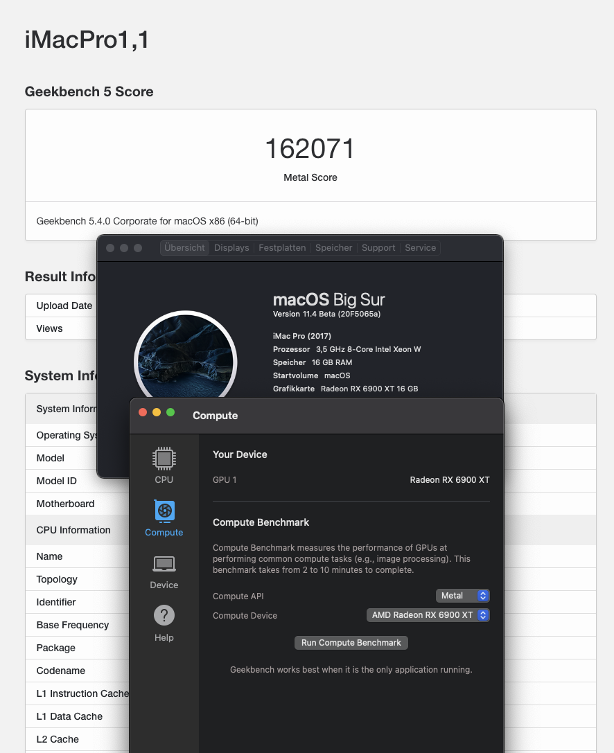

Hello guys!! Just wanted to share something with you. I tested a 6900xt in macOS Big Sur 11.4beta. Metal performance is outstanding:
