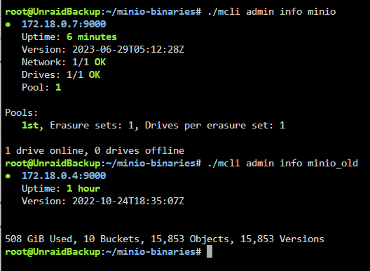

  21. Ok got it. That's a day I'll never get back but at least I'm back on the latest branch of minio/minio First you have to make the bucket on the new S3 instance then you have to copy over the bucket contents. mc mb minio/bucket mc cp --recursive minio_old/bucket/ minio/bucket/
  22. PAIN! I got this far. What are the commands to copy buckets from 'minio_old' to 'minio'?
