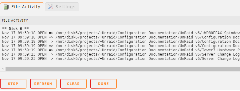

  2. Items will be added to the display for several days. Then, no additional items will be added till I press clear.
  3. Is there a way to increase the display buffer? Thanks
