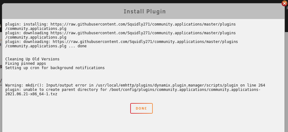

After replacing with a fresh flash drive - it appears to run normally. Only issue is and error replacing the pi-hole app. Appears to be returning an error from prior config.

UPDATE - solved with new flash drive. Folks: I posted in the General Support forum, but realized it may be more useful here. Long story short, after a upgrade to 6.9.2, I ended up doing a fresh install. Trying to reinstall CA, I am receiving the following error. Anyone help? I also have several errors showing in the docker section of the dashboard. Warning: parse_ini_file(/boot/config/docker.cfg): failed to open stream: No such file or directory in /usr/local/emhttp/plugins/dynamix.docker.manager/include/DockerClient.php on line 50 Warning: array_replace_recursive(): Expected parameter 2 to be an array, bool given in /usr/local/emhttp/plugins/dynamix.docker.manager/include/DockerClient.php on line 50 Warning: parse_ini_file(/boot/config/domain.cfg): failed to open stream: No such file or directory in /usr/local/emhttp/plugins/dynamix.vm.manager/include/libvirt_helpers.php on line 478

work in progress. Good news is that I was able to recover the drives after some trial and error in the config file. (I thought I had it running, but the array would not start). Ultimately I did a clean flash install with the existing flash drive. Appreciate the help. Remaining issues: 1. For some reason, the license is MIA. I thought I copied it to the config file. (Same flash drive as before). This could be user error. 2. A lot of weird docker / plug in errors, and Community Applications cannot be loaded even with the fresh install. (The only plug-in I had loaded was Pihole). 3. Is there an easy way to assign a new fixed IP? The box grabbed a random IP when it finally booted - so now I have to remap all my other computers. The IP info is grayed out in settings. If someone can help, it would be appreciated, but I can start another thread if needed. These appear to be docker errors. Warning: parse_ini_file(/boot/config/docker.cfg): failed to open stream: No such file or directory in /usr/local/emhttp/plugins/dynamix.docker.manager/include/DockerClient.php on line 50 Warning: array_replace_recursive(): Expected parameter 2 to be an array, bool given in /usr/local/emhttp/plugins/dynamix.docker.manager/include/DockerClient.php on line 50 Warning: parse_ini_file(/boot/config/domain.cfg): failed to open stream: No such file or directory in /usr/local/emhttp/plugins/dynamix.vm.manager/include/libvirt_helpers.php on line 478
