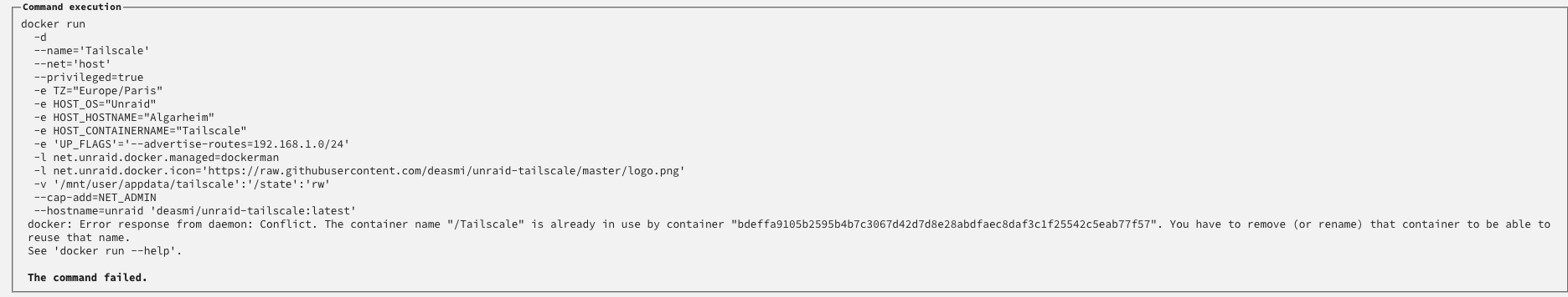

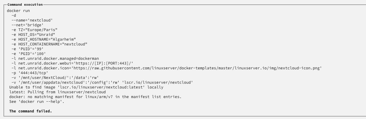

  2. Woke up today and found that many of my dockers had been removed. When trying to reinstall I am getting the following error: No changes done on my side running 6.12.rc6 so any insights would be appreciated. This happens for multiple images. I am also seeing this error:
