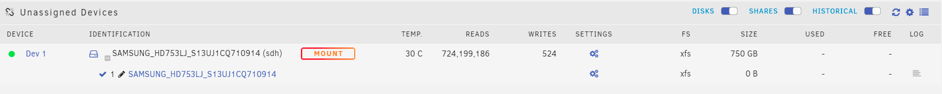

  14. Had an unexpected crash/reboot last night. Now doing a parity check. And realized high read rates on an unassigned and unmounted drive .. is that normal? Amount of reads is similar to the reads on the array .. strange! nasa-diagnostics-20211119-1349.zip
