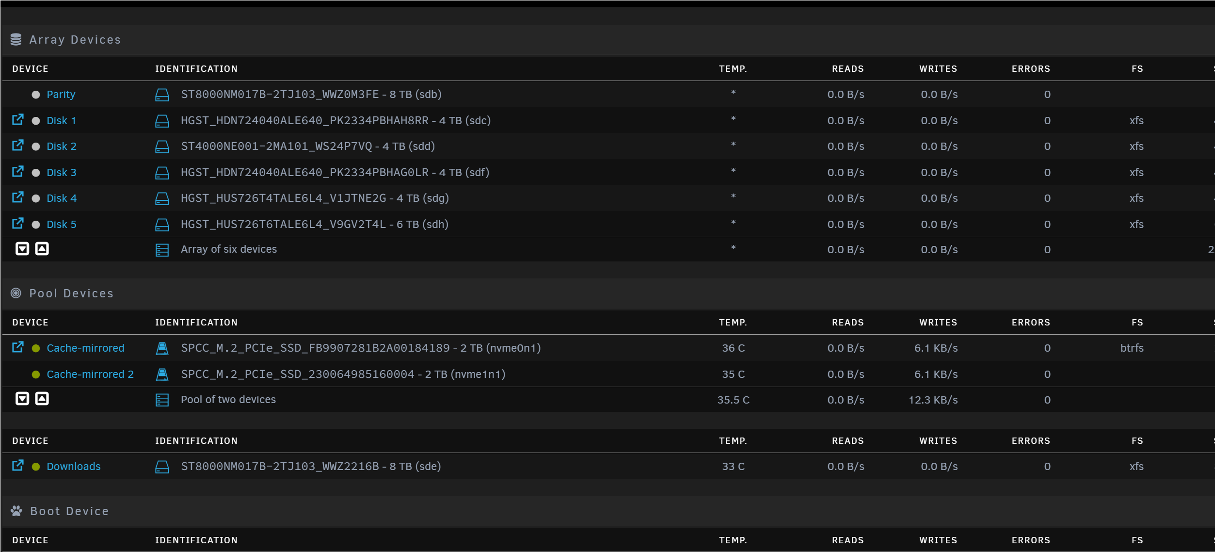

  12. The pool device in question is the sole drive for my Downloads Share
  13. thanks for the speedy replies gentlemen, FYI, My pool device is not part of the array / parity nor is it in a cache pool. Its just a single drive that all the downloads are pointed to and stored (99% torrent related). I seen no other way of adding such a device other than a pool device due to lack of knowledge. Would your methods of replacement be the same as you mentioned above, as I intend to swap these over regularly. @JorgeB - I did try that before editing the .cfg file, but when I selected no device and tried to start the array it would not let me, got and error to many disks missing from pool.
  14. I have my Downloads Share setup as a single Pool Device - 1 x 8t hdd formatted in XFS I Clone this device with an identical drive which is stored in an offline location. I now have a situation where I need to swap over the drives so I have followed the official tutorial for such a process, 1 - shutdown the system 2 - swap over the drives and boot the system 3 - Open up the main tab an allocated the new disk to the pool Step 3 is where I get stuck as I cannot allocate the new drive as its looking for the serial of the old drive. To overcome this I shut down the system, removed the flash drive and updated the pool.cfg which in my case is Download.cfg file to suit the new device and booted the system. This worked flawlessly, I have check my download client and rechecked a few torrent without issues everything seem totally fine. And that's what worries me most - will this method come back to bite me in the arse? Was there something I missed?

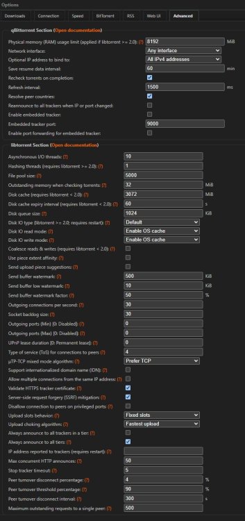

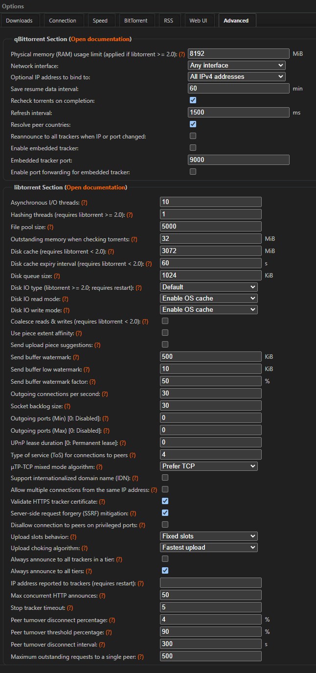

  16. @binhex I will test the above and report back, fingers crossed that will work as I intend, might help others out in the future. While I have your valued attention, regarding my original post below did that 2nd error mean anything to you? I'm getting about 650 reports in a 12hour period. Googling points to external client issue. Lastly my "advanced" qBit settings, Sadly I have NO idea what to tweak or adjust based on my system, is there anything you would advise changing? I understand if that's to much to ask maybe I should be asking elsewhere but worth a shot.
  17. My setup is different as my Downloads share is setup as a separate pool device for various reason. (see photo) Sadly this prevents me from using Cache Pool and Mover. But you've got me thinking......Dangerous! Maybe I can utilise qBits "keep incomplete torrent in" option and point that Temp folder to qBits AppData folder which is permanently on the cache and once download is finished its auto moved by qBit to "default save location" My only worry would be I have "run external Program" utilised which would be vital that the files are indeed in the "default save". I wonder is qBits trigger for "download Finished" before or after that auto move is fully complete.

  19. Been having 2 Performance warning alerts with qBittorrent that no matter what I change in advanced setting will not resolve. I have googled endlessly but to no avail. The 1st warning appears randomly on any torrent with no clear cause of event is; “Performance alert: [Redacted] : performance warning: the disk queue limit is too high compared to the cache size. The disk queue eats into the cache size.” The 2nd warning appears in batches of 30 or 40 warnings in 1-to-2-hour period, again random torrents with no clear cause of event; “Performance alert: [Redacted] : performance warning: max outstanding piece requests reached.” My system is 11700k with 32GIB of DDR4 ram 2666mhz – With everything running 10 x Dockers, Active “parity check”, multiple torrents downloading, Jellyfin active and transcoding etc I never seen anything over 30% usage on the total ram so I have set qBittorrent to utilise 8gb of ram in advanced settings to the below screenshot. EDIT: All downloads are on a single pool device - 1 x 8TB Seagate Exos 7E10 3.5" Please if anyone has any advice or suggestions it would be greatly appreciated.
