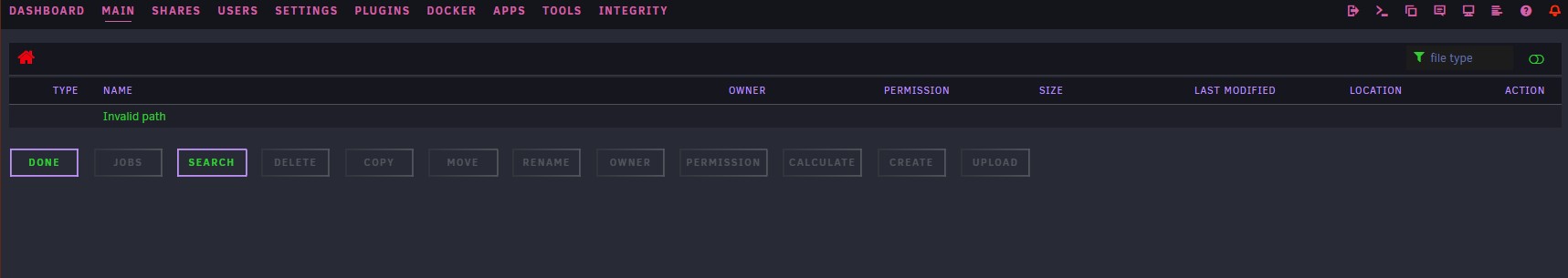

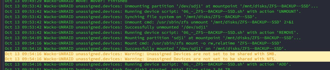

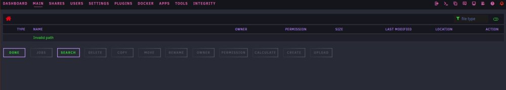

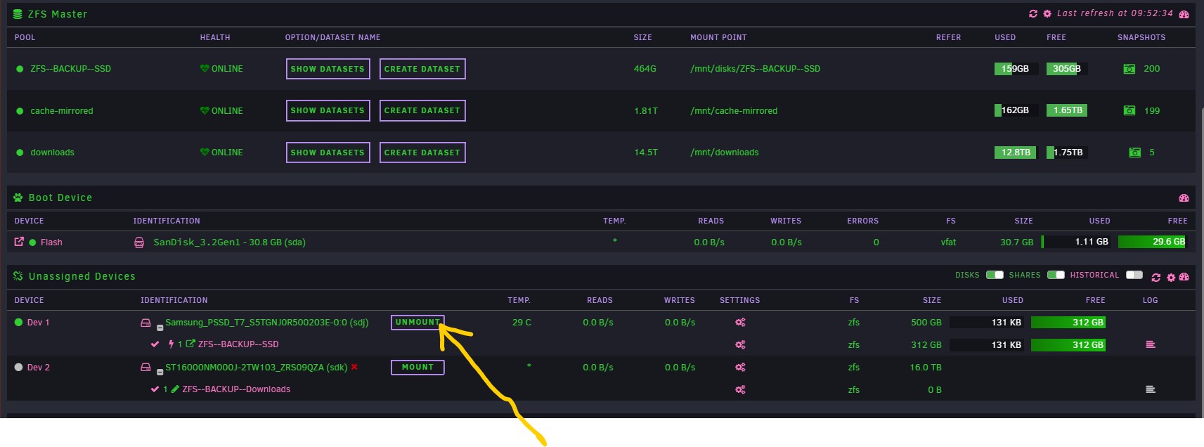

I guess the easiest way to explain is via screenshots. The mounted device below in UD is the offline ZFS backup ssd for my cache pool, which I mount periodical for ZFS replication. Once I attempt to view the contents of ZFS--BACKUP--SSD as per the screen grab below OR via UD "browse disk share" I get "invalid path" as per screenshot below If i run the "zfs mount -a" command, I can view all the contents in the datasets as per normal. Below is a screengrab of the syslog when ZFS--BACKUP--SSD is unmounted and then mounted.

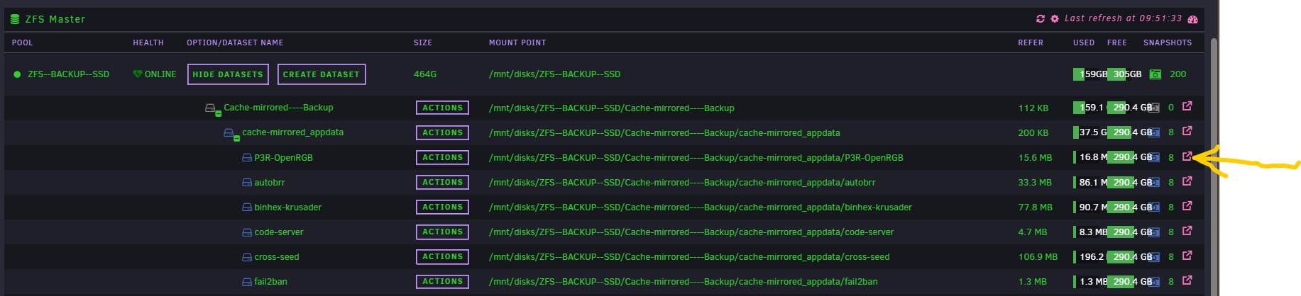

Ok, I worked this 1 out and its definitely my lack of knowledge....again๐ Basically i was trying to clone to another ZFS pool on a spersarate drive, once I cloned to "pool_name/" on which the snapshot is actually stored on, it cloned just fine.

having an issue when trying to clone a snapshot, i get an error "operation not permitted", I suspect its my lack of knowledge on how to clone successfully. When i select "clone" I input "pool_name/test" for the destination dataset. Do I need to create "test" dataset prior?
Ok, maybe its my use case is the issue here. I have an offline ZFS drive I use for replication of my ZFS cache pool, up until now (zfs mount -a) I have not been able to view my contents on the offline drive after being mounted via UD. I can see it space used and the snapshots but not the contents, I get "Invalid Path" error, which makes total sense now that I know the ZFS pools are mounted during Unraid boot sequence. Should this not be the case?
"zfs mount -a" wow this has answered so much confusion as to why I cant view any of my UD mounted zfs drive contents! Thankyou I look forward to the official solution.
