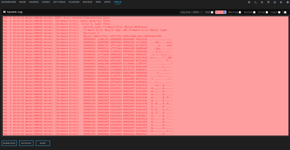

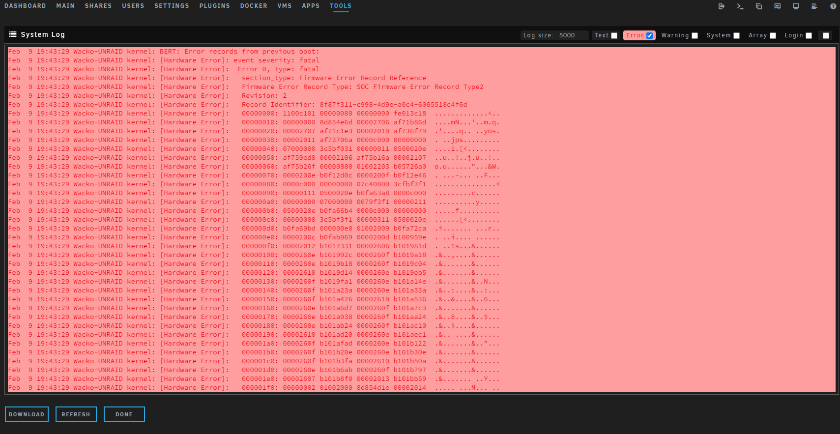

Hardware Error
Just started getting this error in the logs within the last 48 to 72hrs, I know this as I'm regularly checking the logs for errors after rebooting while testing out syslinux edits and the likes for VMs that are not working. I'm on the latest stable firmware 6.11.5 I've attached my diagnostics logs which indeed have the error recorded, Should I be worried about these errors as I'm not having any stability issues etc. Also i did reply to a thread on pre-release that had the exact same issue but I've released this is now related to Stable releases see here: wacko-unraid-diagnostics-20230209-2102.zip

LibreELEC VM - No HDMI Audio option for Intel iGPU
Sadly no change mate still no HDMI options, normally after reboot I like to check system logs for any errors and found these, is that related to the syslinux code?
