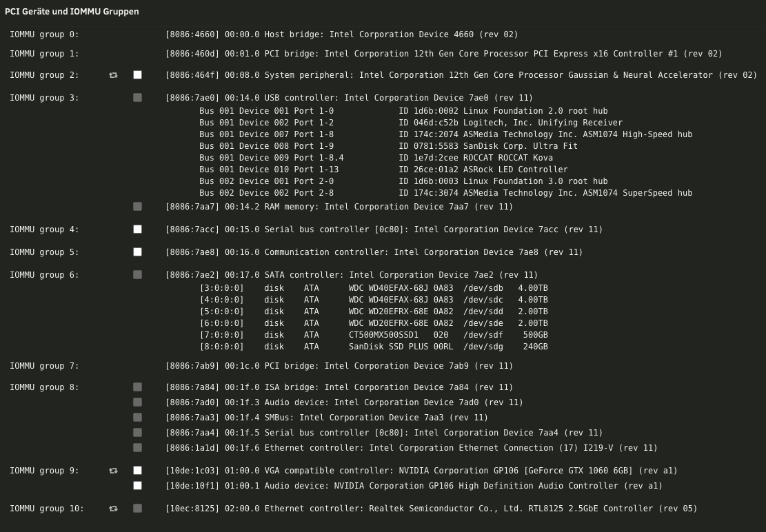

Here are the IOMMU Groups: I am trying to get "Audio device: Intel Corporation Device 7ad0" isolated... but no success so far. Tried it with vfio-pci.ids, also with pcie_acs_override=downstream, multi. Do you guys have any ideas? Other things are working fine - also managed to do a GPU Paththrough to Windows10 VM. Some more news: Also both NICS are working - as I only have 1GB Network, both are running of course on 1GB... but both are working.
