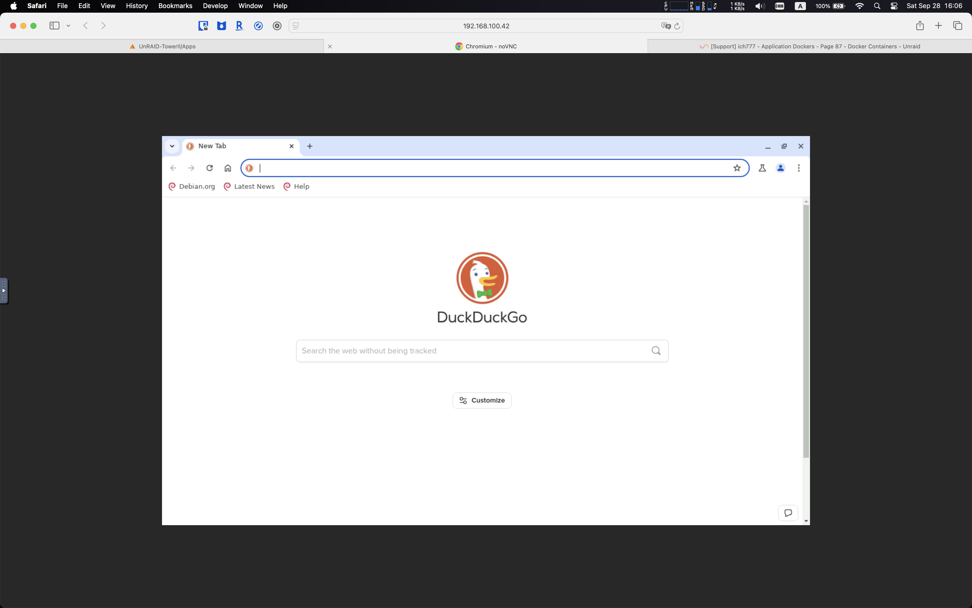

  2. Hi @ich777 thank you for bringing Chromium to docker container. May I know how to change the VNC webGUI size? I only have page in the centre screen. Thank you, Wes
