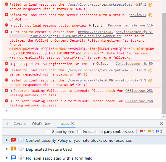

  22. Is there anyone who is successfully using collabora code in a docker? I am on Nextcloud hub 6 (27.0.1) and latest Collabora Code docker. All my dockers are in br0, with IPs on the same subnet. I am using NGINX Proxy Manager. I have created proxy host for nextcloud.* that points to my nextcloud. I have created the same for office.* that points to https://IP_OF_COLLABORA:DOCKER port 9980 with websockets enabled, and even with some additional config I found on some sites: # static files location ^~ /browser { proxy_pass $forward_scheme://$server:$port; proxy_set_header Host $http_host; } # WOPI discovery URL location ^~ /hosting/discovery { proxy_pass $forward_scheme://$server:$port; proxy_set_header Host $http_host; } # main websocket location ~ ^/cool/(.*)/ws$ { proxy_set_header Upgrade $http_upgrade; proxy_set_header Connection "upgrade"; proxy_http_version 1.1; proxy_pass $forward_scheme://$server:$port; proxy_set_header Host $http_host; proxy_read_timeout 36000s; } # download, presentation and image upload location ~ ^/cool { proxy_pass $forward_scheme://$server:$port; proxy_set_header Host $http_host; } # Admin Console websocket location ^~ /cool/adminws { proxy_set_header Upgrade $http_upgrade; proxy_set_header Connection "upgrade"; proxy_http_version 1.1; proxy_pass $forward_scheme://$server:$port; proxy_set_header Host $http_host; proxy_read_timeout 36000s; } My dockers can talk to each other, and I pointed nextcloud to use https://office.* (without port, as port is handled by NPM) and nextcloud can connect to the collabora server. However when I create document and try to open it, it fails after maybe 10 seconds with: Honestly, I am not even sure which logs matter at this point. Here is latest what I see in collabora docker: wsd-00001-00047 2023-09-20 22:00:10.390097 +0200 [ docbroker_002 ] ERR loading document exception: WOPI::CheckFileInfo failed: | wsd/DocumentBroker.cpp:2610 wsd-00001-00047 2023-09-20 22:00:10.390111 +0200 [ docbroker_002 ] ERR Failed to add session to [https%3A%2F%2Fnextcloud.*%3A443%2Findex.php%2Fapps%2Frichdocuments%2Fwopi%2Ffiles%2F871848_instanceid] with URI [https://nextcloud.*/index.php/apps/richdocuments/wopi/files/871848_instanceid?access_token=Q8BemIu9osHPNyQCq3ikA4xFXTQKncL7&access_token_ttl=0&permission=edit]: WOPI::CheckFileInfo failed: | wsd/DocumentBroker.cpp:2572 wsd-00001-00047 2023-09-20 22:00:10.390120 +0200 [ docbroker_002 ] ERR Storage error while starting session on https%3A%2F%2Fnextcloud.*%3A443%2Findex.php%2Fapps%2Frichdocuments%2Fwopi%2Ffiles%2F871848_instanceid for socket #18. Terminating connection. Error: WOPI::CheckFileInfo failed: | wsd/COOLWSD.cpp:5052 wsd-00001-00047 2023-09-20 22:00:10.394410 +0200 [ docbroker_002 ] ERR #24: Read failed, have 0 buffered bytes (ECONNRESET: Connection reset by peer)| net/Socket.hpp:1122 wsd-00001-00047 2023-09-20 22:00:10.394428 +0200 [ docbroker_002 ] WRN #24: Unassociated Kit (46) disconnected unexpectedly| wsd/COOLWSD.cpp:3491 frk-00038-00038 2023-09-20 22:00:10.404696 +0200 [ forkit ] WRN The systemplate directory [/opt/cool/systemplate] is read-only, and at least [/opt/cool/systemplate//etc/hosts] is out-of-date. Will have to copy sysTemplate to jails. To restore optimal performance, make sure the files in [/opt/cool/systemplate/etc] are up-to-date.| common/JailUtil.cpp:524 sh: 1: /usr/bin/coolmount: Operation not permitted sh: 1: /usr/bin/coolmount: Operation not permitted sh: 1: /usr/bin/coolmount: Operation not permitted wsd-00001-00055 2023-09-20 22:00:10.563226 +0200 [ docbroker_003 ] WRN #29: Failed to verify the certificate of [nextcloud.*]| net/SslSocket.hpp:252 wsd-00001-00055 2023-09-20 22:00:10.563294 +0200 [ docbroker_003 ] ERR WOPI::CheckFileInfo failed for URI [https://nextcloud.*/index.php/apps/richdocuments/wopi/files/871848_instanceid?access_token=Q8BemIu9osHPNyQCq3ikA4xFXTQKncL7&access_token_ttl=0&permission=edit]: 0 (Unknown) . Headers: Body: []| wsd/Storage.cpp:708 wsd-00001-00055 2023-09-20 22:00:10.563320 +0200 [ docbroker_003 ] ERR loading document exception: WOPI::CheckFileInfo failed: | wsd/DocumentBroker.cpp:2610 wsd-00001-00055 2023-09-20 22:00:10.563327 +0200 [ docbroker_003 ] ERR Failed to add session to [https%3A%2F%2Fnextcloud.*%3A443%2Findex.php%2Fapps%2Frichdocuments%2Fwopi%2Ffiles%2F871848_instanceid] with URI [https://nextcloud.*/index.php/apps/richdocuments/wopi/files/871848_instanceid?access_token=Q8BemIu9osHPNyQCq3ikA4xFXTQKncL7&access_token_ttl=0&permission=edit]: WOPI::CheckFileInfo failed: | wsd/DocumentBroker.cpp:2572 wsd-00001-00055 2023-09-20 22:00:10.563333 +0200 [ docbroker_003 ] ERR Storage error while starting session on https%3A%2F%2Fnextcloud.*%3A443%2Findex.php%2Fapps%2Frichdocuments%2Fwopi%2Ffiles%2F871848_instanceid for socket #24. Terminating connection. Error: WOPI::CheckFileInfo failed: | wsd/COOLWSD.cpp:5052 wsd-00001-00055 2023-09-20 22:00:10.567161 +0200 [ docbroker_003 ] ERR #18: Read failed, have 0 buffered bytes (ECONNRESET: Connection reset by peer)| net/Socket.hpp:1122 wsd-00001-00055 2023-09-20 22:00:10.567170 +0200 [ docbroker_003 ] WRN #18: Unassociated Kit (54) disconnected unexpectedly| wsd/COOLWSD.cpp:3491 frk-00038-00038 2023-09-20 22:00:10.576432 +0200 [ forkit ] WRN The systemplate directory [/opt/cool/systemplate] is read-only, and at least [/opt/cool/systemplate//etc/hosts] is out-of-date. Will have to copy sysTemplate to jails. To restore optimal performance, make sure the files in [/opt/cool/systemplate/etc] are up-to-date.| common/JailUtil.cpp:524 sh: 1: /usr/bin/coolmount: Operation not permitted sh: 1: /usr/bin/coolmount: Operation not permitted sh: 1: /usr/bin/coolmount: Operation not permitted When I open developer console in Chrome, I am getting this: Can anyone advise? // edit I was able to resolve my issue. Spaceinvader's video pointed me in the right direction. I use pihole and internally, for nextcloud.* I resolve local IP of my reverse proxy. Same for collabora (office.*). In nextcloud's docker, I use extra parameter to use pihole proxy (by default, servers on my server segment don't get pihole proxy) and that allows nextcloud to resolve locally collabora's IP. Since Spaceinvader mentioned that both collabora and nextcloud need to be able to resolve each other, I tried to add the same extra parameter to collabora's docker. Otherwise, if collabora was to resolve it, it would resolve public IP. And voila - it works now.
