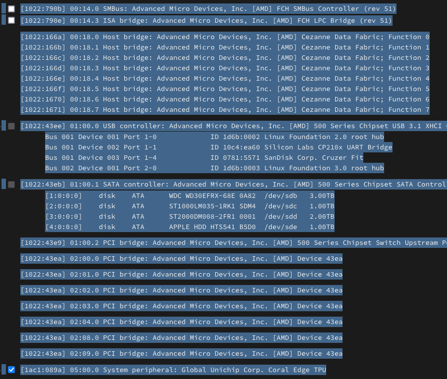

  1. thanks for reply Yes drivers are found . I think that thet the Frigate addon may be at faullt as it has to rbe reactivated when you click on it.
  2. Sorry i missed your reply, where would i write this file to ? I am assuming that the details are 0880:0089a,1ac1:089a ?? Version 6.12.10 installed now I checked the libvirt_helpers.php file it has been white listed : $arrBlacklistClassIDregex = '/^(05|06|08|0a|0b|0c05)/'; // Got Class IDs at the bottom of /usr/share/hwdata/pci.ids $arrWhitelistGPUClassIDregex = '/^(0001|03)/'; $arrWhitelistAudioClassIDregex = '/^(0403)/'; # "System peripheral [0880]" "Global unichip corp. [1ac1]" "Coral Edge Tpu [089a]" -pff "Global unichip corp. [1a> # typeid > # file is csv typeid:productid # if (is_file("/boot/config/VMPCIOverride.cfg")) { $arrWhiteListOverride = str_getcsv(file_get_contents("/boot/config/VMPCIOverride.cfg")) ; } $arrWhiteListOverride[] = "0880:089a" ;

  5. I have a m2 pcie coral card which has been working fine for over 2 years. I reinstalled Frigate due to so many errors ffmpeg. The Coral is detected in unRaid . So i had to bind the pcie card so it can be seen in HA to work. Now the Coral drivers cannot find it. So i am not sure is it is faulty or not.
  6. My first issue was i couldn't pass-thru my pci to show up in HA vm. as the pci card was not showing up as avaiable in the VM even though it was on unraid. So i used pci acs override option as mentioned and bonded the Coral to HA as below. immou no is the bridge for the Coral Do i tick these to be bonded to coral ? I have Coral drivers in stalled but they too cannot find the Coral. Any ideas on where i am going wrong? I had it all work upto recently without have to bond the pci ? Your help is accpreciated.

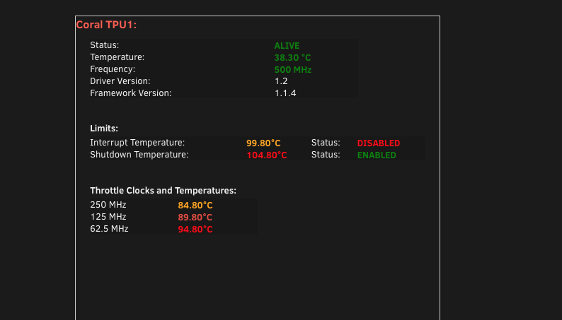

  7. I am still have problems with the TPU. It is found by unraid and HA app and bond. Howerver now it is not found by the Coral drivers any ideaa Logs showing error in container
  8. Hi Finally have Coral TPU bonded.,but still have the follwoing errors i have included details of the installation. Any idea where i an going wrong ? Logs showing error in container

  10. Hi i changed the Pcie acs to Both and it worked so i wrongly changed it back to disabled due to the error message that it shoud be set to disabled. Now i cannot get back into unraid after the reboot as there is an error message on booting unraid regardon etho. Not surew hat i have done wrong. I get unraid running again can i leave pcie acs running ?
  11. Hope that this helps i appreciate your time. I did notice that you were dealing with a similar siatutaion back in september 2023?
  12. Sorry please advise what information do you require? I have an issue with Coral TPU no being found in HA after looking a the logs Frigate Logs .Previously it was ok without having to pass-through. I found this thread which prompted me to follow the solution. I removed /08 and save check to see if it was save and saw that /08 was added to the whitelist. Went to HA to changed the template the Coral TPU was found so that i can add the PCIE. The Coral TPU is greyed out there for it being used by unraid . Hope this helps?
  13. I have followed K Niesten solution works as Coral TPU is now on the white list see below: $arrBlacklistClassIDregex = '/^(05|06|0a|0b|0c05)/'; // Got Class IDs at the bottom of /usr/share/hwdata/pci.ids $arrWhitelistGPUClassIDregex = '/^(0001|03)/'; $arrWhitelistAudioClassIDregex = '/^(0403)/'; # "System peripheral [0880]" "Global unichip corp. [1ac1]" "Coral Edge Tpu [089a]" -pff "Global unichip corp. [1a> # typeid > # file is csv typeid:productid # if (is_file("/boot/config/VMPCIOverride.cfg")) { $arrWhiteListOverride = str_getcsv(file_get_contents("/boot/config/VMPCIOverride.cfg")) ; } $arrWhiteListOverride[] = "0880:089a" ; However, the Coral TPU does not appear on the template to edit. Is there something that i am missing ?? Any advicse would be appreciated.

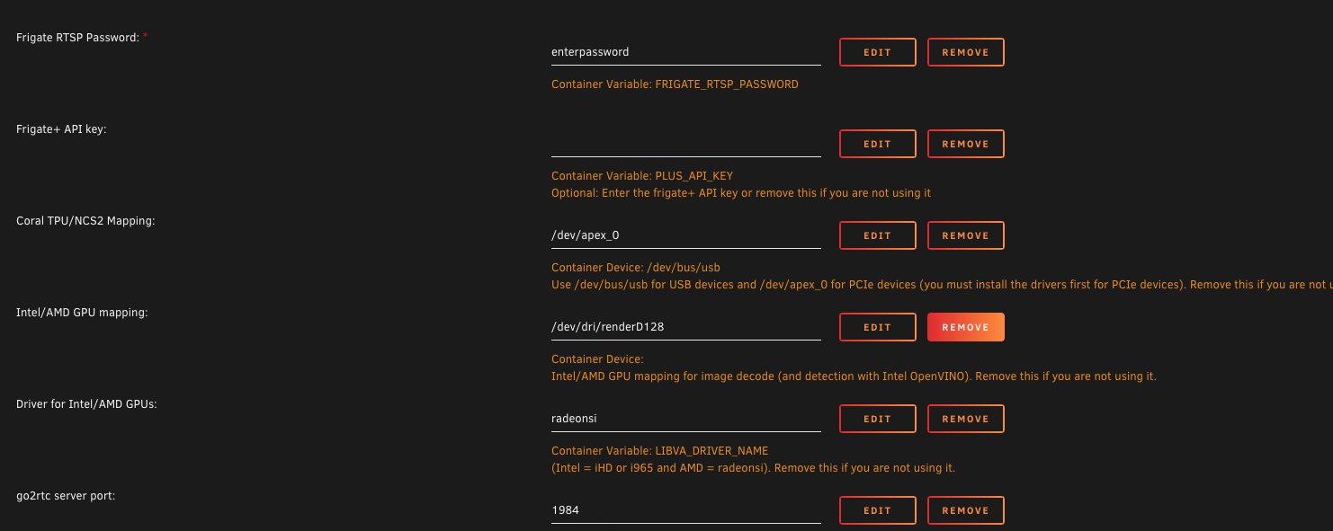

  18. I have 4 cameras a reolink and 3 Tapo RTSP , The Reolink is displayed in HA overview however the 1 tapo isn't . all cameras are viewable VLC . the ffmeg block , do you add this before go2RTC ? In the errors I do not understand how to rectify the issue to get Frigate working? Any advice ? config error.15.06.24 config.yml
  19. I aming have problem starting Frigate NV after installing Tapo cameras. The streams work on VLC , however when i add a rtsp i receive errors in config.yml. Could some advise where the error is in config. please see logs and current logs; config.ymlconfig.yml_frigate_logs (1).txt.crdownload Any help would be appreciated as i have looking for days and i must be missing something.
