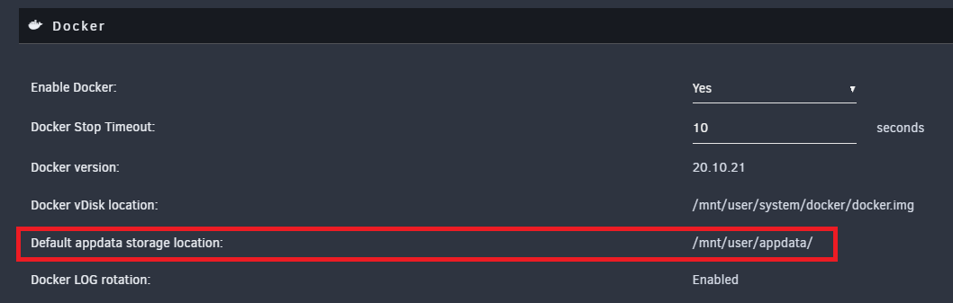

  2. It works for me! Tks ------------x----------- Should I change the path from mnt/user > mnt/cache inside each container or directly in docker settings?
