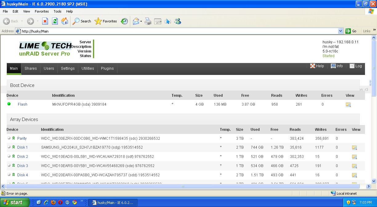

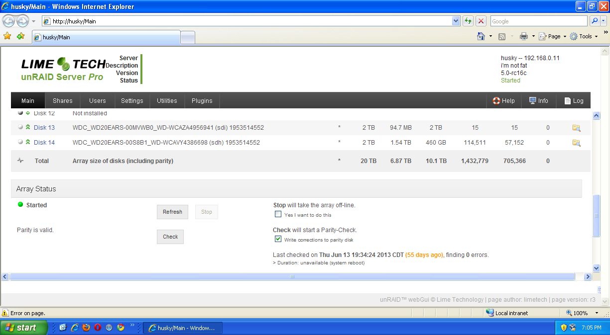

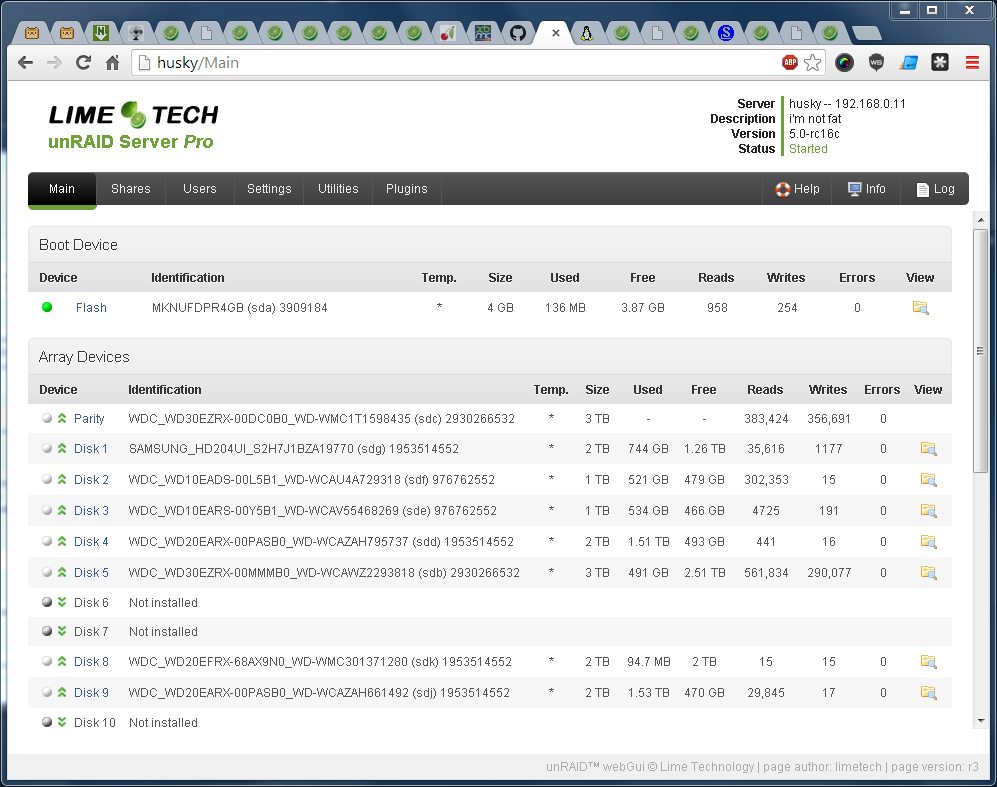

  14. the new ui in ie6 or 7.. somewhat useable but some useability issues for sure (lack of png support/float issues/unsupported css used). not that we should really support it.. since WinXP users can run IE8. Win7 users would be running IE9-10. But just in case you were curious what it looks like:
  15. @husky:/boot/config/plugins/webGui# cat webGui.* | grep devices devices="0" devices="0" however its still showing listing unassigned devices...
  16. most mobile browsers nowdays are more than capable of displaying a webpage correctly.. there doesnt appear to be any non friendly stuff used.. (like dropdown menus on hover). so your mobile device should be fine. you may just have to zoom in to have a decent touch target... but yes one could easily add css3's media queries to make the design responsive for the device being used (tablet/mobile/desktop). this could have been done as well with the previous stock ui..

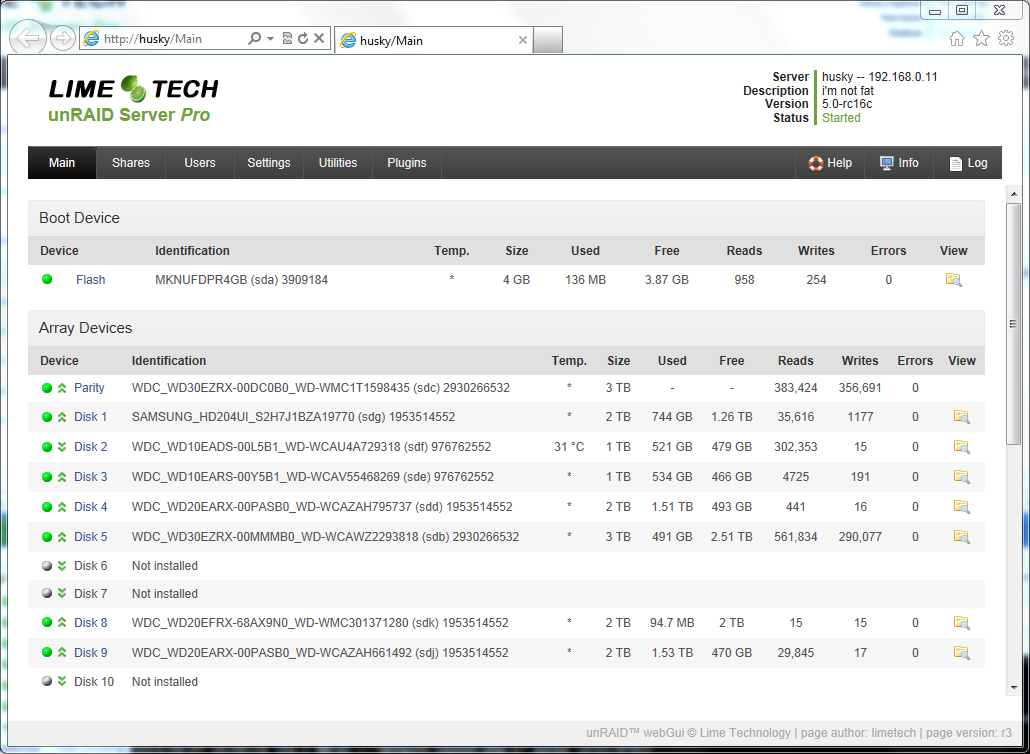

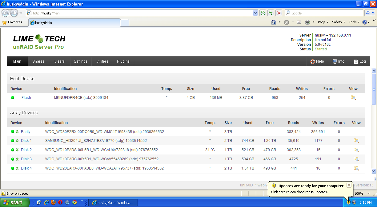

  17. In case those were wondering.. I have a vm where I run the legacy browsers for testing.. (IE6 & 7 via IE Collection) but natively it has IE8, Firefox 3.6.28, Opera 10.54, Safari 4.0.5, Chrome 5. Tom, any chance getting the forum max total size raised? Having a max size of 192kb then a max total size of 192kb.. means to attach screenshots of before + after changes.. I'd have to use heavy compression or multiple posts. For giggles here is what IE9 shows for stock r3 (notice it also is in computability mode):

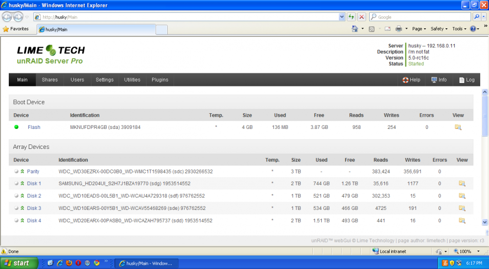

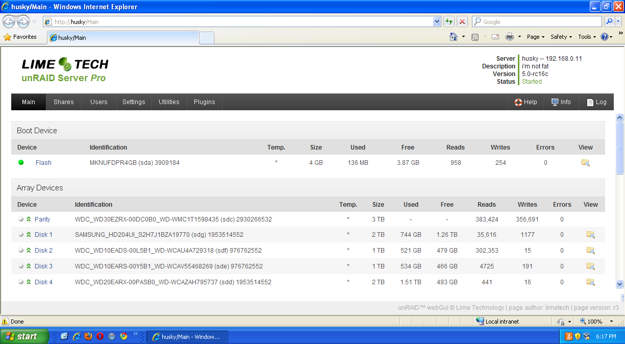

  18. just submitted pull. https://github.com/limetech/webGui/pull/1 its going to be very subtle changes if you see any. ideally this gen browsers wont see much changes since a lot of them agree on things.. but the legacy browsers should all be normalized for the most part. also this fixes ie8's broken compatibility mode being used. screen shot attached (notice by the refresh button there is the 'compatibility' icon on the stock r3 and its no longer there after my code changes)
