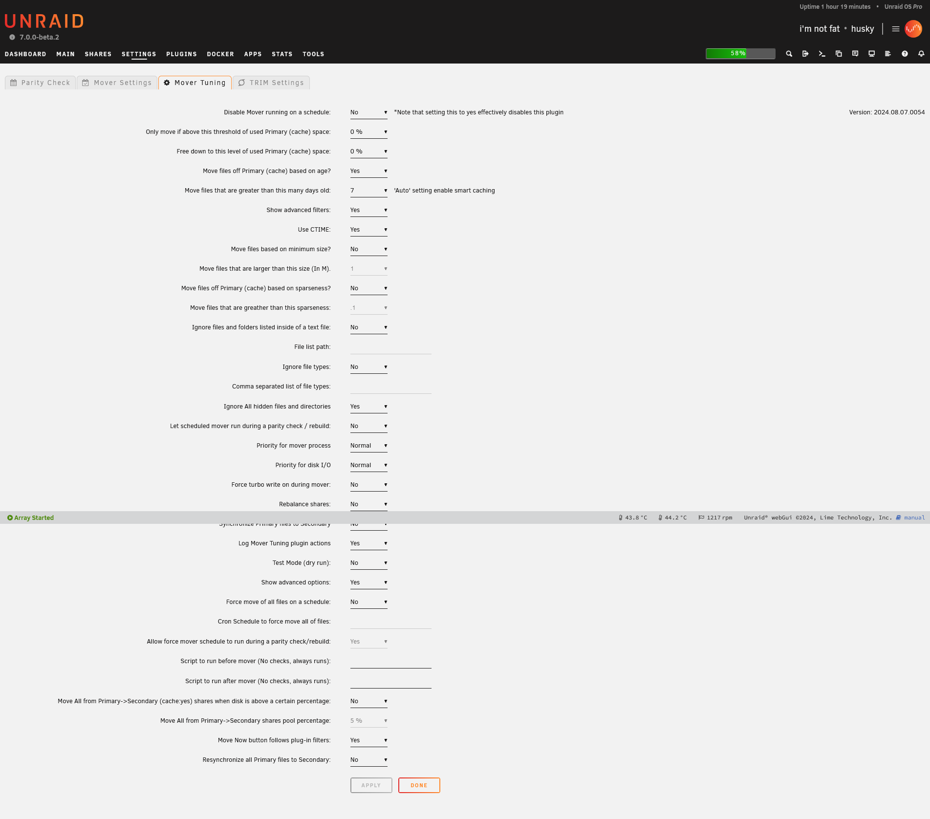

  12. It was not, I had given up on your plugin and went back to hugenbdd/original version and did the symlink and its working fine.. so at some point I'm sure I'll try it out again but at this point it didn't seem like it was ready with all the active development and bugs.

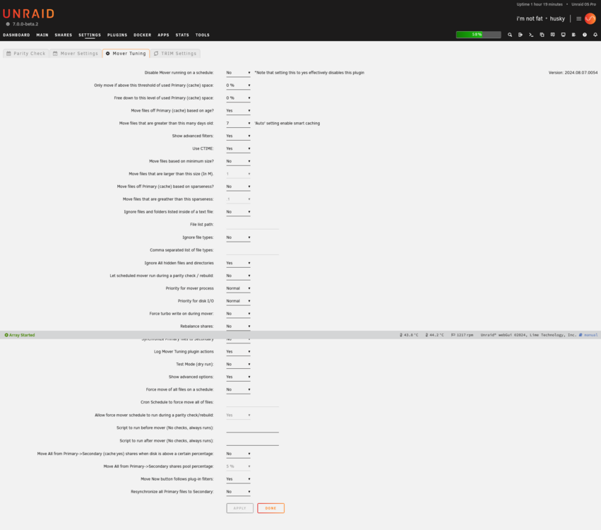

  13. updating to the latest version, it resolves the fatal error but does not move anything... to comment you are showing: Info: you may optionally install 'bc' from 'NerdTools' to have more precise size value IMHO: this should not be mentioned in logs, as nerdtools is not really recommended for unraid 7.x nor alive anymore. if you think bc should be included, just included with the plugin... or offer up an option to enable more precise sizes and blip on there about telling the user to go install bc. Then, your plugin has "Test Mode (dry run):" defaulting to yes.. and as this is buried middle way down in the options it makes it easy to miss (!it got me). I'd recommend moving this to the very top (or bottom like old plugin) or something for better visibility.
