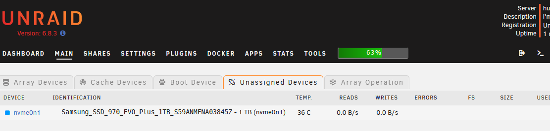

I'm wanting to remove UD so I can test out 6.9 RC1. I'm on 6.8.3, I removed UD + UD Extra. Restarted unraid. I confirmed no install on the startup but I still have the "Unassigned Disk" tab on the main unraid page. Can see below, it shows the tab and a drive but cant really do much with it.. I wold have expected the tab to not be there anymore?
