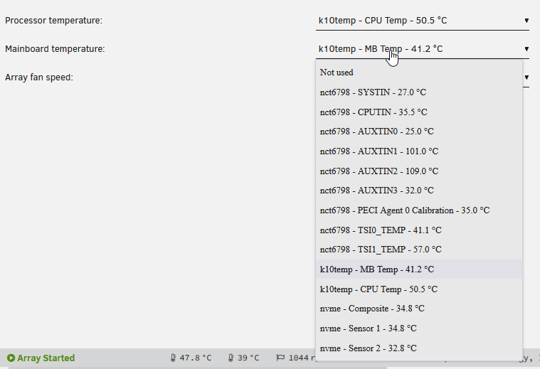

Tempted to get that board myself. Do you have cpu/motherboard temps working?
loaded up perl and Dynamix System Temp, it detected "k10temp nct6775" but not showing any temp probes. Looking around it looks like ryzen 3000 requires newer kernel than what comes with 6.8.3 to get stuff to detect properly. I do not want to run 6.9.x betas..  so I'll come back to this once I can test with my backup unraid flash and no drives connected.
Edited by zoggy
loaded up 6.9 rc1, can confirm I get temps now, no fans though
doing sensors-detect then loading what it suggest, I can see:
# sensors
k10temp-pci-00c3
Adapter: PCI adapter
Vcore:       913.00 mV
Vsoc:          1.09 V
Tctl:         +39.8°C
CPU Temp:     +39.8°C
MB Temp:      +32.8°C
Icore:         0.00 A
Isoc:          7.50 A
nvme-pci-0300
Composite:    +31.9°C  (low  = -273.1°C, high = +84.8°C)
                       (crit = +84.8°C)
Sensor 1:     +31.9°C  (low  = -273.1°C, high = +65261.8°C)
Sensor 2:     +35.9°C  (low  = -273.1°C, high = +65261.8°C)
*update* - now on 6.9.2 I can say things are more or less the same, I suspect that 6.10.x should improve things however:
about asus and the buggy issues with reading fan/temps:
https://bugzilla.kernel.org/show_bug.cgi?id=204807
oct 2021 - lot of asus wmi boards got supported via NCT677x:
https://git.kernel.org/pub/scm/linux/kernel/git/groeck/linux-staging.git/commit/?id=cd0b8e410937
Edited by zoggy
# sensors
k10temp-pci-00c3
Vcore:       913.00 mV
Vsoc:          1.09 V
Tctl:         +39.8°C
CPU Temp:     +39.8°C
MB Temp:      +32.8°C
Icore:         0.00 A
Isoc:          7.50 A
nvme-pci-0300
                       (crit = +84.8°C)
another update, 6.10.x corrected/enabled a lot of the asus sensors but still had no fans.
with unraid 6.11rc3 I can confirm fans are there now as well and all is working well:
**update** updating to 6.11rc4 I can see even more fan/sensors added (asusec).
