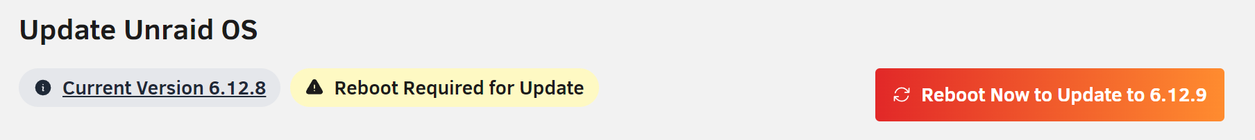

I have version 6.12.9 update pending restart. Do I have to install it to see the 6.12.10 update?
Yes the update process isn't really setup for people to run in "pending restart" mode for an extended period. TBH this could confuse plugins and other things that aren't prepared for this as well, I would not recommend updating the OS until you are ready to restart.
6.12.9 does have an issue with certain Asmedia controllers, if you are at all concerned about that you can go to Settings -> Disk Settings and disable array autostart. Then when it boots into 6.12.9 there will be no problems and you can just run the update to 6.12.10 and reboot into that.
