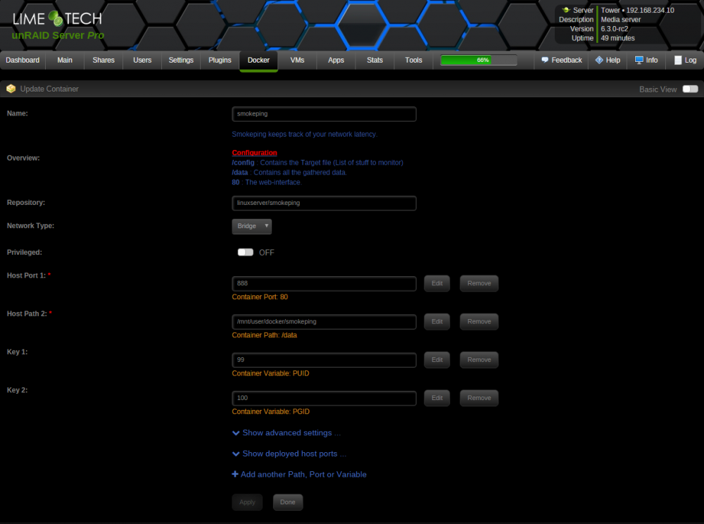

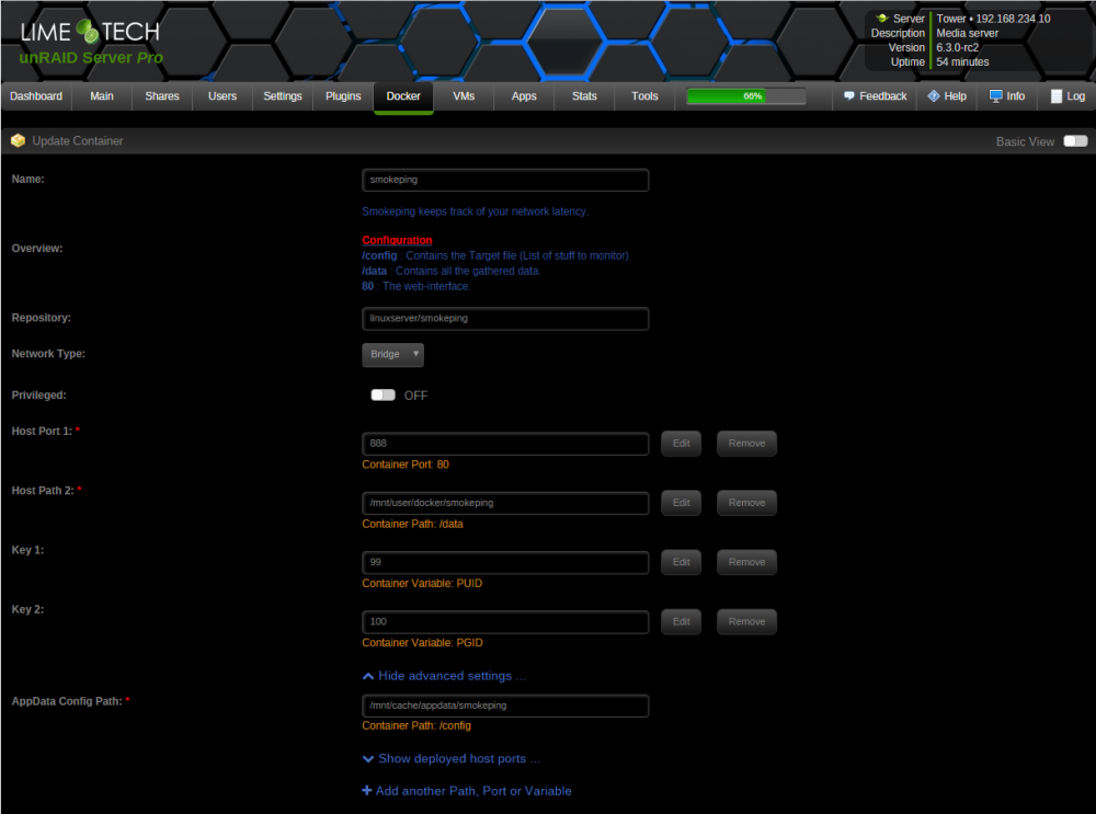

  22. Switch from basic to advanced view.. (top right on page)
