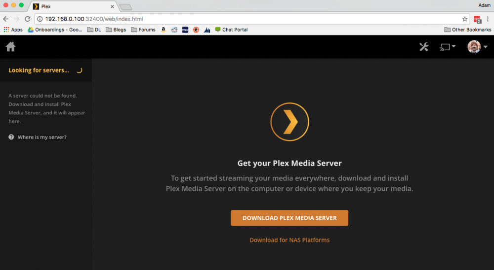

Going home and getting on the wifi absolutely worked. Plex launched and instantly went in to "server mode" or whatever you would call it. Then as I left, I realized that this may have worked if I had tried going to http://mypublicIP:32400/web I just didn't think of that when I was pulling out my hair last night -

Can you post your docker run command? Link in my sigs... Sure it's: root@localhost:# /usr/local/emhttp/plugins/dynamix.docker.manager/scripts/docker run -d --name="plex" --net="host" -e TZ="America/Phoenix" -e HOST_OS="unRAID" -e "PUID"="99" -e "PGID"="100" -e "VERSION"="latest" -v "/mnt/user/TV":"/media/tv":rw -v "/mnt/user/Movies":"/media/movies":rw -v "/mnt/user/appdata/plex":"/config":rw linuxserver/plex f2cbd54fc7457b4527823fcc0293a12c672abbb1c5d69d356ace69684535800b But I suspect reply 411 upthread will resolve my issue. Turns out you can't successfully pull a Plex taken if accessing over VPN. I'm not at home while I'm trying to do this, so here's hoping -

Getting a spinning "Looking for servers" and "Get your Plex Media Server" page upon first and all subsequent logins, no matter how many times I restart the docker container. Also, I don't see a Server tab under Settings. -
