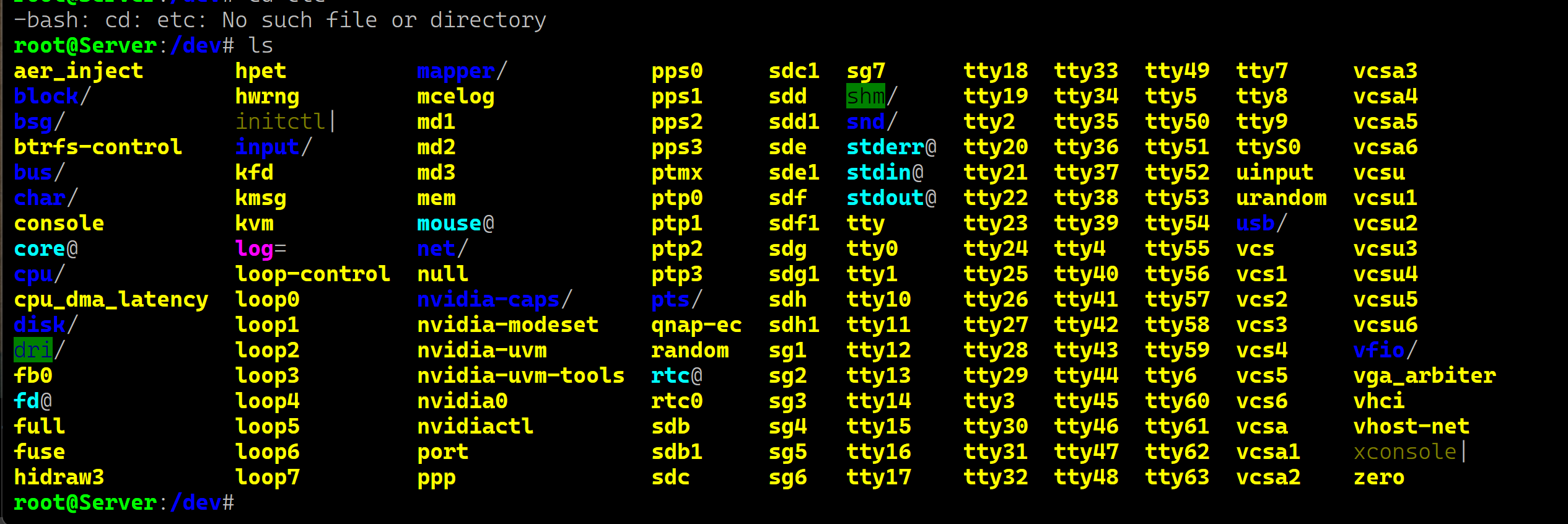

  21. thats with the qnap plugin installed, but the screen is disconnected
