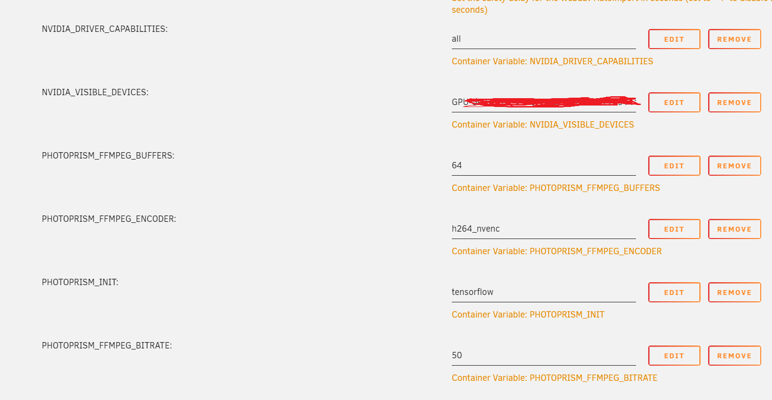

  13. I tried this before my initial post and that didn't work as well. Has anyone else here gotten a GPU to work in photoprism?
  14. Noted. thank you.
  15. Yes, I have ```--runtime=nvidia``` in Photoprism. Jellyfin, Plex, Frigate, etc. all work fine with GPU passthrough. Photoprism does have documentation, but just not documentation surroudning on facial recognition.
  16. Noted, I will look into this more.
  17. 1) Has anyone gotten Photoprism to work with an Nividia GPU? I opened a github case but the Photoprism team kept on saying it's my issue on Unraid WHEN I got the same gpu to work on Jellyfin, Plex, Frigate, etc. The contributors just stopped helping at all. I added all these attributes/variables in Photoprism as well as adding the nvidia runtime command. I could start Photoprism without any issue at all, but the app wasn't using the Gpu for anything. Can someone provide me with some insights? 2) Secondly, has anyone gotten Photoprism's facial recognition with tensorflow to work? Again, I opened a github case and the Photoprism team offered NO help, no documentation, no nothing. They just pointed me to go to their website to look at tensorflow. But, what is the point when it offers no documentation to get it to work?
